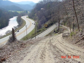

Sorry Guys; sometimes i can be pretty dense; but I have quite a few hills I'd like to figure the degree of slope of (for point of reference). I understand the formula ( i think) but how in the world can i measure the distance up or the distance forward. Is it just a two person opertation holding a tape as steady as you can at some point in the air and measuring forward and down?
/ Best Mountain Tractor? #87
moon..
If you do this, you need a clip on level to ensure your horizontal is level.
So:
Use the same length for horizontal to simplify your calculations...remember the level!! I suggest you use 100". I also suggest you use a straight edge or cut the straightest 2"x4" you can find to a 100" length.
Set your horizontal (level), then measure down (tape measure is fine).
Record the "down" (better expressed as VERTICAL) dimension.
Divide the VERTICAL dimension by the HORIZONTAL dimension. If you're using a CONSTANT HORIZONTAL (as suggested above), this will be easy.
This will be the tangent of the angle. Either look up the angle in the Trig charts (if you have them) or, if you have a scientific calculator, use Inverse tangent. The TANGENT will be the percent slope (remember, the tangent of 45° is 1.00 (or 100%). All tangents > 1 multipled by 100 would give you the slope percent. The INVERSE TANGENT would give you the slope in degrees.
Do this at least 3 places on a slope (try to stay on one path going down the slope), then average that number..better if you do it 5 places..but 3 should give you a good average.
Example:
26" VERTICAL divided by 100" HORIZONTAL = .26
.26 times 100 = 26% slope
INV. TAN of .26 = 14.57° slope.
The easier method would be to buy a gauge designed to measure slopes (angles). These are available (I had one I got thru Sharper Image years ago...but it broke).
I'm sure these would be available at hardware stores. If you use the electronic gauge, I suggest you mount it on a straight edge of at least 72" (6'), and again, check the slope at least 3 places and average those measurements.
Now, I have to thank several folks who squared me away on the definition of percent of slope. That was the hard part...
If any of y'all disagree with the methodology..no prob..but have your math ready.

Moon:
You can use a compass that has a clinometer.
Or two people and a tape 50 ft or so long. Hold the tape level, use a level to determine this and then on the downhill side measure the vertical distance to the ground. This gives you a tangent number from which you can look up an angle in degrees from the tangent tables. From this information you can also covert to % grade with no tables. Your calculator will have all these functions.
Now in days of old this was done with a metal chain,plumb bob, level and thermometer to determine the distance. Then a survryors level was used to determine the elevation change between the two points.
Egon

Egon,
You must be one tall guy.. to hold a 50' tape level on a pitch nearing 20 deg +...
You got the right methodology, though, I do question the thermometer. Was this used for scaling purposes or when tell when it's hot enough to have a beverage? Hill climbin's not easy.
From a carpenter's standpoint you can stand on a 12/12 pitch roof which is 12" horizontal for 12" rise (or 45 degrees slope) and use a hammer (or hold onto a rope to keep from falling off) but this is no place for a tractor.
I can't imagine using any powered vehicle on more than a 6/12 or a 6" rise for 12" horizontal or 22.5 deg other than going straight up or down the slope.
I used to farm in PA and bringing wagons down from the hills loaded with hay weighing 2x the tractor soon learns you the slopes and what works and what doesn't, as I have reloaded a few bales.
Carl NH

Thanks Guys!
Now i just have to wait for the clay/mud to dry up enough to tromp the hills. I have a couple compasses, but don't know what the heck i clinometer is, I'd guess it's that piece that folds over the compass face, and stand verticle when your using it .....but i never knew its name, let alone how to use it. But thats okay, i can handle doing it with a tape and level.
Thanks a bunch guys!

<font color=blue>Now i just have to wait for the clay/mud to dry up enough to tromp the hills. I have a couple compasses, but don't know what the heck i clinometer is, I'd guess it's that piece that folds over the compass face, and stand verticle when your using it .....but i never knew its name, let alone how to use it. But thats okay, i can handle doing it with a tape and level. </font color=blue>
Just remember, doing this will give you an average slope %. It won't take in account any sudden dips, holes,etc...the things that can cause your tractor to roll or lose control.
So, while you're making your measurements, keep an eye open for other potential hazards!
