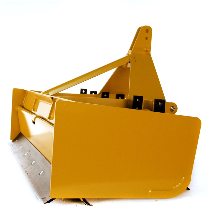

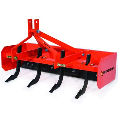

Also consider the style.
Basic:
Floating or Hinged Back

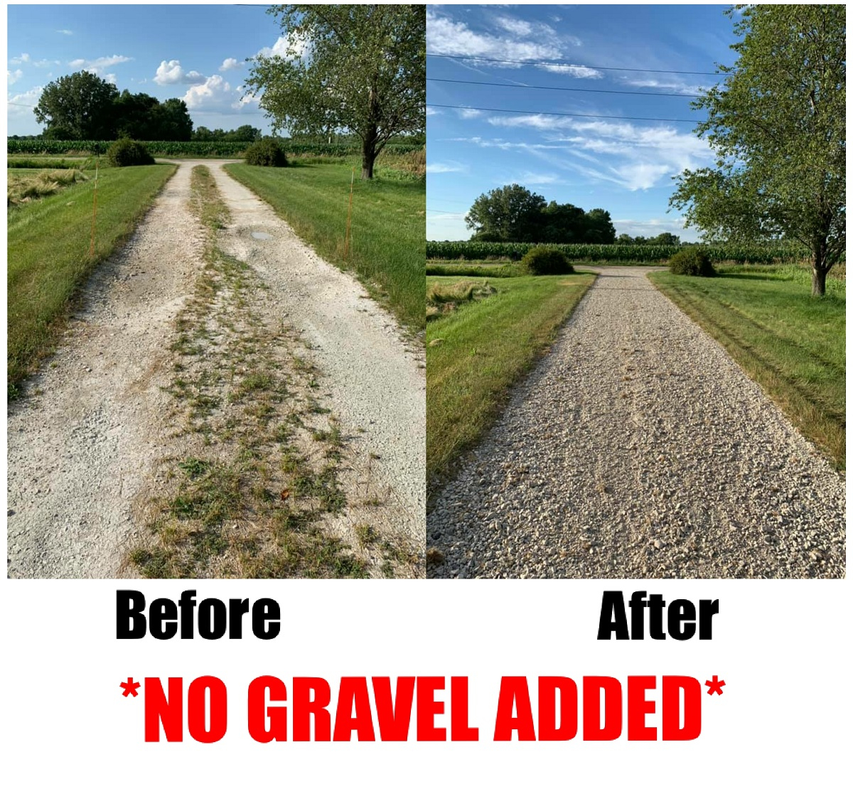

My recommendation is a 72" width Box Blade.
Give careful consideration to a Land Plane. Especially if your road is gravel.
A Land Plane "recovers" gravel. A Box Blade does not.
MORE: box blade vs land plane

I recommend an 84" width land plane.

A lot of people touting the virtues of a land plane never learned to use a Gannon or Box Scraper. The land plane is a one trick pony. The Gannon box scraper is the most versatile attachment you can put on a utility tractor. I own a 72" Gannon for my MX5200 and a 84" Land plane. The landplane excels at weed abatement because it can shear off the weeds and leave the weeds and earth behind.
