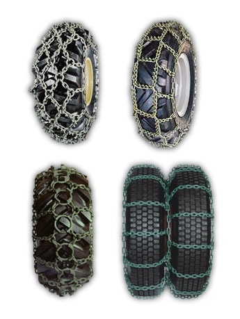

Best value for my money was with tractor tire chains for farm tractors
aka tirechains.com
I went with the DuoGrip style - best match for my needs. Helps keep the chains out of the valleys when running deep lug tires. Adding Vbars would have made for more aggressive bite, but I left them off for the bit of pavement use they see.
Pics at the above link and what the other poster linked should help you understand the chain styles.
IMO, some key questions:
1) Flat land or hill use ?
2) How much glare ice do you get ?
3) Rear chains only, or are you doing all 4 ?
3) Do you have pavement or concrete ? If so, what level of surface scratching/gouging can you live with ?
Answering most/all of those should nudge you in the right direction.
Rgds, D.

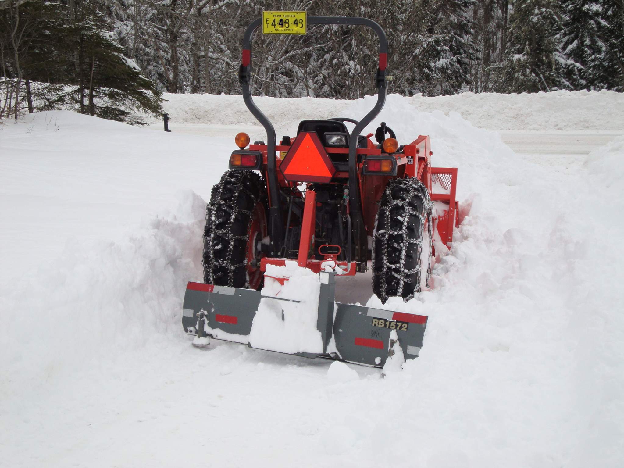

I don't think there's much better than the Talon's for logging, but the $$$ is tough to swallow. For snow plowing, on my rear tires I went with the Duo's from Tirechains.com. They work great for plowing and have a good price point. HOWEVER, if doing much work where a slide could lead to a roll-over, then the $1200 for Talons might start to seem "not so bad".
I was working yesterday at the edge of an embankment which was partially created with fill. I knew what was fill and what was "solid" since I did the work, but at one point one of the rears sank several inches, and simultaneously moved a tiny bit toward the lip, maybe 2 inches. WOW, talk about "pucker factor". In reality this wasn't even close to a roll-over, but it got my attention. And an additional point: the tractor would probably have hit our house if it rolled from that position. So not only could I be seriously injured and tractor damaged, but my wife would be pissed. Yikes.

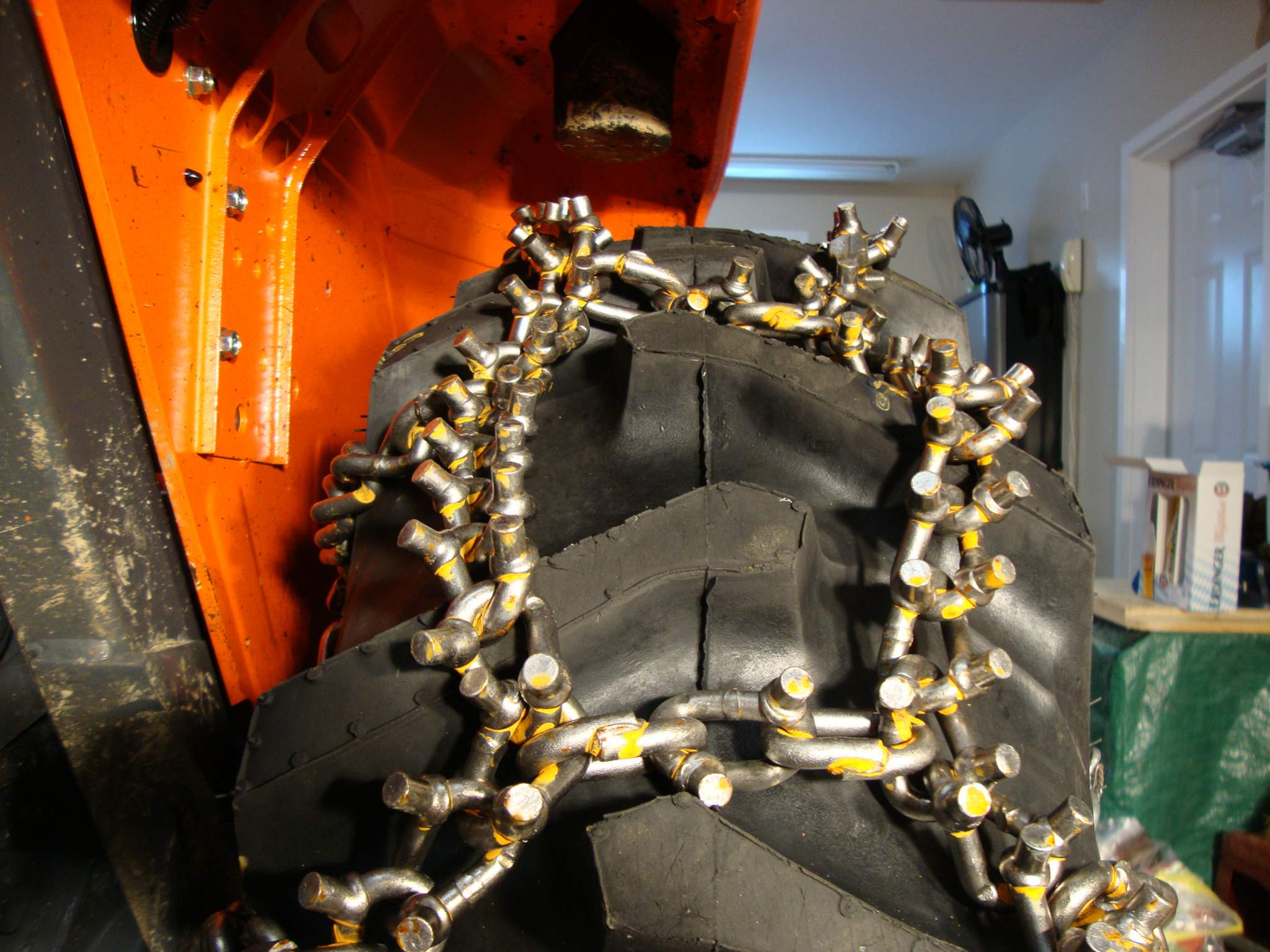

I've got studded ice chains, pretty much the same as the Aquiline Talons. Great working chain, but as the guys mentioned not good for hard surfaces. Not that the chain won't work on them, but they chew it up. Mine are Norse Super Tractor, made in Norway I think.. by a company named Tellefsdal. They were about $550 for 11.2 x 24 AG type tires.
View attachment 344208View attachment 344209
I run them loose, as recommended by the manufacturer. They've never come off, there's no way they can really unless something breaks. I'm on the 4th winter with them now, no signs of excessive wear yet.

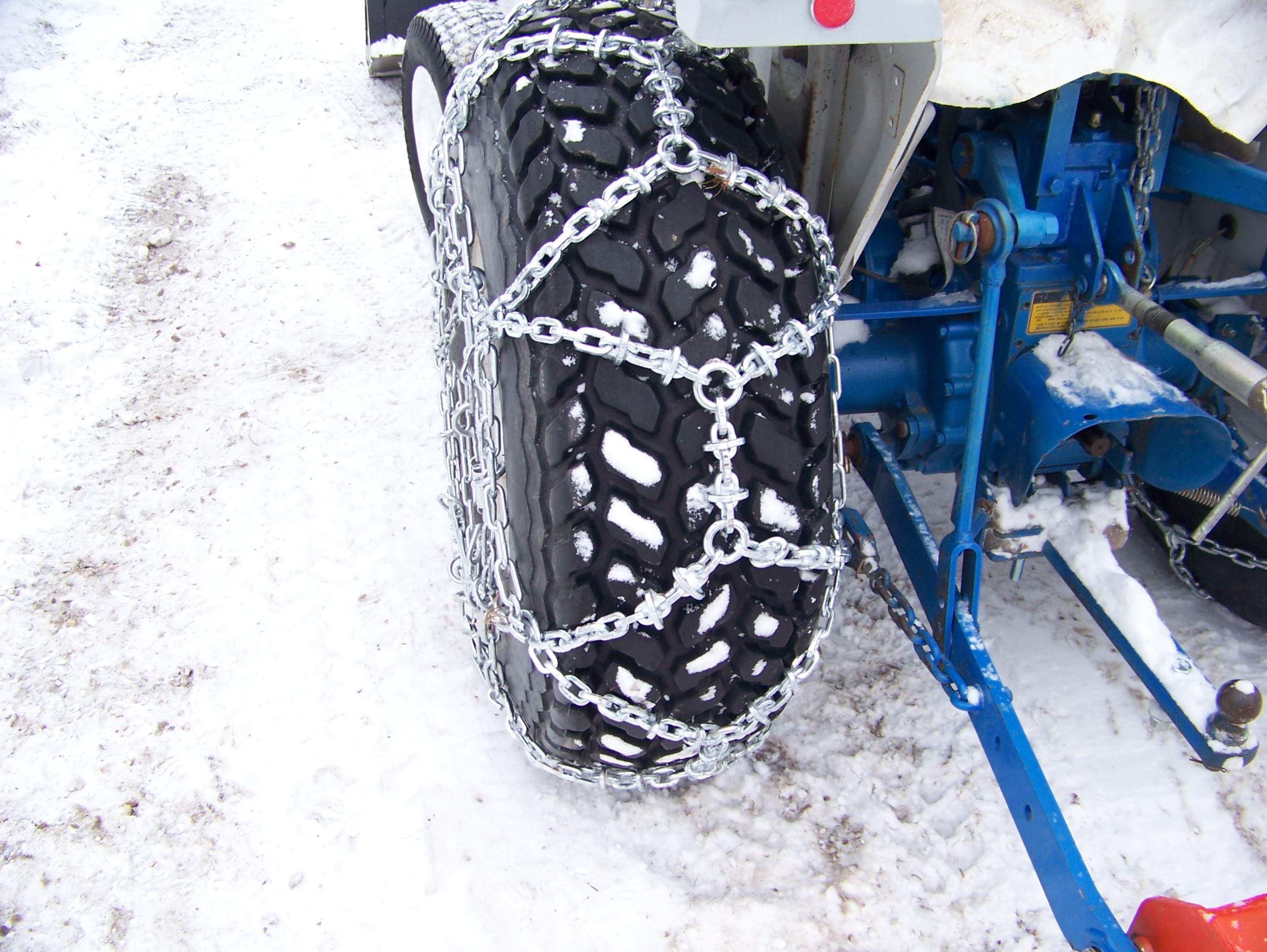

Here's what I use on my turfs for excellent winter traction: SkidSteer Net Tire Chains I have been very pleased with them over the last two winters since I got them. Even though I have a gravel drive, I still like the fact that they don't have aggressive studs to tear up my trailer decking if I have to haul my tractor.
Just another option.
