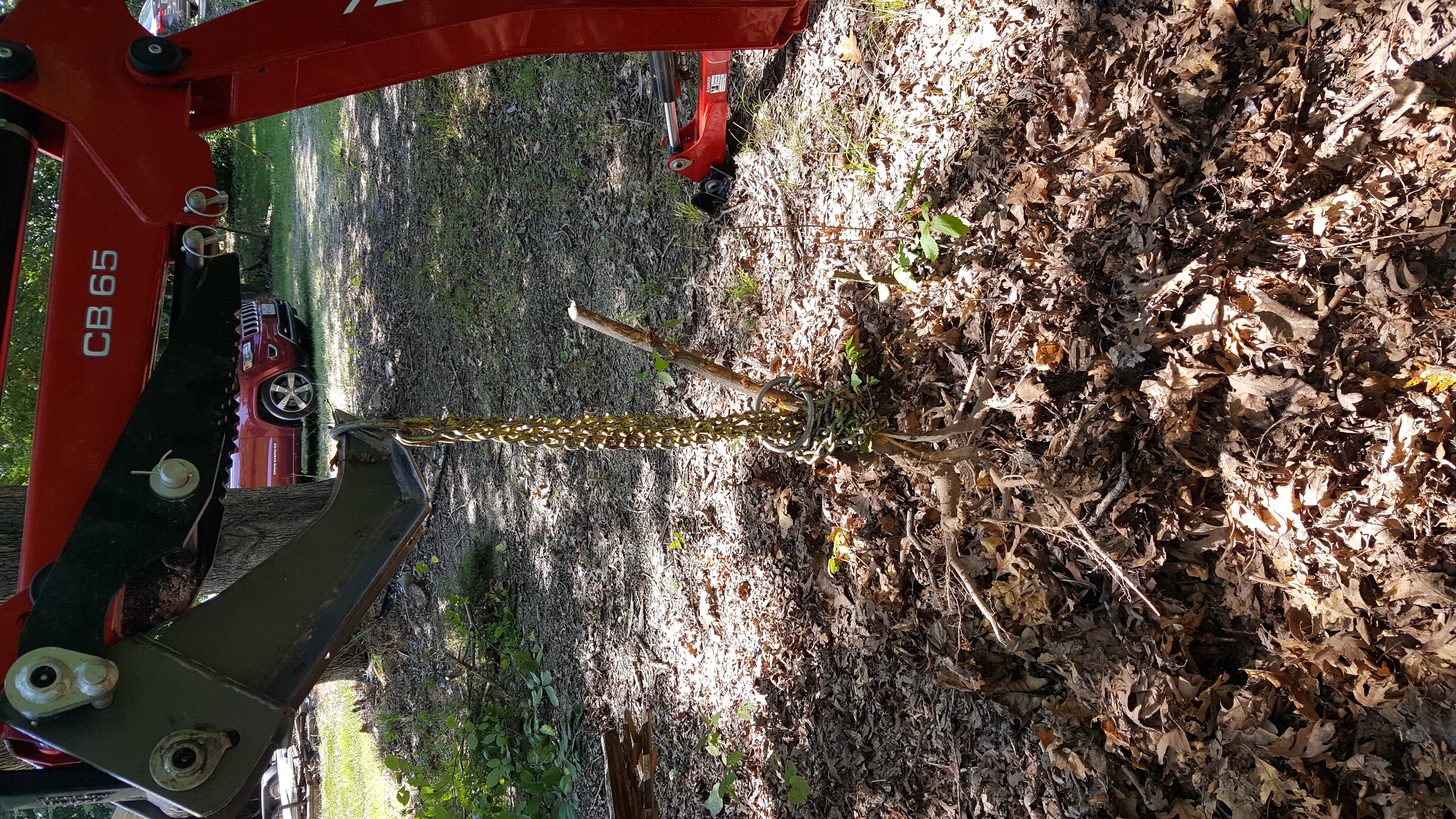

Old thread, but worth re-visiting.
Over the weekend, I needed to clear some saplings, and at the last minute thought to snap a pic of what I've used for years to pull mulberry trees that the birds transplant everywhere. I used to just wrap around the sapling and hook to my Jeep Eco-diesel in 4X4-Low and 'idle' it out, but tried using the BH - some I had to break some roots w/ the ripper, but many I just grabbed with the choker and hooked to the ripper, curled it, and out they came, easy peasy!
Here's the choker I have used for 15 years now
Brush Grubber Shrub/Clump Grubber, Model# BG-16 | Weed Control Brush Removal| Northern Tool + Equipment
