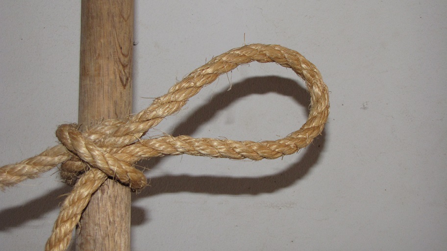

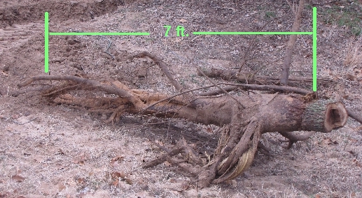

Now you have clean drawers, try a Clove Hitch knot around the sapling. It works, and a quick release Clove Hitch is about as simple to un-tie a a boot lace.

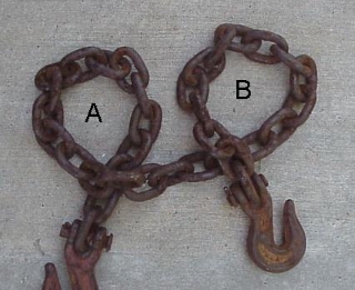

I find a use for that knot nearly every day pulling trees or not. Just yesterday I used the quick release knot on both ends of a rope to drag a tree limb to the brush pile. Much quicker than loading it on a truck or trailer.
For convenience on tree trunks, pulling fence posts etc. or anywhere there is an end to drop the loops over, loop A on top of loop B and drop it. A Native American sailor taught me that technique. RIP Bill
The rope example with the loop is the quick release Clove Hitch I taught myself. Only 1 end of it has holding power while both ends of the regular Clove Hitch has holding power.

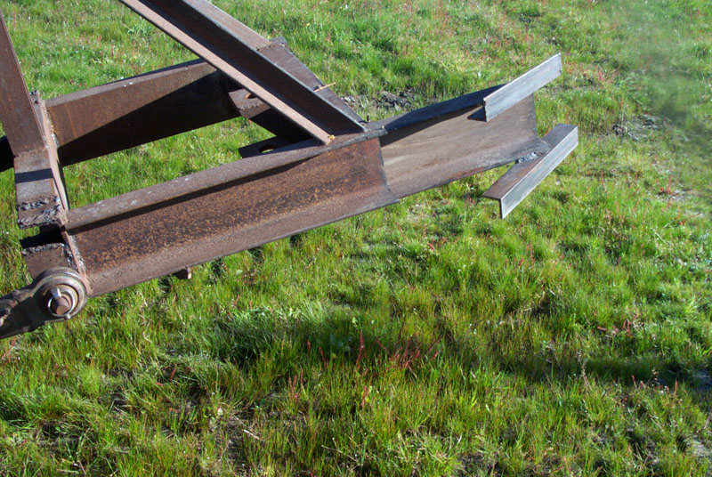

I found a picture of the thing I made to mount on the 3-point; as you can see, simplicity itself.
Pull, lift, drive.
Drop and revers to release the waste.
Fast!
Cheap!
