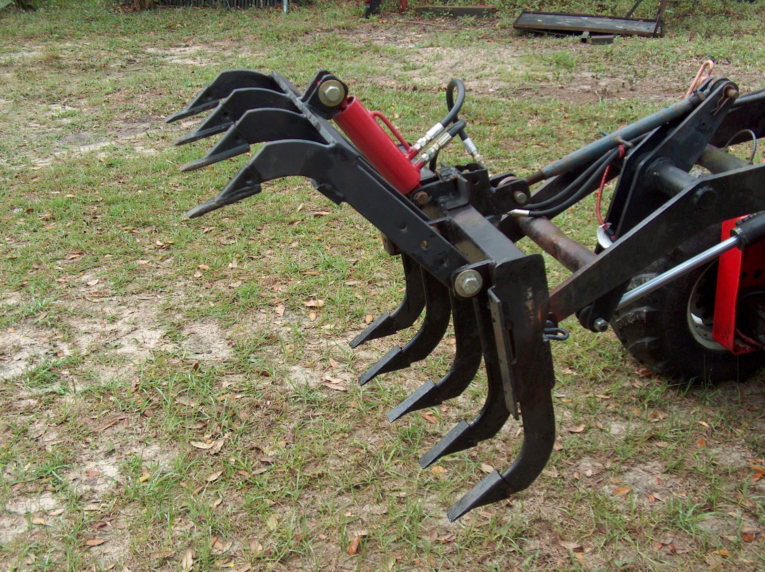

HR,
You've got some great looking tools there. I especially appreciate the York rake as we tried buliding one years ago to rake the stones out of our motorcycle track. We welded springtooth drag teeth to or horsedrawn grader and popped teeth all over the place. Every one broke at the weld. Nobody told us about welding on spring steel. Oh well, live and learn!!!
/ Better built implements #43
I just made the gauge wheels on that rake, looked easy enough to try the whole thing though... The rake was only $300ish, for that price they can build it! They wanted almost that much for the gauge wheels. I could do those pretty easy and cheap.

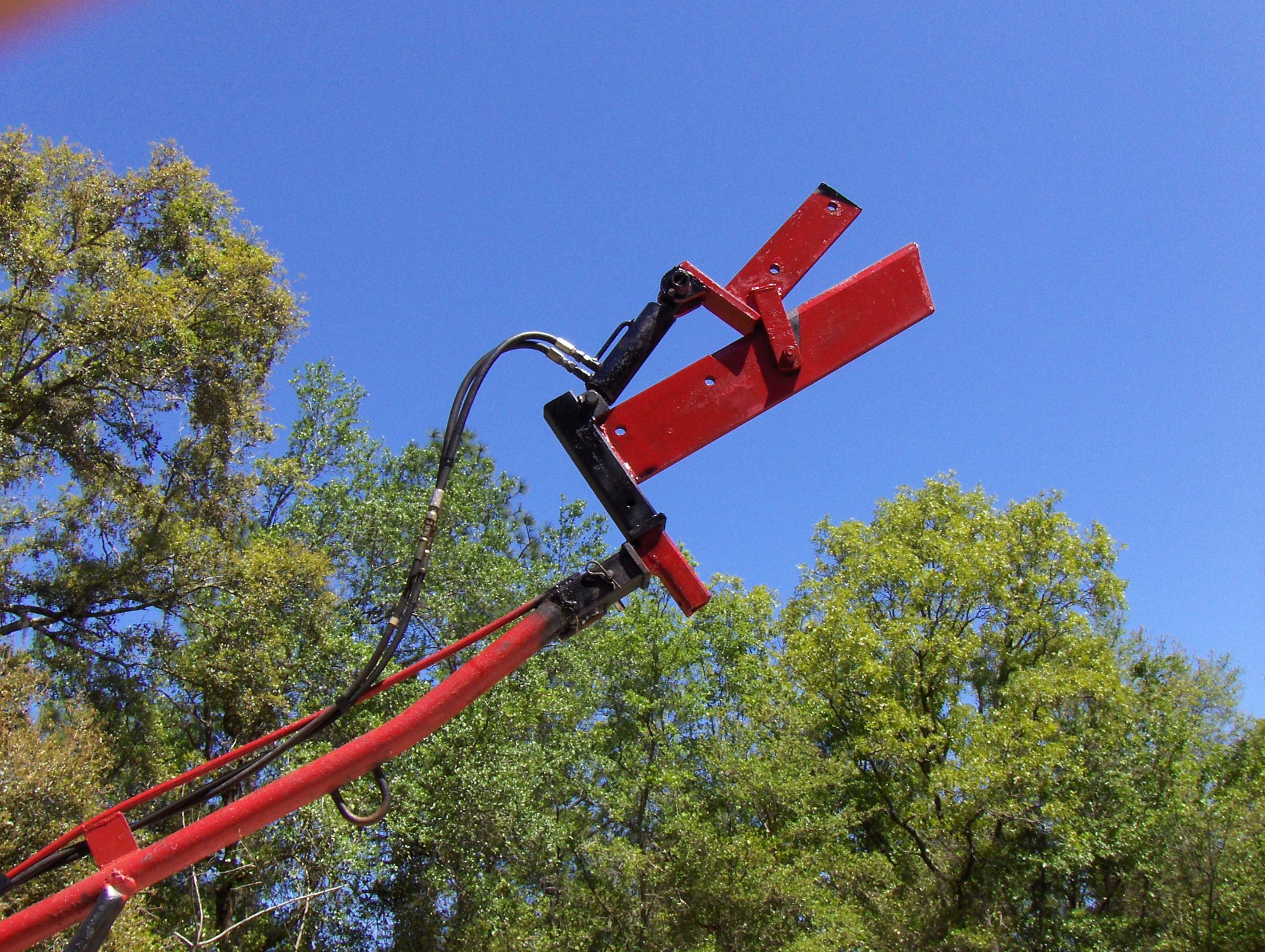

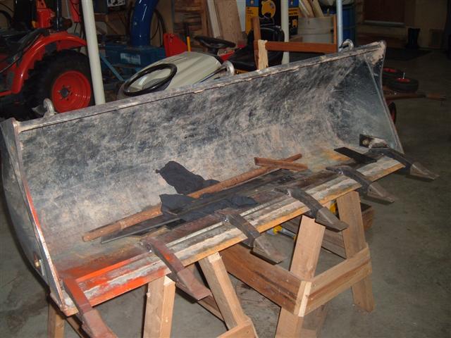

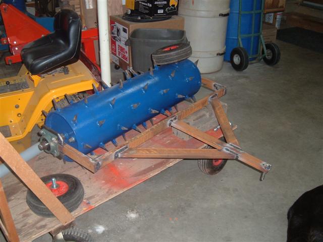

I'll bite, it's all about sharing ideas here isn't it?
Aerator, Hydraulic chute rotator, toothbar, QA forks, root/grapple rake, snow wing, rear counter weight, hydraulic dump, QA snowplow, there are many others but anyone can build whatever they want if they put their mind and their wallet to it.

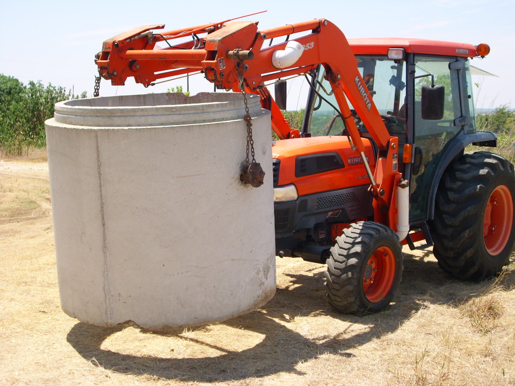

Well, I claim the prize for best value for pounds lifted for $$ spent versus pounds of implement to facilitate lifting.
$$ = 0.0, I scavenged some used axles/hubs from scrap laying around
implement weight = less than 20 lbs for the axles... maybe a little more if you count the non dedicated chains.
lift weight = 2800 lbs of concrete culvert turned into a corner post. This culvert cannot be otherwise lifted because FEL bucket or forks add so much weight that relief valve pops first. I have numerous of these culvert corner posts and use the implement several times a year as I place them for new fence corners or replace old wood ones.
Best corner I've ever found...never rot, pull out of the ground, rust, tip. Axle shafts fit into holes manufactured in the culvert explicitly for lifting.
Dig a hole and set one of those in it, and you could cook a whole pig. My brother put one of those in his back yard a number of years ago, and it's perfect for a deep pit BBQ. He just had a piece of 1/4" plate cut for a lid, and presto, works like a charm.
