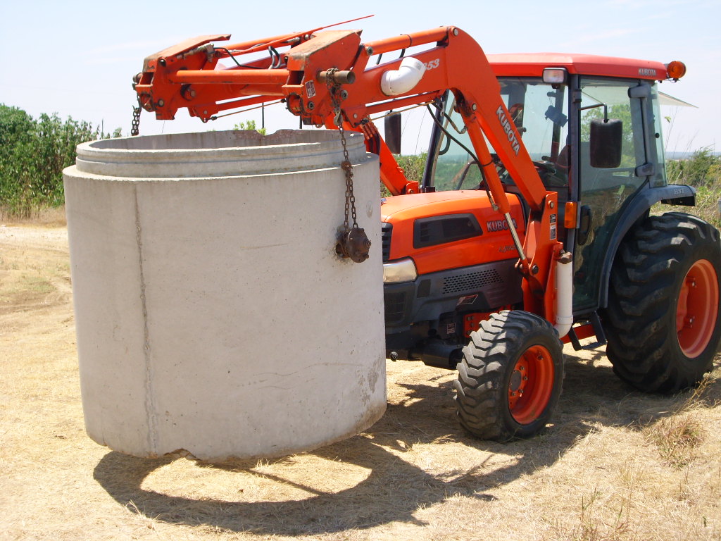

Well, I claim the prize for best value for pounds lifted for $$ spent versus pounds of implement to facilitate lifting.
$$ = 0.0, I scavenged some used axles/hubs from scrap laying around
implement weight = less than 20 lbs for the axles... maybe a little more if you count the non dedicated chains.
lift weight = 2800 lbs of concrete culvert turned into a corner post. This culvert cannot be otherwise lifted because FEL bucket or forks add so much weight that relief valve pops first. I have numerous of these culvert corner posts and use the implement several times a year as I place them for new fence corners or replace old wood ones.
Best corner I've ever found...never rot, pull out of the ground, rust, tip. Axle shafts fit into holes manufactured in the culvert explicitly for lifting.
TJ:
What's the purpose of the PVC elbow on the loader arm?

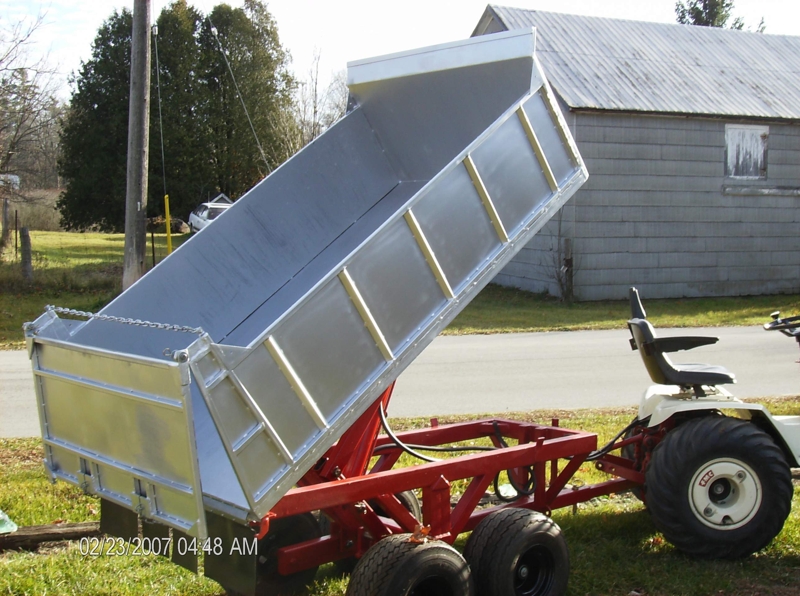

Wow , very bold statement ! I'm up for the challenge, made my own stuff for 20 yrs. scraper box, FEL, 3 pt lift forks, pull behind hydraulic land scraper , working on backhoe now, but for starters heres my recently done super garden trailer, ok, I showed you mine,, lets see yours ! :D

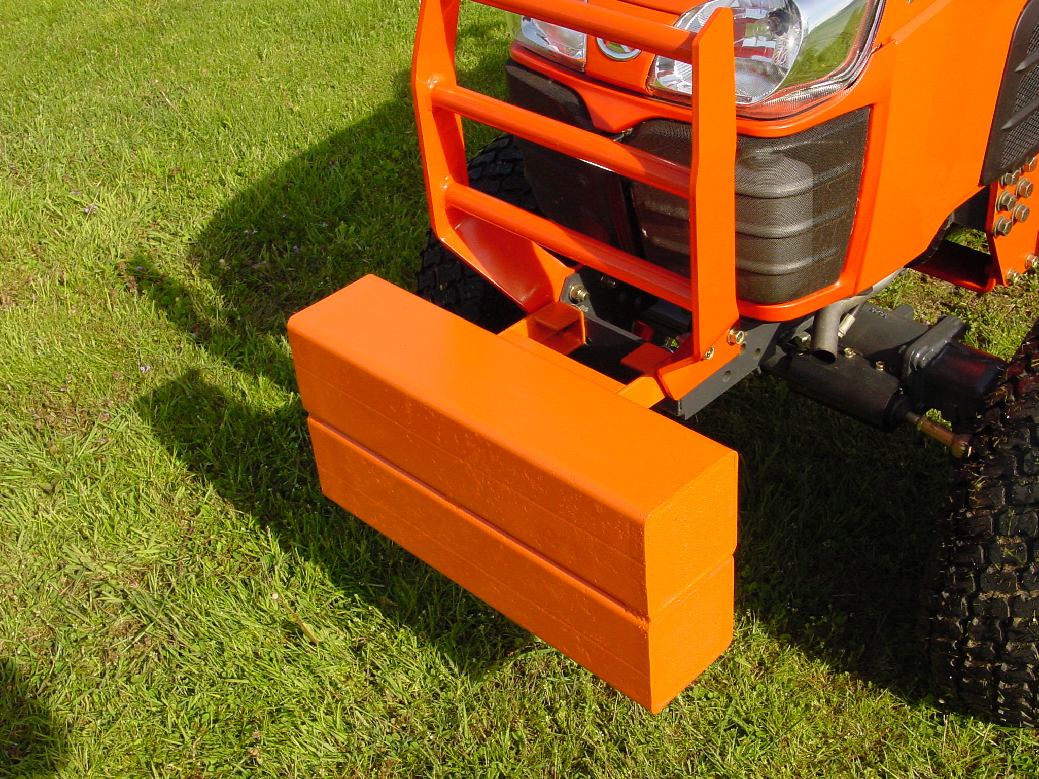

Quick set of front counter weights I put together. I use them when I'm brush hogging. Can be put on or off in 5 minutes.
How heavy are they? Appear to be two pieces of square tubing filled with concrete?
Does it sound sissy if I say that is a beautiful work of art. It would seem a shame to get it dirty.
Steve

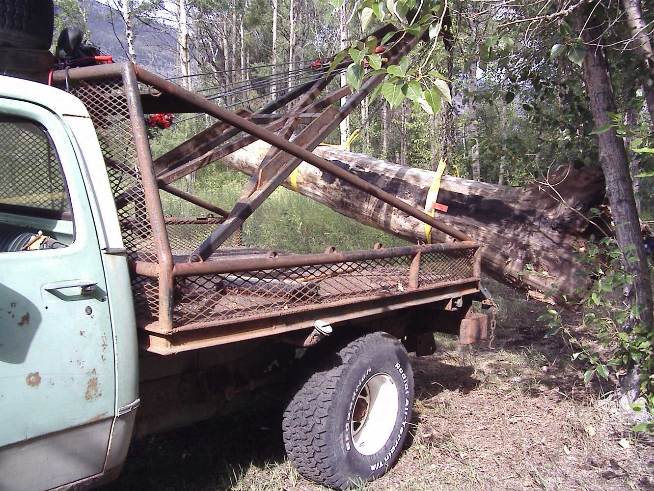

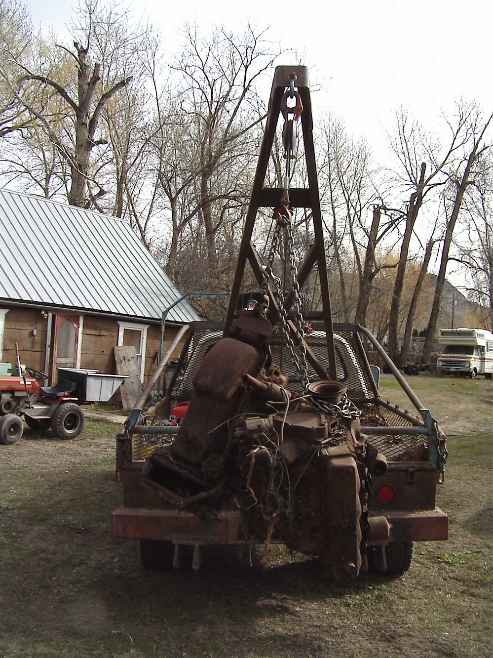

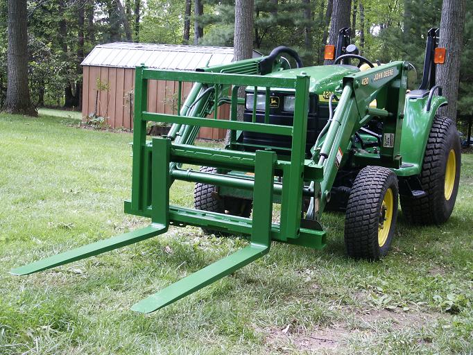

Here's a few of mine, nothing fancy. Built more for functionality.
John

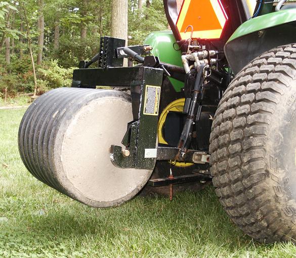

/ Better built implements #73
I have the same quick hitch and like that design. Although I am thinking more of a lawn roller or perhaps an aerator along the same idea.
Did you use a rod or pins to connect to the hitch?

sorry if i missed a previous explanation, but what is this?:)
/ Better built implements #76
Looks like a hit-or-miss prettied up for the old engine show. Nice! What's it run?
Jim
/ Better built implements #77
A John Deere 3hp hit & miss engine. I made fork extensions for moving/loading engines. At the shows I usually belt it to a corn sheller or a small plate mill.
M.D.

Sound sissy ? Not at all, its a great compliment ! thank you ! I put alot of pride and care in my builds. This functions as a dump truck does, allready got it dirty, but washed it down, repainted inside of box before storage.:thumbsup:
