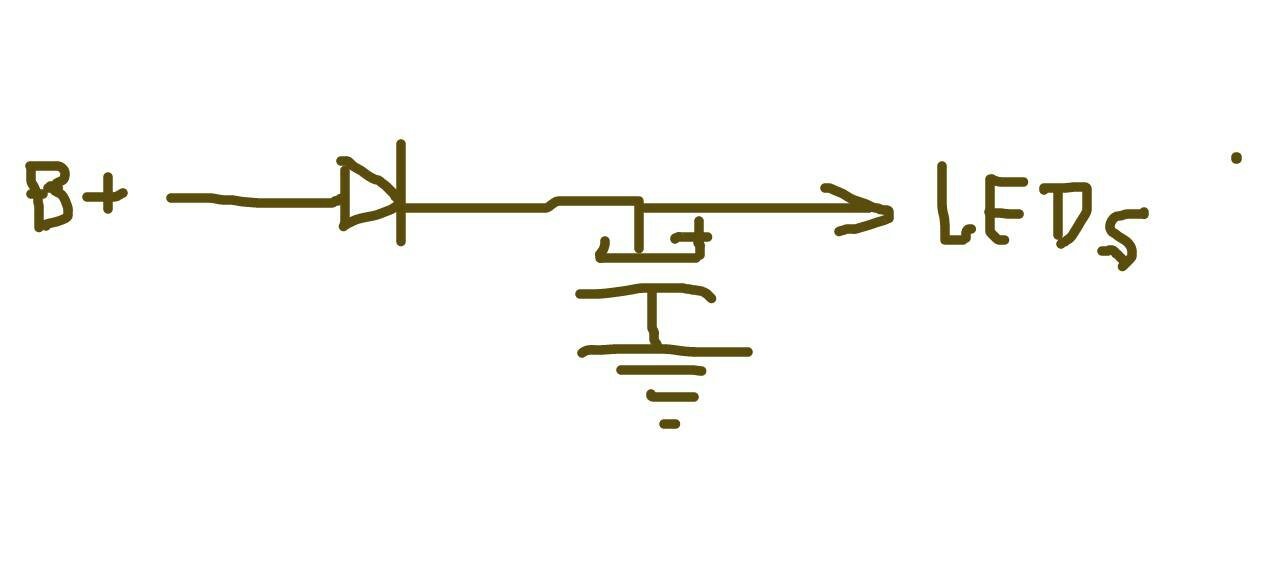

This is a simple draw app (my finger is shaky)...very simple. B+ is power source, cathode has electrolytic cap to ground, this is now source to lights.
Of course this would be close to LED, maybe one for each. With your o-scope probe here, value of cap for lowest p-p noise level. Who knows...1,000 ufd @ 25v, a low esr hi temp quality cap? image_2019-11-18_11-14.jpg

Ok but remember it is not the LED's that are causing the issue. It is the power supply that is generating the B+ (BTW you just gave your age away <g>).
We are worried about what the power supply (that is generating the B+ in this case) is injecting back onto the raw DC supply lines ! There is a country mile of electronics between the LED's (load) and the DC supply voltage.

You have 99% of it correct. Imagine the 13.8 VDC from the tractor feeding a SMPS. The output from the SMPS feeds the individual LED lights. The SMPS and LED's are all inside a die-cast aluminum enclosure. The issue is the SMPS contaminates (inadvertently) the 13.8 VDC supply (INPUT) voltage from the tractor.
Filtering the DC voltage after the SMPS going to the LED's would not help matters. We need to filter between the SMPS and the tractors 13.8 VDC.

I understand and we're on the same page.
Ok...
"The SMPS and LED's are all inside a die-cast aluminum enclosure. The issue is the SMPS contaminates (inadvertently) the 13.8 VDC supply (INPUT) voltage from the tractor."
What I'm trying to say in that simple drawing is do not supply LEDs tractor power. Instead tractor power to anode of diode. Diode cathode to LED supply.
I'd use one diode+cap each light.
Instead of 13.8v going to each LED you would have 13.1v. Scope this point. Cap value for lowest noise.
Simple...hopefully this diode/filter cap prevents feedback from LED back to tractor "B+".
I used ECG125 diodes all the time. 1000 prv, 2.5A.

Ok I think I see the issue here. In your drawing you have it labeled as LED's. I think what you wanted to say was "LED Assembly" is that correct? You would like to see the diode and cap BEFORE the entire LED LIGHT ASSEMBLY....right?
   / Beware of possible issues when installing some LED lights on your tractor #79
Yes! Exactly right...now we're @100%!
