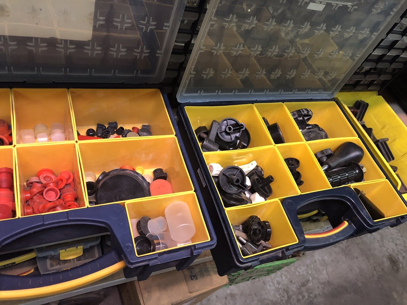

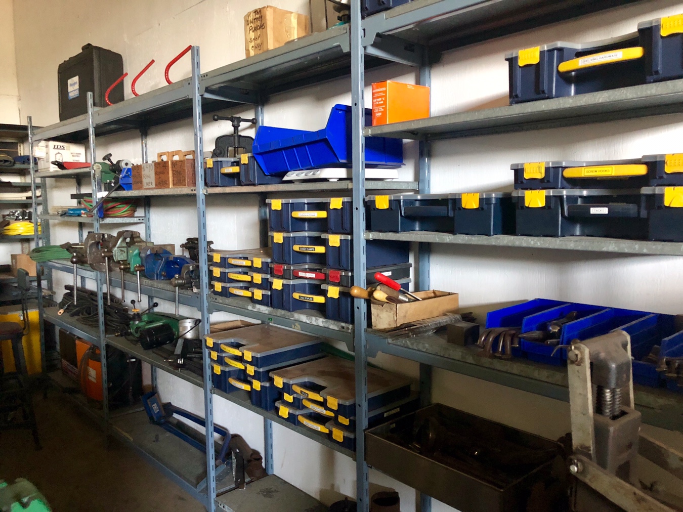

It’s the Little Things Part 4 The Missing Miscellaneous .
No matter how hard I try to organize things I sometimes wonder why I bother. All those little widgets I didn’t throw away because I was CERTAIN I would need them someday. I usually find them several days AFTER running to the the store to buy more.
I’m talking about stuff like this:
It’s not considered hoarding if you try to keep it organized.
TMSAISTI.
Please feel free to offer your personal solutions.
