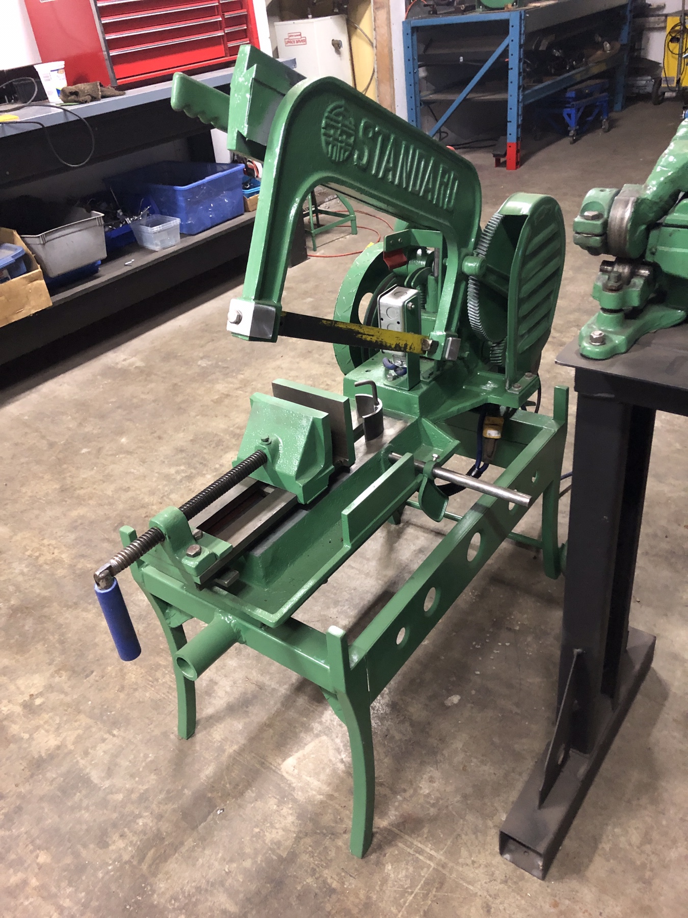

A friend gave me this Taiwan power hacksaw for a “project”. It seems to have been dropped from a truck and needed total rebuilding. I had to refab motor mounts, frame, base, and repair the vise. It uses a 17” blade.
Pay attention to which direction the cutting arm “lifts” for the return (non cutting ) stroke. Hand hacksaws should have the teeth facing forward to cut on the push stroke.
Some power hacksaws were designed to cut on the push stroke and others on the pull.
I ditched the coolant system for it and use a wax lube stick for the blade.
   / Big Barn’s Retirement Farm Shop #236
That is one heck of a power hacksaw. I will have to check out wax lube sticks since I did not know about them. I do not think my 601 lifts at all but looking at the blade is mounted it would only cut on pull back part of the stroke. Now I know I can reverse mount my saw blade to use the other end.
