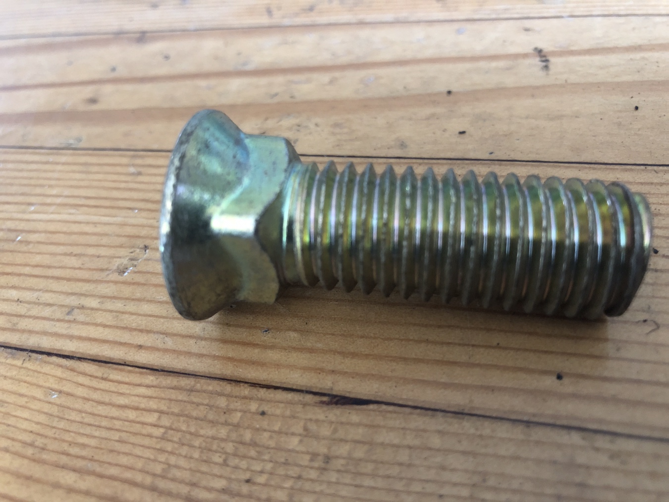

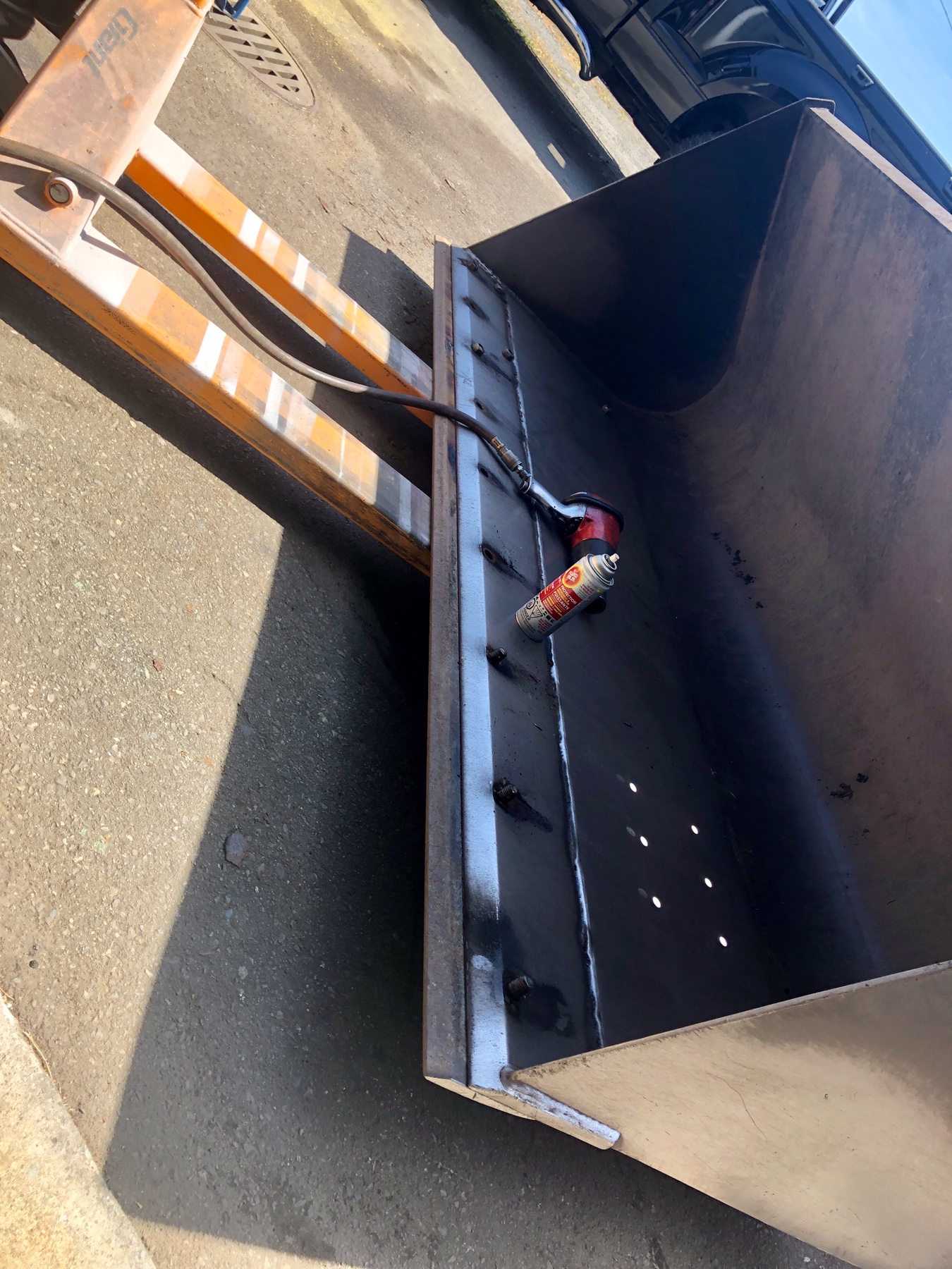

I needed to turn the cutting edge around on a loader bucket but 3 of the plow bolts had corroded square shoulders so the nuts couldn’t be removed.
Plow bolts look like this:
Normally I would just torch them off but I didn’t have any the right size (20 mm x2” or 3/4 x2”). And being Sunday I wouldn’t be able to get them today.

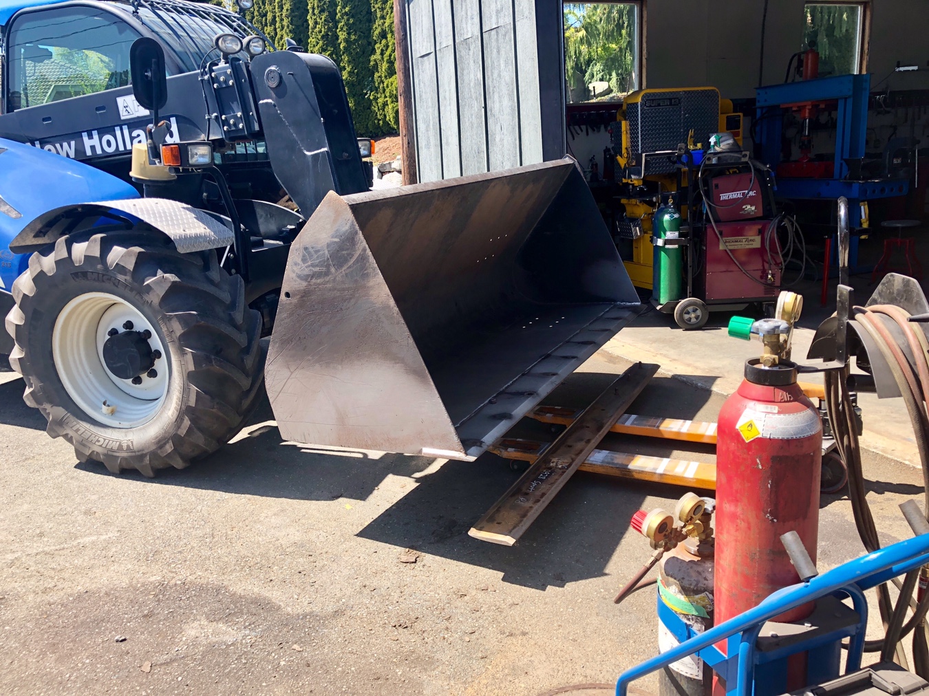

My solution was to tack the 3 problem bolt heads in place. Each of the eight nuts had to be heated before removing. Neither my big impact or a 3 foot cheater bar would break them loose otherwise.
With the nuts removed the cutting edge was reversed and repositioned with a pallet jack. Pretty much the only way to do it alone as it weighed a little under 120 pounds.

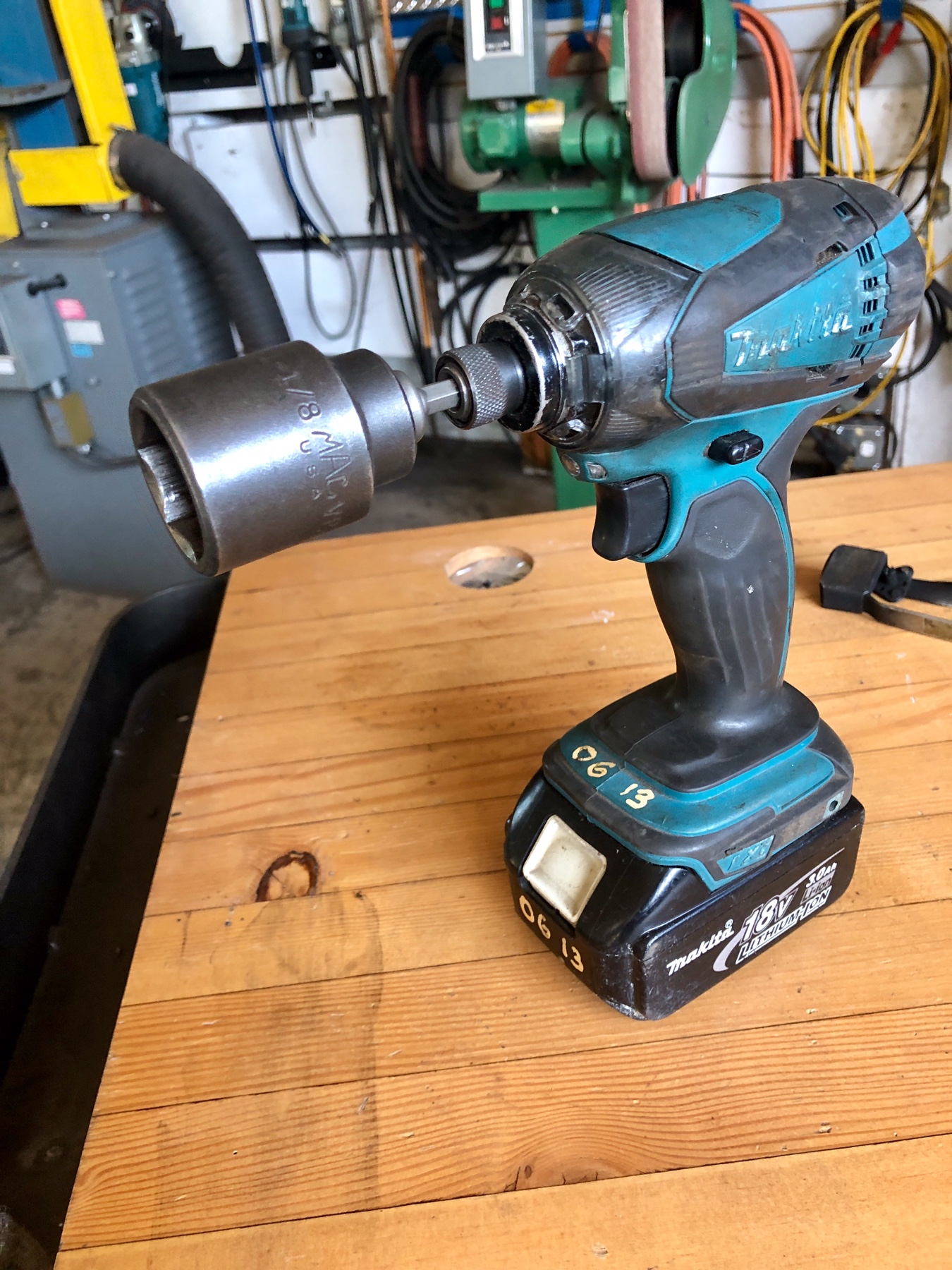

The remaining bolts were cleaned with a wire brush and reinstalled using a low torque cordless impact.
Using a low torque impact allowed me to use a finger to push up and actually feel the bolt head seating properly while drawing the nut down the threads. Once it was snug I used a bigger impact to actually tighten.

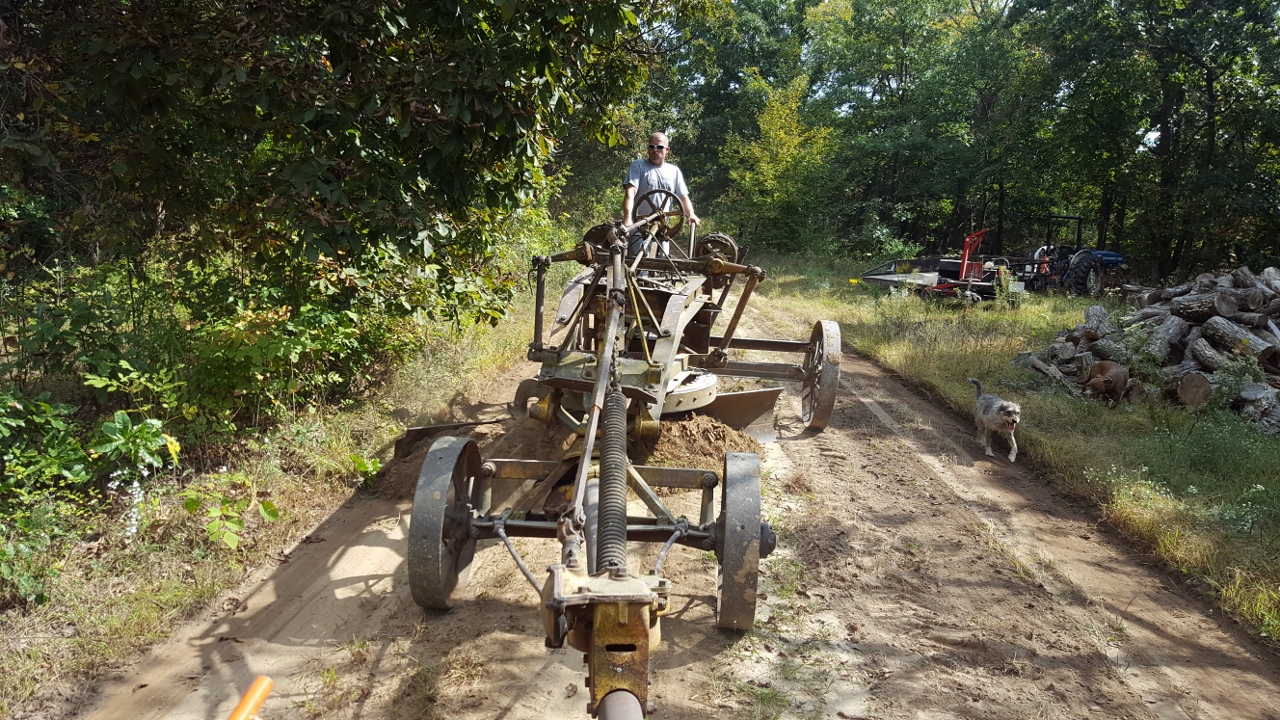

Speaking of graders. I bought this grader from the local scrap guy for $300. It's a late thirties model 44 Caterpillar. In this first pic I'm pulling it with my M9540. My Son Danny is running the grader. Men were men back then. He ran it for 2 hours and was done. :)
