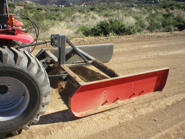

Phil, do you want to reshape, or just smooth out? Smooth out, LPGS hands down. Reshape, a good heavy rear blade. When it comes to grading, weight is king. Of course there are limits, usually restricted to the capabilities of the tractor being used. I have a 3215 Mahindra, I use 800lb implements behind it all the time. They work quite well IMO. I would not hesitate to tackle your road, although I would prefer to use my 7520 with 1000+lb implements. :cool:

Brian, mostly just keep it reasonably smooth. In some areas I need to do some shaping to help control how the runoff flows during the rainy season as it tends to get erosion ruts on the hilly parts.

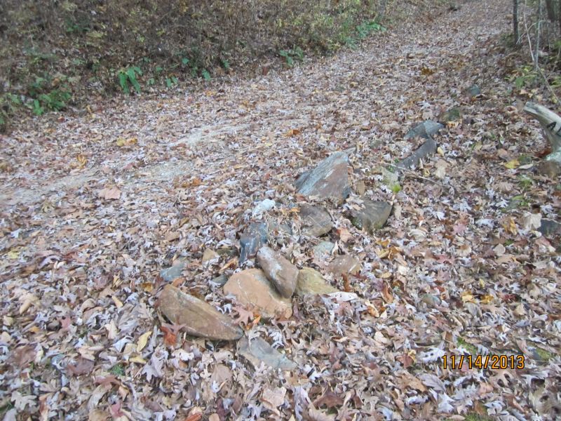

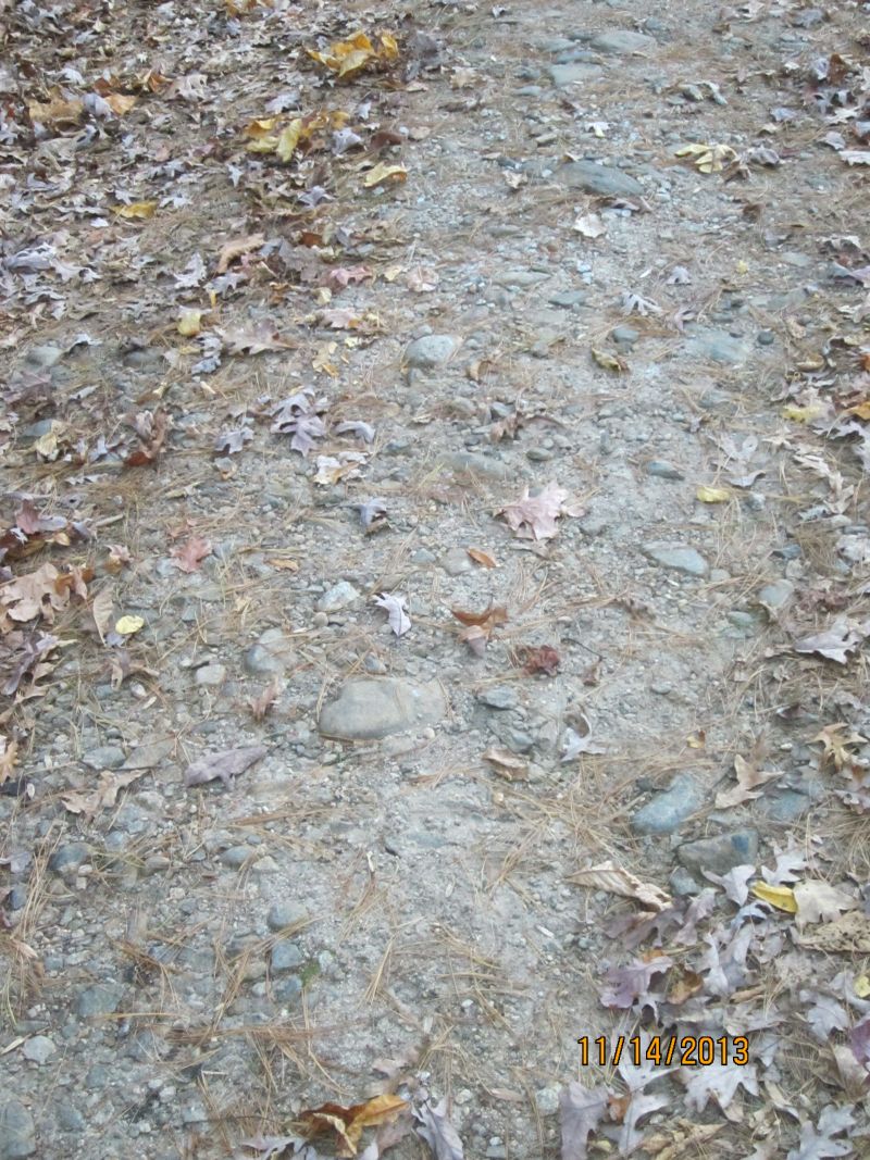

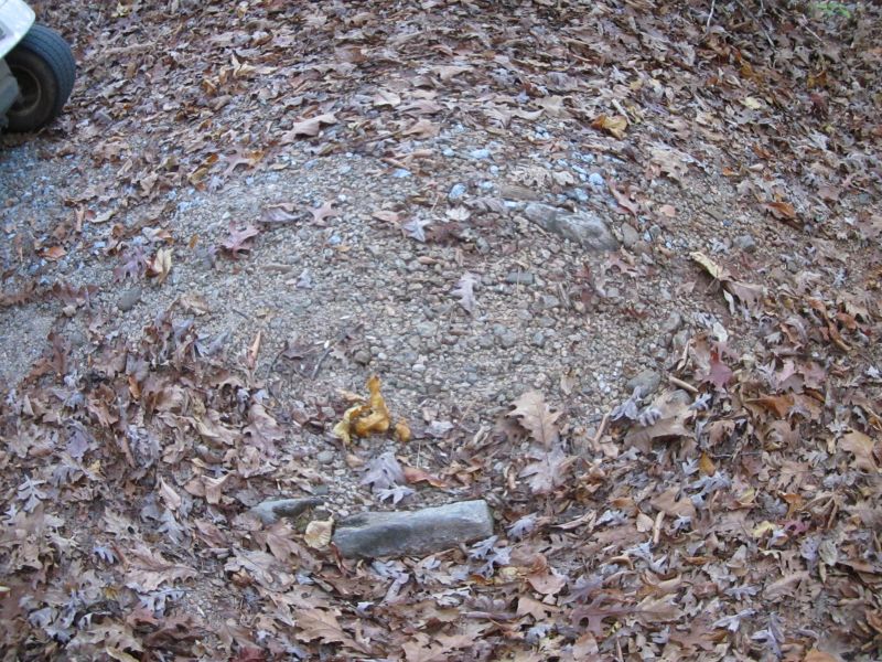

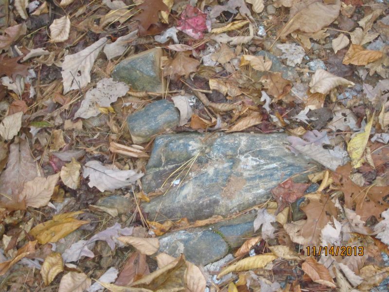

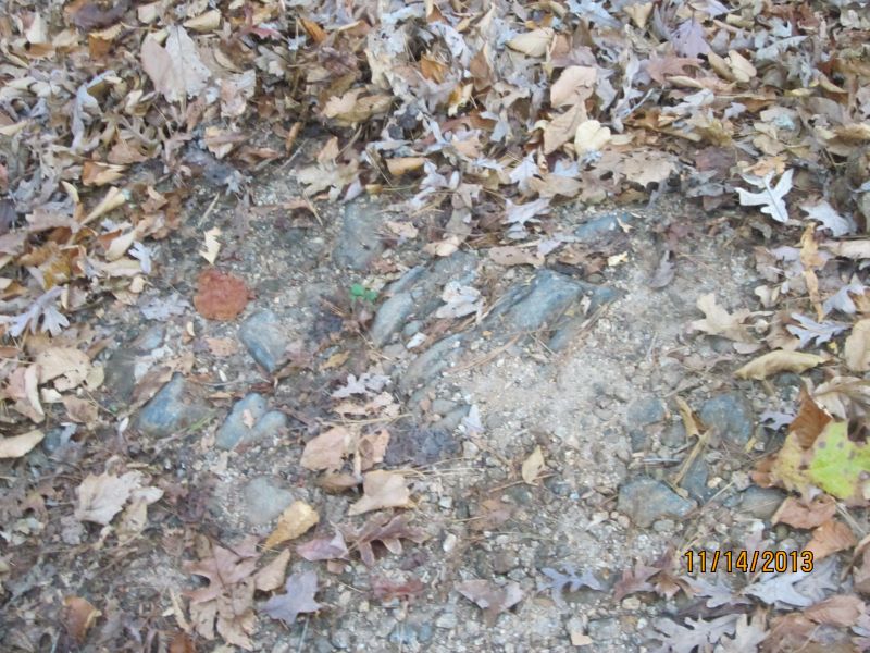

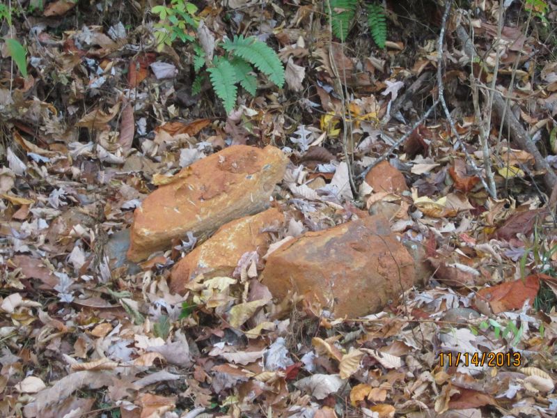

I'll start this post by honestly saying I have the utmost respect for Brian (as well as so many other contributors here)...and this tete-a-tete (or "dust up" as some seem to see it) has not changed things one iota...! it was never my intent to be confrontational...just my observations and experience...
...Believe me...with so many positive opinions on how well land planes work for so many here...if I thought by any chance that one would work for me I would already have one...
While I'm on the topic of things that seem to work well for others...are gauge wheels on a rake of any benefit when you have a hydraulic side link:confused:
back to land planes... FWIW...just out of curiosity I searched CL (all the locales closest to me) and could find none either wanted or for sale... using "search tempest" (searches all of CL) within 250 miles it turned up zero results (except on e-bay)...using my zip they were not listed on the TSC site...
@ Brian,
I am terrible at remembering to take "before" pictures...and right now with so many leaves on the ground it is nearly impossible to take pictures that would help you understand the local "natural" strata...but I did find a few pics that may give you an idea of what I deal with...
Most of the lane work I do is on private drives and not so much heavy traffic roads...most are single track...this is mountainous country with steep grades and controlling storm water run-off is the major issue...
The pictures below hopefully will give you an idea of what I deal with...I almost always use "crusher run" as a topping...usually 3"-4" is all that is required...much of the time the top of the imbedded rocks consume the depth of the topping...trying to remove them all would increase the man hours exponentially...once the topping is applied a rake is about the only implement that will not hang up on the the under lying rocks...lots of these rocks are bowling ball size...some much (much) bigger... some of the rocks pictured were extracted and moved to the side...

So, Slash Pine what implement do you use on what you have there?

I only have a 17 HP tractor, that said... For the basic grading (before topping) I mostly use an old,heavy (for my tractor)...about 450#'s M.F. 6' rear blade (I have replaced the crank type cut pitch adjustment with a hydraulic cylinder)... I mostly "pitch and ditch" the lanes rather than crowning (it's heck trying to push water back up a mountain i.e., to a high side culvert etc.)...when I have to remove large boulders that leave big holes I use a 250# BB to scarify the area and fill it with spoil...when starting...after the initial passes I spend a lot of time getting on and off the tractor removing the semi-smaller rocks that the blade turns up...
Once the crusher run topping is applied if I try to use anything but a rake I just get hung up on the tops of the under lying larger rocks which creates havoc and a lot more work...
I don't do this as a full time job otherwise I would have bigger, heavier equipment i.e., a small dozer etc...but I have fun doing what I can do with what I have...
FWIW...after the initial grading is done is is amazing how well just 3"-4" of crusher run holds up...and it is very easy to maintain (collecting and re-distributing) the topping with a rake...

If those roads get crusher run on top of them at 4" deep, I would use a LPGS. If they are how the pictures seem to show, (to me any how) then probably a landscape rake.
But then I don't think that I have the patience to even try to tackle those with the size of equipment that you have.
