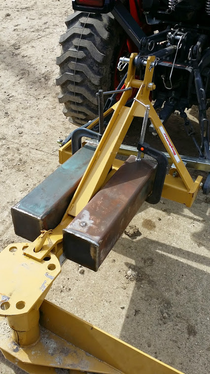

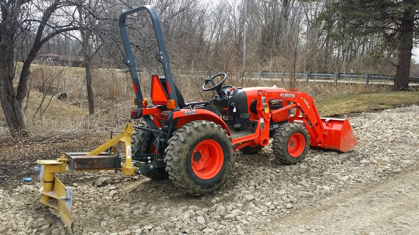

As this topic has stated, adding weight does make a difference.
The blade sure was effective in laying in a drive of large crush stone.
If I need to bust ground, the box blade with rippers have proven to be the best solution. Adding in 400-lbs to the box blade has made the hardest soil break free.
