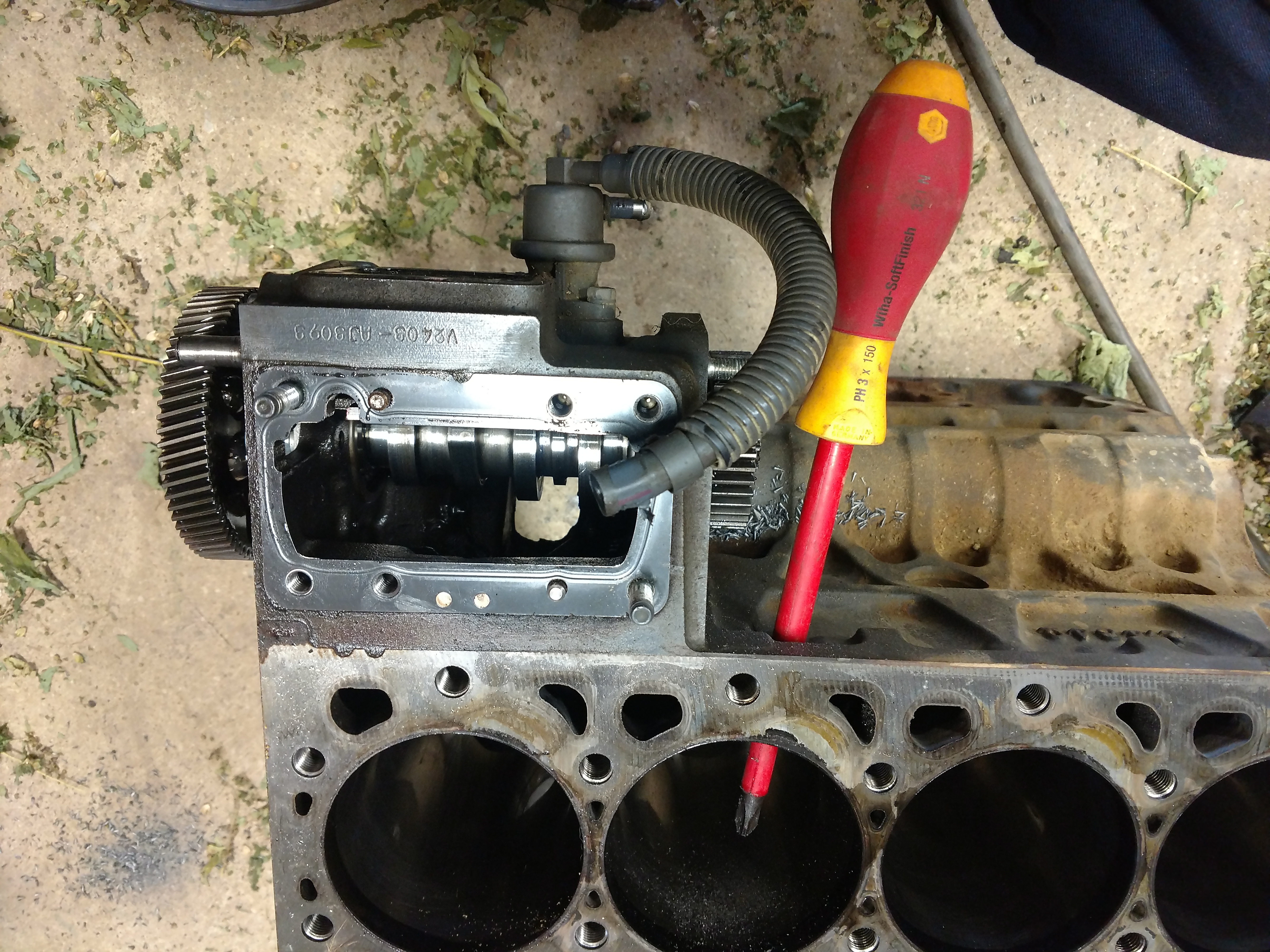

It didn't take you long to get it in place... That Busch can in the background indicates that it was a one beer job.
More like a 8-9 beer job. I just keep them crushed and out of the way. The one in the background was the active can at the moment.
Got started on it about 1pm. 4:30p when I posted the pics, the tractor was back together physically, but still had all the accessories. Electrical, fuel, cooling system, hydraulics, loader posts and hood.
Got all that done by about 7pm and she purrs like a kitten. Gonna head out and mow a few acres today to put her to the test.

And dont know if I updated about the oil light or not, but the bulb is fine. Tore into the dash last week only to find the bulb works just fine.
So looked at the print in my WSM to see how this circuit was designed..
The light ALWAYS has 12v present. The oil pressure switch is NC....meaning with no oil pressure it completes the path to ground and makes light come on.
So took trusty meter to the old sending unit...yep....switch is stuck open.
Dont really care for this design for the oil circuit....if wire breaks, pulls off, or switch fails the light will never operate.
New block didn't come with a new pressure switch....so that added $28 to the cost. And $90 worth of oil and coolant. But it fired right up and sounds great

I though 6 hours was excessive. Wasnt working too fast and rushing though. Because there is a certain order to many of the things. Didnt want to get ahead of myself and forget something and have to unhook / back track to get what I forgot.
But figure about the same amount of time to take apart...a 12 hr motor swap job isn't stellar numbers by any means.
I can pull motor in my backhoe in about 2.5hrs...and back in about the same time.
Wonder what kubota's book time is on a motor R&R? I could have shaved ~1hr off each end if it was a non-loader tractor. But those heavy mounts, and 12 bolts each side + the control valve...
