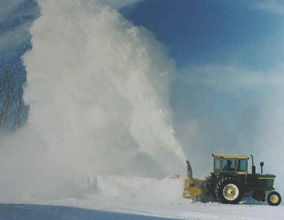

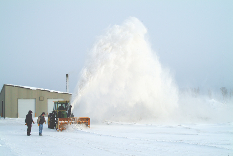

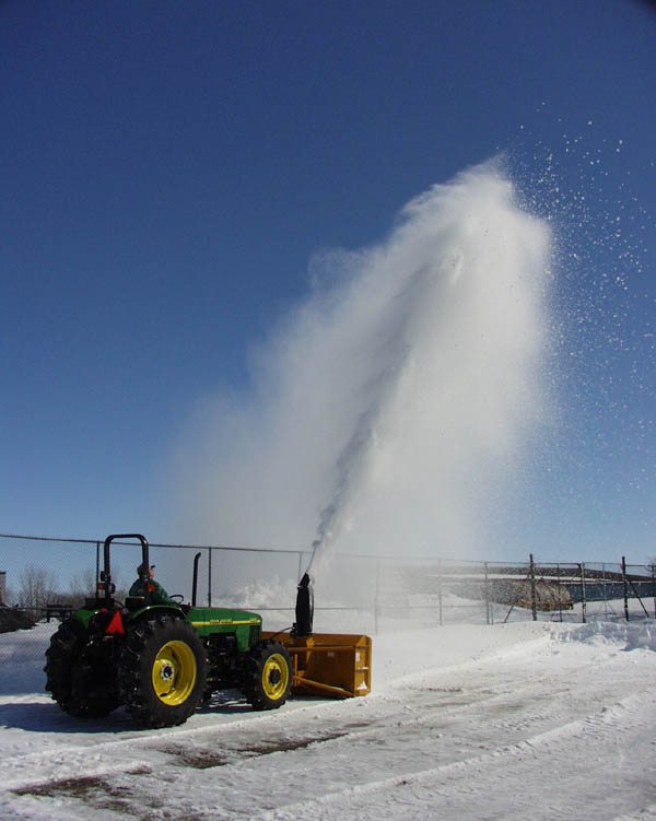

I think you will find that a 3ph snowblower will certainly throw snow further than 6 feet. You will have banks, but most will be anywhere from 20 to 50 feet away from where you are at.

That's pretty impressive Wayne. I'd bet if the chute was directed a little more horizontal and not so vertical that snow would be flung close to 100'.
