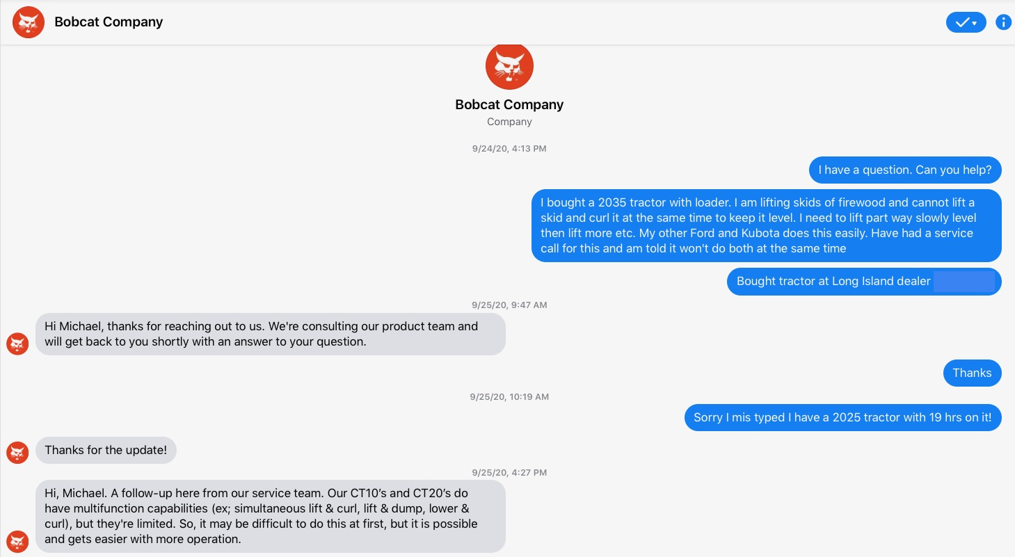

I move skids of firewood with the loader and No it does not lift and curl well.
The more weight the worse it is
I have to lift. STOP. curl level the lift and repeat
I even contacted Bobcat corporate down south. see below
It does lift and curl a little when empty if you go slow enough
Had it to dealer for 50 hr service and he was clueless.

MikeWard, thanks for sharing your experience. I’m not sure I follow the logic of “it’ll get better over time”. Our NH45 has done it as long as we’ve owned it. Took a little practice but not all that hard. If my RX7320 is capable it sure hasn’t gotten any easier or more obvious. Still only at 300 hours.

I had a ford 1920 for years and it could lift and curl the same wood skids effortlessly.
When I tested the bobcat I thought I was doing something wrong and it would get better. NOPE!
The Bobcat is still a really nice machine but the loader functions are flawed!

I'm trying to decide between the Bobcat CT2025 and the Kioti CK2610. I suspect the loader valve is the same on both even though the loaders themselves are made by different groups. Really does seem like a nice machine; for me it will probably come down to who/when/where I can get one.
I spoke with a dealer yesterday who seemed very knowledgable and he said it should be possible. He said it wasn't easy but could be done. Consistent with what Bobcat told you but sorta feels like, 'it can do it and if it's not working for you, you're just doing it wrong' which, to me, feels like a cop out on their part. We both know it shouldn't be that difficult to do since we've got other machines that can do it.
