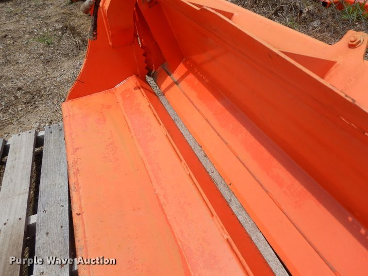

This shows a Landpride 4in1 with it's reinforced edge on the front member of the "clamshell". Doesn't look like it would be difficult to retrofit with a cutting edge and a piece of flat iron or simply an "inverted v" piece of angle iron for reinforcement.

Thanks. That should be doable.
