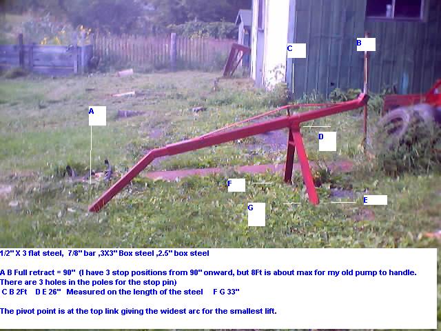

How fast the end of the boom moves depends on the motion ratio, which you probably already know. I did some quick math and came up with a 101/33 motion ratio, or roughly 3:1. In other words, when the 3ph eyes move upwards 1 inch, the end of the boom should move three inches. This is a rough calculations, but should be relatively accurate. How fast do you want the end of the pole to move, realtive to the 3ph? Twice as fast? Half as fast?
To make the boom move slower, the motion ratio needs to be lower. The simplest way to make the ratio lower is to make the boom shorter at the 46" or 28" dimensions. Leave the 26" and 20" dimensions as is, since they need to fit your 3ph. I'd just make the boom pole per the drawing, then add a whole bunch of places to attach the hook between the end of the pole, and the attachment point at the 46" mark. That way your boom pole has different settings for load and motion ratios, depending on where you hang the load. Alternatively, I'd just use the boom pole as is, leave it in the full up position, and hang a chain hoist on the end to pull engines with.
The other way is with a shorter top link as you said. As the boom pole is raised by the 3ph, the longer 3ph links would rotate through a smaller angle than the shorter top link for the same linear displacement. That would force the end of the pole to move at a different rate than the fixed 3ph version. This geometry gets a little complex, and motion ratios are dependant on the geometry of the actual 3ph mounts on the tractor. If the top link could vary in length (pretty easy to accomplish), then the motion ratios could be controlled by the top link length. Also, for very fine resolution, you could just crank the top link manually with a wrench or something (weld a hex nut on it).

Here is a boom pole I made for my IH 434. It is really handy in hauling heavy implements around the yard. On some heavy items I have to telescope the arm back down to the first setting as my old pump can't handle the load at fully extended or 8ft. I expect it's putting out something less than the rated 2600lb capacity.
