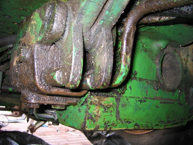

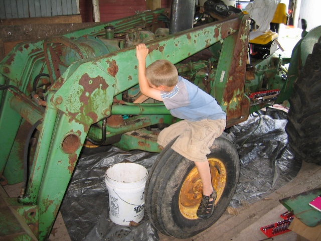

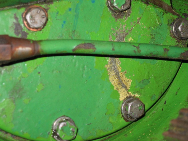

Spent a good bit of time yesterday taking some things a part and scraping all the thick stuff off. We filled almost 2 5 gallon buckets just from the operators platform and around the loader posts. We started to get in around the fuel tank, but ran out of time. Its really heavy in there. I found the source of what I believe to be the main fluid leak...a cracked cover plate. I'll be ordering a replacement tomorrow, and will replace the plate when I do the fluid change.
One one side of the radiator, the support piece has been broken away. How much of a concern should this be to fix?

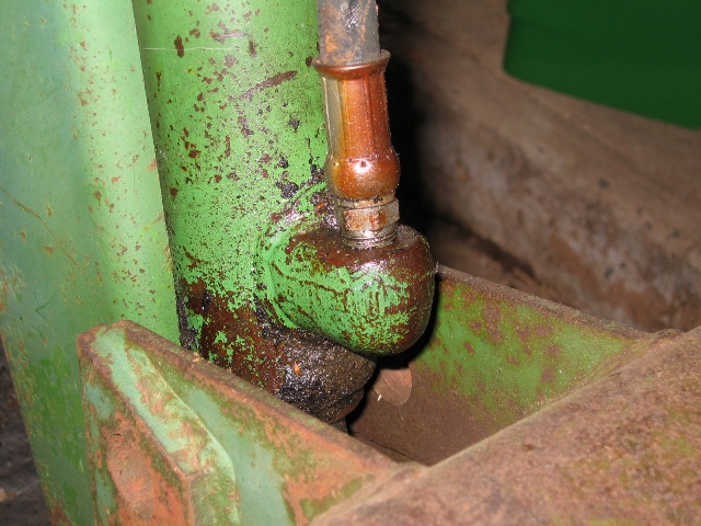

I'd like to fix 2 other leaks while I have the fluid drained. One is coming from the loader control valve, and the other is one the bucket. The bucket leak may just need to have the fitting removed, cleaned and tightened down. It looks like its a bit out anyway. Opinions on the control valve? I'm thinking my best bet is to clean it off real well first because the leak could be coming from several spots. But if someone can tell from the pic, it would be nice to order the parts at the same time.
The last pic is of a line next to the brakes. I believe this line attaches to the clutch housing. It looks like its been dented a couple of times. Should this be of any concern for flow rate?

   / Bought a farm, looking for a tractor...and help choosing! #118
post a very detailed pic of the damage... my clarivoyance powers are on the blink right now :)
unless you are talking about the piece unsoldered from the tank.. in which case.. that's easy.. it's a re-solder job...
soudnguy
#119
Ah solder...duh! Any particular kind I should use? I've never had to work on a radiator before...and really don't want to screw it up with the price tag on a new one of those!
   / Bought a farm, looking for a tractor...and help choosing! #120
stuff you might normally use at a shop is usually the high diameter acid core.. though for that repair the plumbers no-lead solder pack that comes with the paste flux like you see in the lil sweat solder packs at walmart and hardware stores will be fine.
sand or chemically remov ethe rust.. then sand and clean up.. get it bent so under no tension.. flux the bajeebers out of the 2 parts. tin that piece of steel first.. then lightly tin the rad.. keep as much heat away from the seam as toy can.
remove cap so no pressure builds up otherwise it will blow the joint out. I might even leave coolant up to the level of the seam.. flux it up again.. put heat to it and then as soon as it wets.. join and back the heat away, holding the part steady till it dulls over.
just like sweating a pipe...
as for flux.. can't ever have too much. if you think you ever have too much flux on a joint, add a lil mor ethen go for it. flux is your friend when soldering...
