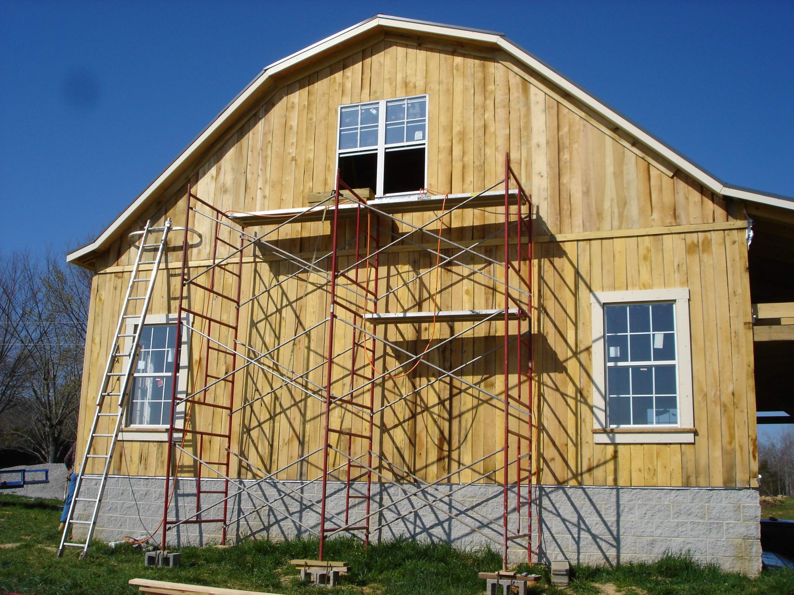

I have a slope similar to yours, and blocked the scaffolding to accomodate. I attached a picture of the way I used it, anyway.
Since using it, I found out that I should have attached it to the building instead of using it FREESTANDING (what a dummy). You can see that I used concrete blocks along with rebar (to keep it from sliding around). I'm sure there's a better way than the way I did it!
An acquaintance's two-man crew recently was using some scaffolding, and they decided to add a ladder on top for a little more "reach." Well, the scaffolding was not attached to the building, and the ladder pushed the 20' high rig away from the building, killing one and causing head injuries to the other.
Work safely.

Bbowman -
Thanks for the pictures! That is a really nice looking barn (not to mention, some really nice looking land that surrounds it.
Using the blocking on the scaffold makes sense. I will have to do something similar. Agree that attaching it to the building is the way to go. I try to be pretty 'smart' when it comes to working at a height.
Since my farm is fairly remote, I always worry about taking a fall/getting hurt. Remote property has its pro's and con's. Con's would be access to medical if needed <gg>
