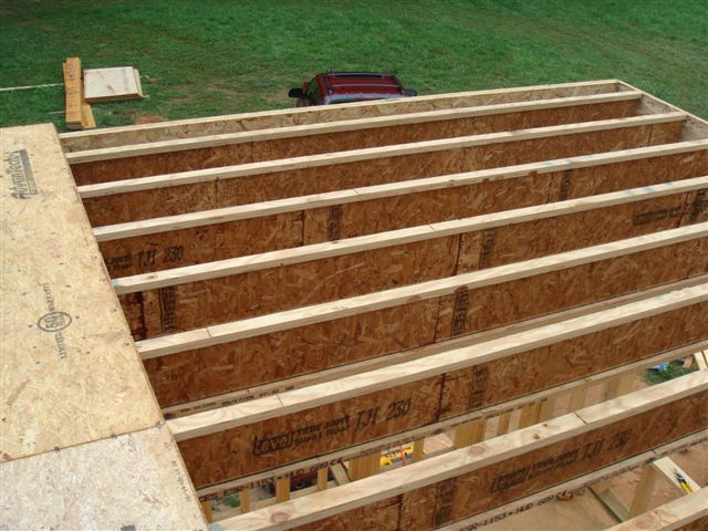

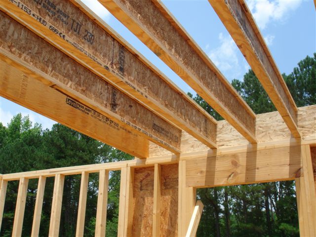

Anyway, here are some pictures of the second floor joists.
These were fairly easy to put up. They are 16in OC and rest on the first floor top plate. Mostly this was just ladder work.
The plans also called for a double LVL/GlueLam. Getting this thing up was another story. I basically rested one end on the top plate and then went up the ladder with the other end on my shoulder.
I was concerned for a few minutes that the 6ft fiberglass ladder did not want to cooperate, but it held for the few minutes I needed it to.

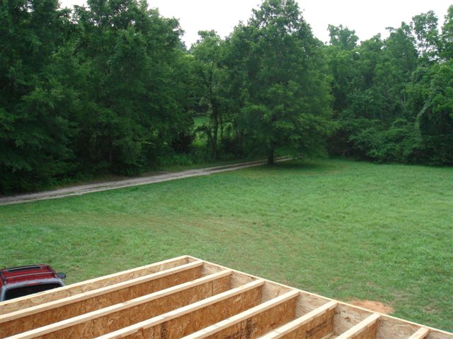

By far the hardest part of the build so far, was getting the subflooring installed on the second floor. The second floor was too tall for me to lift the panels up with the tractor bucket, so I was forced to carry the Advantech sheets one-by-one up a ladder.
Maybe I am a wuss, but I think Advantech is **** heavy - especially when trying to sling it on to a second floor while balancing on a ladder. In hindsight, this was probably my biggest area of not working smart so far.
However, it was nice to stand on the second floor and look out into the field as I worked.
These will be the last pictures for awhile. I will post some more as I get the second floor complete.
