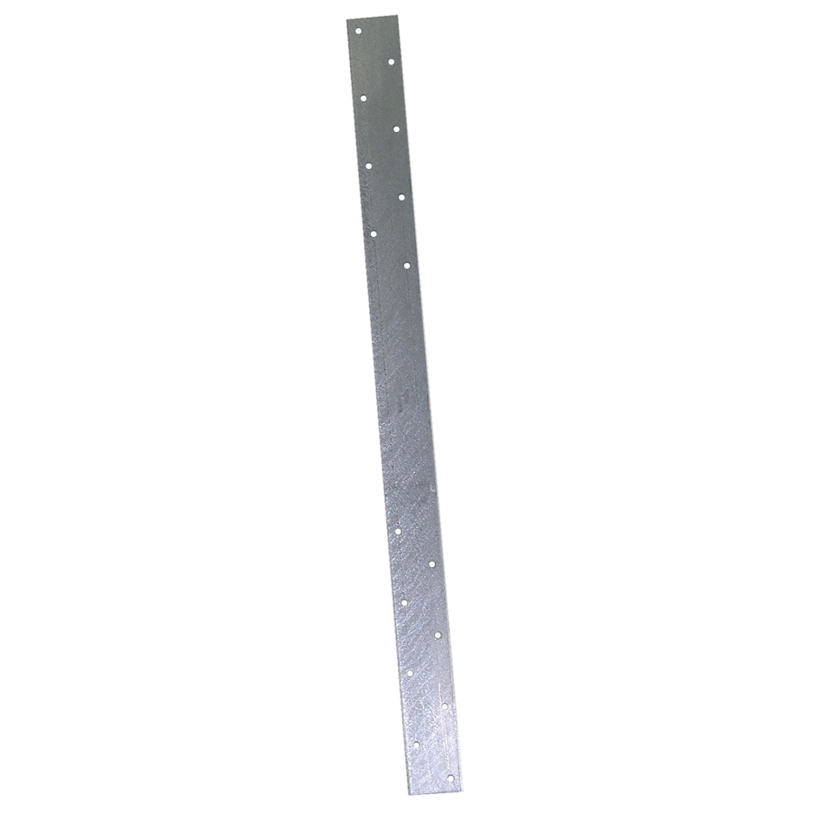

In the lumber section of Big Box stores, usually near the PT lumber, you'll find structural steel brackets in various shapes for tying joists, rafters, beams and posts together as well as mending plates and other materials. In that area are longer straight straps about an inch or so wide in different lengths. Those are thin enough to easily bend into whatever shape(s) you want and strong enough to hold anything you'd want to mount to these bars. They're steel so they're prone to rust if left exposed, but can easily be painted or coated. A piece of rubber or weatherstrip under will protect the painted surfaces.
The stuff is inexpensive enough that you could make several for $20 or less including SS or galvanized bolts and nuts.
This one is 25" - 16 Gauge for $4.00, but many in 18 Gauge are priced lower.
If you were careful enough, you might even be able to weld tabs or ears onto them to mount accessories at different angles.
Lowes Item # 140729 Model # KRPS28-TZ

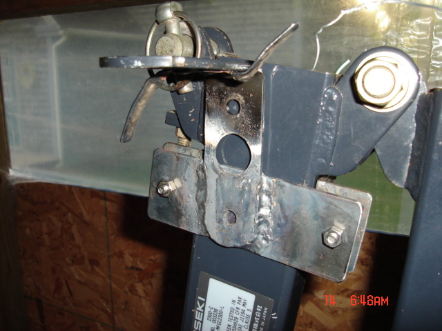

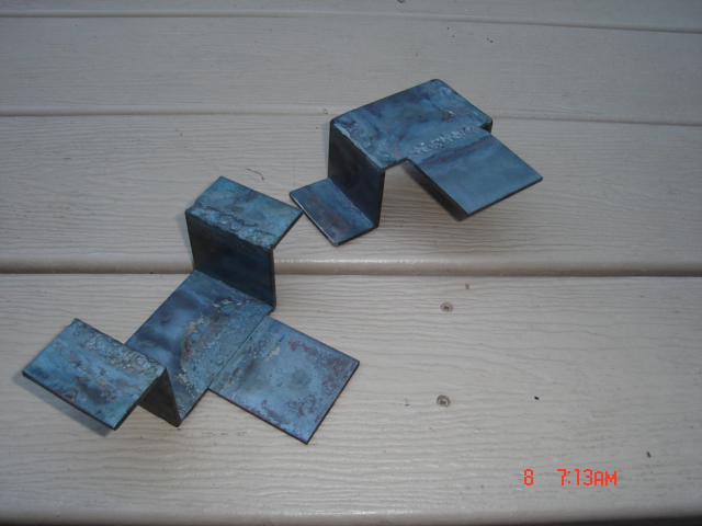

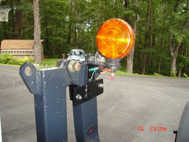

I had a local metal shop cut me some pieces of mild steel strap (1/8" x 2") and welded them together to make a clamp affair to mount the ROPS lights on the inside. Easy to do and they work well. I used existing "mickey mouse" light bolt holes, but they could be placed almost anywhere with some cushioning grip surfaces installed. Primed & painted afterward.

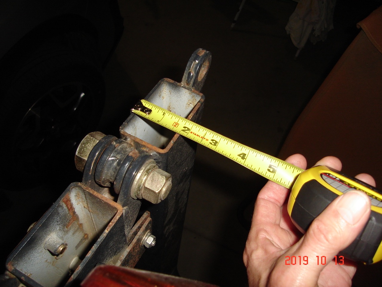

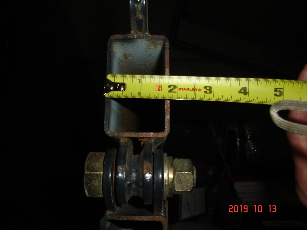

So, Ken -- they'll work on our mini-tractors' 1-3/4" x 3" ROPS?
/ Brackets for ROPS #11
Every "mini" tractor I measured at the National Farm Machinery show was 2x2 or 2x3 except for the new gen2 JD 2025R, it had a 2-3/8" square ROPS. If yours is indeed 1-3/4 then yes it will still clamp on but you'll have a 1/8" gap on each side of the 2" dimension.

Yes, it's 1-3/4" wide... I suspect it's because the 2310 has a foldable ROPS. Don't know about the newer 2410/2610/1710/1715 backhoe models.
