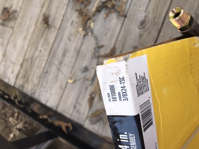

There is not a quick fix for the hose. The only thing you could do is see if Tractor Supply or any other place has a generic hose that is close in length. You would have to also buy the fittings for these as they are commonly 3/8 NPT. Using it with the leak is not a good idea. Hydraulic fluid is poisonous if injected in your skin and with high pressure that is a real possibility.

My Branson BH has JIC 6 fittings, at least on the cylinder. I don't know what's on the valve end but chances are good it's JIC too. You can ask your dealer.
Hoses with JIC female ends are very common.
If you have a hydraulic store near by you can bring the hose in and they'll make you a new one. I've done that a number of times. Or you can buy custom length hoses from DiscountHydraulicHose.com and stock length hoses from SurplusCenter.
Don't use NPT fittings for hydraulics if you can avoid it. NPT is designed for 40 psi water pipe not 2500 psi hydraulics.

These are pre-made hoses I was talking about. They are designed for hydraulics and you just buy the appropriate adapters to use them.
Yep. I hate those. I get hoses with JIC F connectors on the ends. If the rest of the system also uses JIC (like our backhoes and loaders) they will plug right in. If you need adaptors, they're easy to find. The JIC females also swivel (as they're being tightened) so you don't have to clock the hose, just tighten the connector.
NPT does not seal well under hydraulic pressures. I have to use Loctite hydraulic thread sealant and really reef down on them. NPT seals by deforming the threads. You can't take them apart more than a few times before they start leaking. The sealant helps but you have to wait a day for it to cure. JIC does not need to be tightened nearly as much to seal, does not need any sealant or tape, and is reuseable.

I do not disagree at all. Unfortunately these are all that are offered off the shelf at most chain stores, in my area at least. I use them all the time to limit down time and have never had a leak. For projects and planned replacement hoses, I always have them made to length and with appropriate fittings.
These certainly would be better than trying to patch a leaking hose as the OP was planning on trying.

Ericm979 and K5lwq: thanks for the info on the hose.. Trying to find a Branson one but they seem to be having a problem getting one at my closest dealer. will do what I have to do to finish up the job. that's why I was going to try and patch, But want to be safe. Its the B2 hose. Will post a picture a little later as I have another question of what its connected to. I realigned all the knobs settings for 4 wheel drive gears etc. Didn't seem to make any difference. still minimal speed in the lowest combination which would be expected but no power to speak of. The higher gears I go Its like being still in low 1st gear.
I used this fitting below on a previous repair, to connect to the backhoe bucket fitting on the top hyd cylinder. It has worked great. I have been trying to find a similar double one to make the splice but not sure if they make one. I guess I could cut the hose and install one of them on each cut end with a connector in the middle. I have one spare. The shop here where I bought this one I’ve repaired with doesn’t carry gates any more. Its always something. I Figured by the time I bought the repair fittings I wouldn’t be far off the cost of a new hose. The fittings are reusuable so I guess it wouldn’t hurt to have more spares if I can get the new hose.

You don't need a Branson hose. Take the old one off. If it's not JIC on the valve end (it is on the cylinder end), take it into a hydraulics shop and have them make you a new one. It'll cost less than buying a Branson one. If it is JIC or you can ID the fitting and it's common, you can get custom length hoses from discounthydraulichose.com for cheaper than the hydraulic shop. Or if it's close to foot increments, it will be a little cheaper from surpluscenter.
