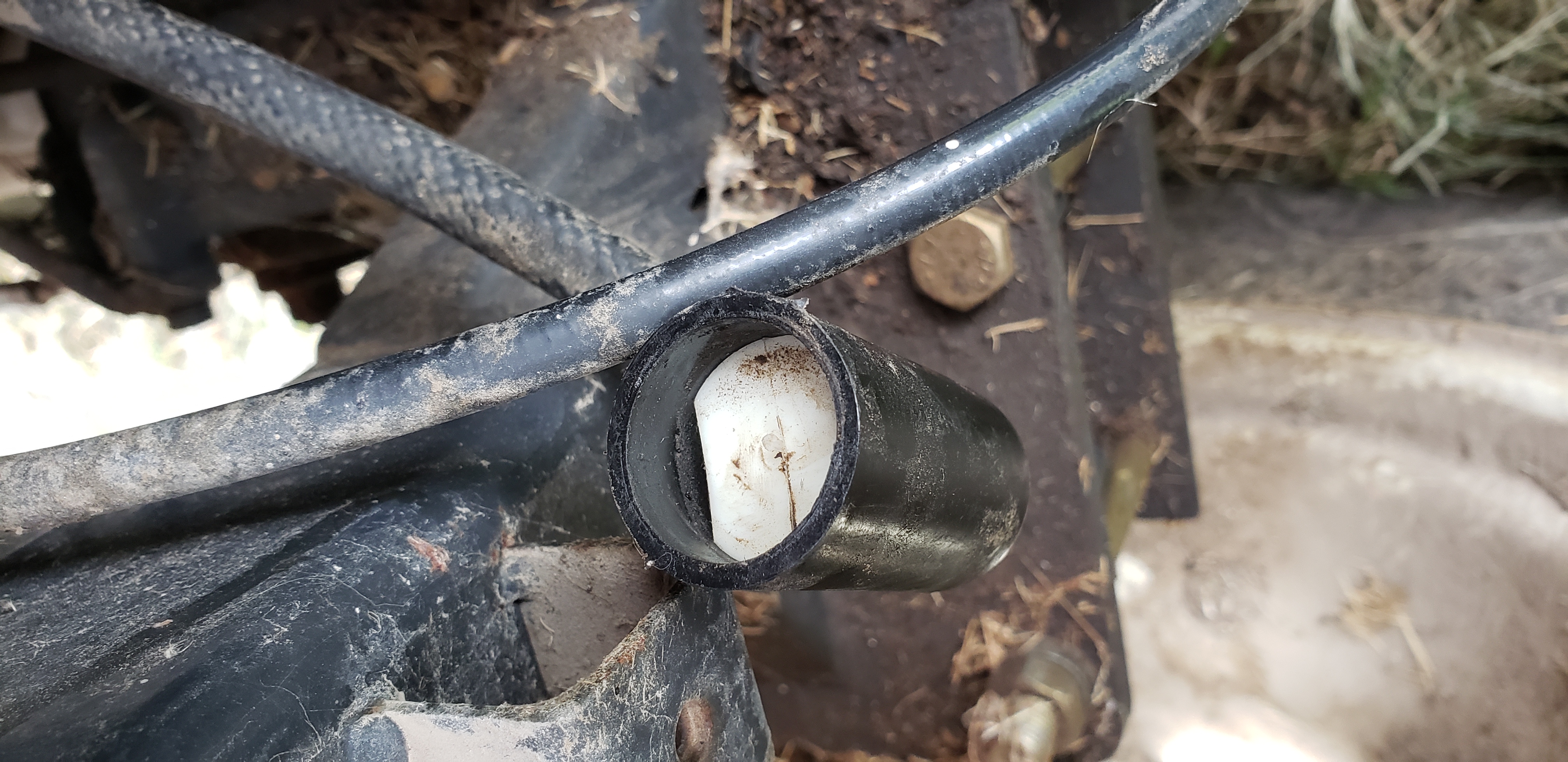

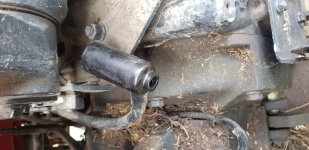

20201011_124719.jpg20201011_124702.jpgSorry guys, I came down with something right after my last post. Still not feeling real great! Tractor is still sitting in the same place.. nothing has changed haven't started it since then. Supposed to be warmer today but is really windy.
I do appreciate all the suggestions, still haven't unplugged the backhoe from the tractor.
I did do something that had a strange result... I needed to finish backfilling the work I had done so I put a SS hose clamp around the leaking hydraulic hose on the BH boom and finished up the job with the BH. It leaked a little fluid out but I think it was overfilled anyway. When I got done, I seemed to have a little more power to my wheels. Very little.. Nothing at all what it should be but was moving a little better on flat ground. I came down with a bug that evening so haven't done anything else. If the wind dies down I might go out and see if the tractor fixed itself LOL
I did notice to the left of the drivers seat under the rear wheel well were 2 small black cylinders about an inch in diameter and maybe 3 inches long one was hooked to a small diameter hose one was not Ill post a picture of it if I didn't lose it when I lost my whole post I had just made. Well I downloaded, will see if they turn out.

Anyone have any idea what the 2 black cylinders are in the above post 2 pictures
Disconnected the 2 hydraulic hoses from the backhoe to the tractor. didn't notice any drive power change. I'm curious why that would make a difference?

Breather tubes for the transmission case ?

They couldn't cause the no power problem could they? The one that you can see the screw on cap threads looks broken.
