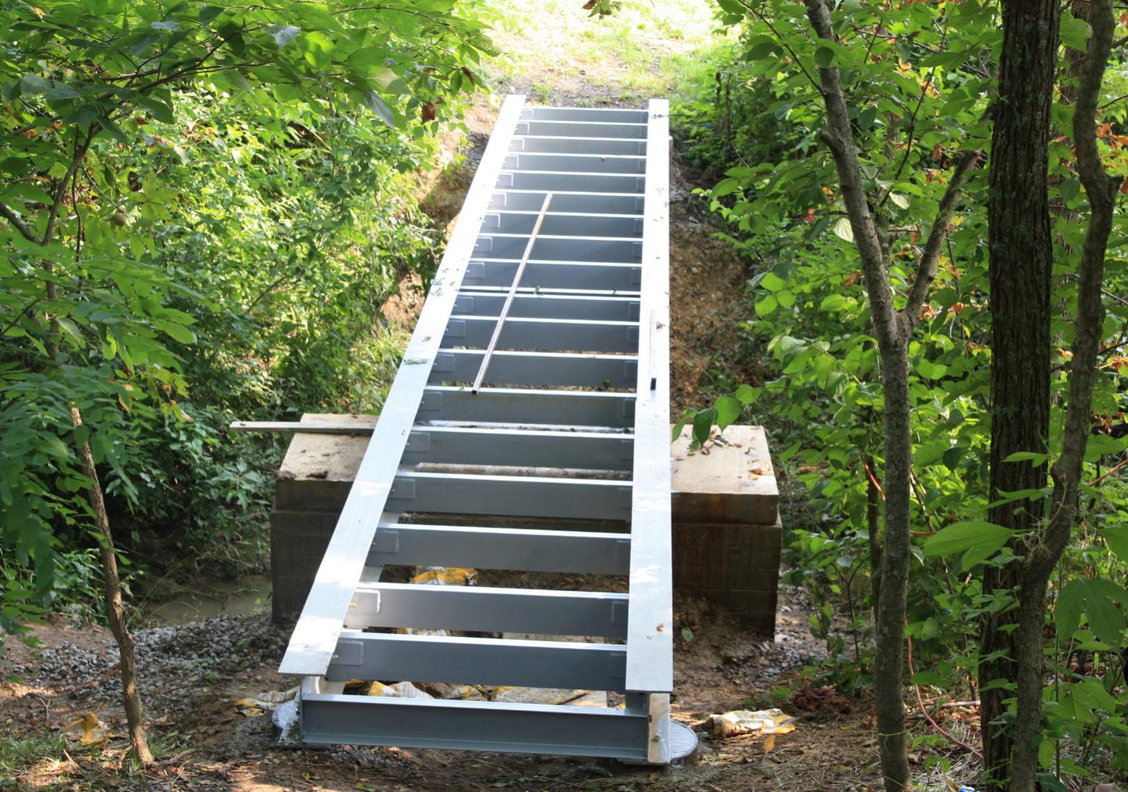

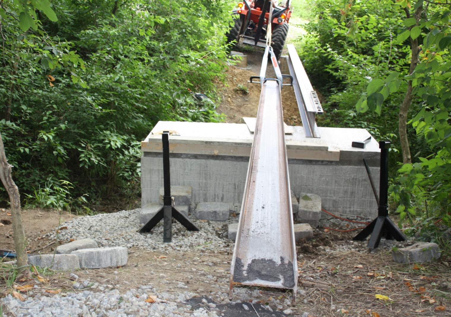

Ordered my I-beams today (should be here tomorrow). 2- 25 footer's and 2 ten's. They are structural steel beams. They are rated to support 4,000 pounds each in the center. I had the pro's to figure it for me, so there would be "less" drama. (hopefully). I still welcome any feedback from any, and all peeps. The numbers are...W 10" X 22# A-36 STRUCTURAL STEEL BEAM, 10.17" Height X .240" Web x 5.75" Flange Yard. Weight... = 550 pounds apiece. My metal guy knows his s#@t.
Now you are using your head. ;) That 4,000 Lbs, is that the total Gross load or the Live load, tractor, you and a 6 pack? What about the safety factor, how much over weight to make it break?:eek:
   / Bridge#2 #62
Some drilling, but I plan on putting wood runners in between the I-beams.
Be very, very careful where you put holes. A hole in the wrong place will %$#@&& the steel and down you go. Welding would be a better choice.
Something to think about. The bottom flange is in tension and the top is in compression. Where the Web meets the flange is in sheer, the two trying to slide past each other. You may drill a hole up to 1/3 the distance up/down from the center of the web. Again, safer to weld.

Thats 4,000 lbs each, gross, plus the supports in the middle will make it stronger yet.

I have to disagree with you on the welding. I am a welder, and have the means to weld it (mig, stick, or tig... i have all three). It would have been so much easier to weld it vs. drilling 3/4" holes (bunches of them). I talked with professional iron-workers, as well as engineers at work, and my steel supplier, and all three told me the same (which was what I thought) that properly welding them, the heat would weaken the beams more than drilling and bolting them. I personaly think welding them would have been fine (as did they) but bolting them was..is stronger. Tractor, me, and a 12 pack are more worried about running off the side. I'm not saying you're wrong, and I like your input, you keep me on my toes.
When you drill a hole in a member and load that component, say in tension the force per unit area on the average doesn't change all that much. However close to that hole the force per unit area increases dramatically and may excide the strength of that metal and start a crack. Over time that crack will grow. The size, location and number of holes matters, it's a big deal subject in any civil engineering training course, as is metal fatigue. Better to be safe than sorry.

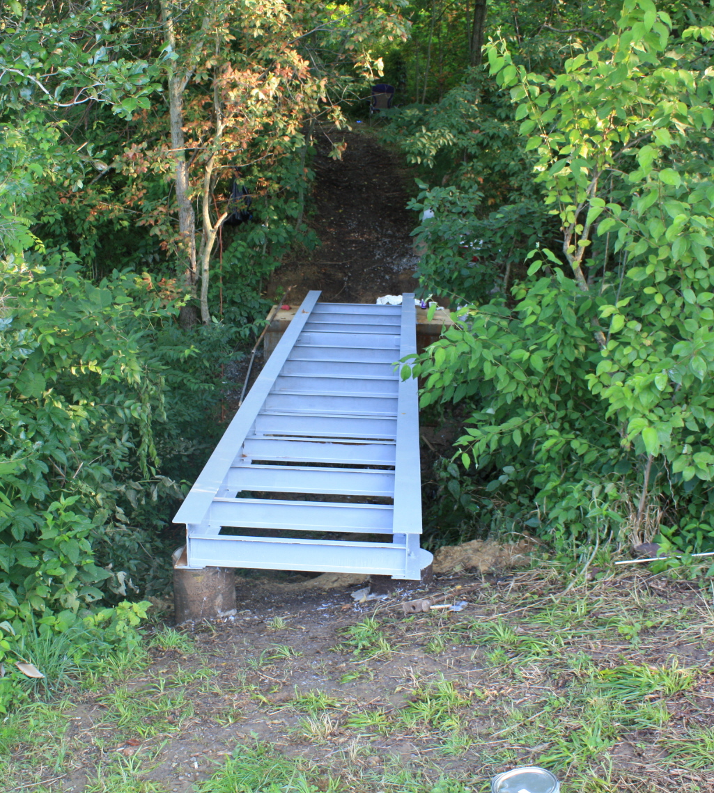

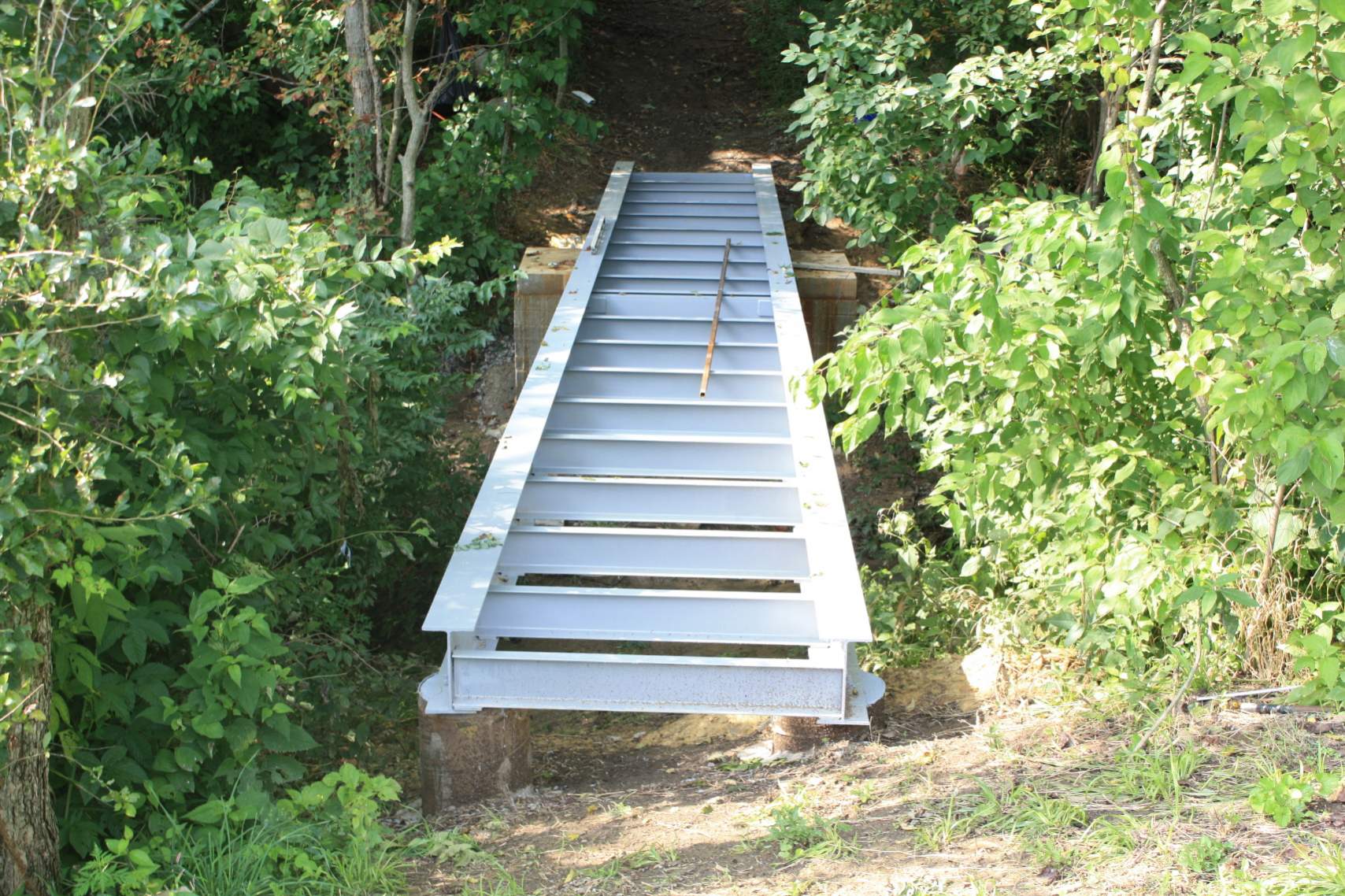

One of my dogs (Pepper) walked across the bridge today, so I know its safe. Her sister (Salt) wussed-out and went under. I wish i'd had my camara with me. I was amazed to see her walking across the I-beam with one foot on it, and the other on the 4x4. Its over six feet off the ground in the center, she was brave. I got the first 5 planks down today (with the shims in place) and it looks like everything's going to work out. I used hard rubber belting material for the 1/8" shims, and it worked great (Bud approved... my boss...pic attached). He is the man. We have four dogs, and one cat for those who are counting..lol... they are all mutts...the best kind.

Leave the 1/8" alone - that will be your crown so the water rolls off!
You're prob. right...but...I can't stand to look at the curve.

That treated lumber will shrink as it dries out over the next few months. I'll bet the 1/8" will be gone by then. You could get rolls of the rubber/tar window flashing they use for building houses and roll that on top of the beams to save time if you think the wood won't shrink. It would be good protection for the beams anyway. The builders used that on my pole barn for every area steel was going to contact the treated boards (along the skirt, up posts, etc). The bridge looks great. Can't wait to see it when it's done.
Thanks for the idea.
