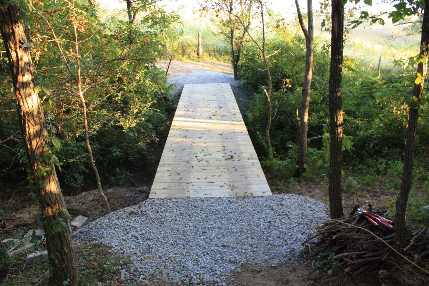

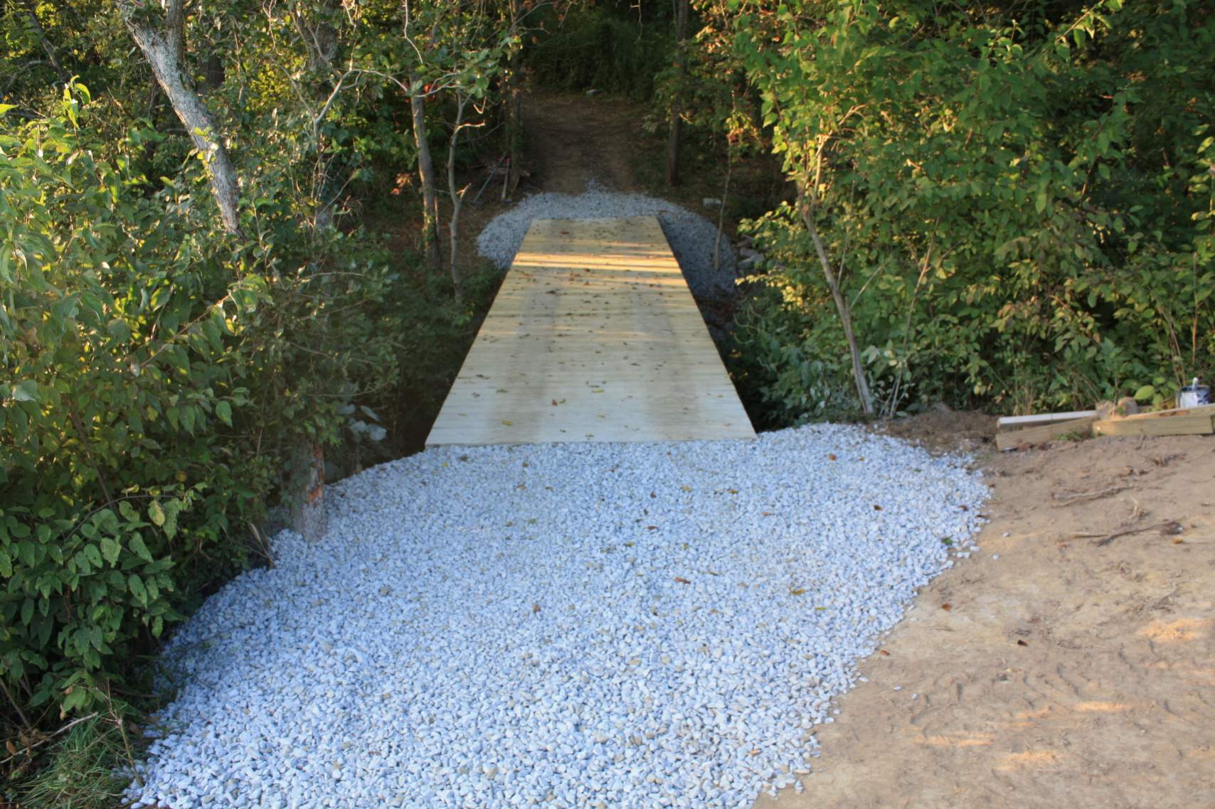

Hauled 8 ton of gravel (57's) today, put about 6 ton on the long-end of the bridge. I made lots of trips across the bridge with the fel loaded with gravel. No problems at all. I finally got to drive all the way across it. I'll let it settle some, and then put the finishing touches on the backfill. I may start on the rails tomorrow, not sure how i'm going to do them...any ideas?

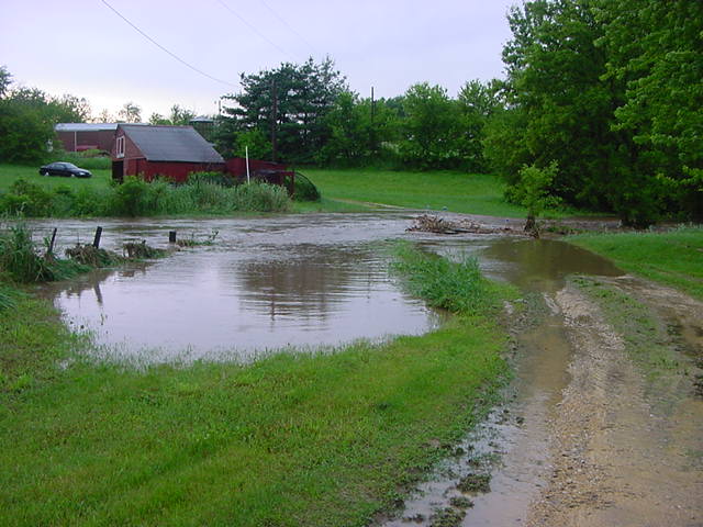

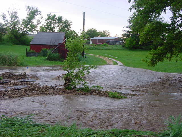

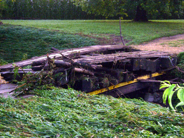

I am in the process of getting ready to do a project like this on my property. I was thinking culvert, but it will still flood, so I am going bridge. I need to raise my road level where I cross my creek up at least 4 feet and span it about 20 foot on each side. The creek is normally about 2-3 foot wide and about 3 inches deep, but when it floods bad enough to destroy my current bridge it gets about 11 ft.+ and about 30-40ft. wide. It's crazy... I am looking to build 2 pillars about 4 ft. above ground on each side about 20ft. back from the banks, build the road up to it, span it with either the trailers or railcar, and use my current bridge for center support, so I can get to my house when flooded. Where would one look to get either 2 flatbed semi trailers or a flatbed railcar. How much will they cost. What will a project like this cost? Any ideas? See pic...

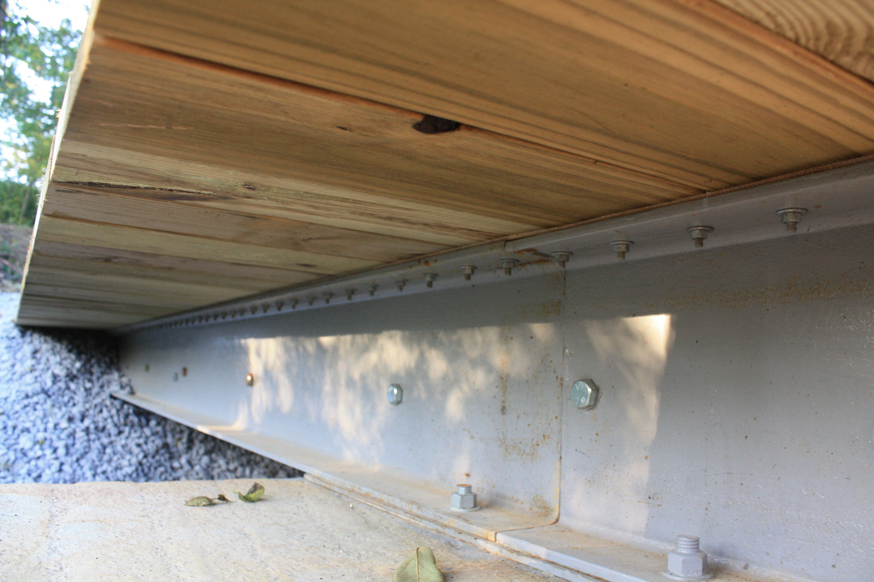

Here's a pic of all those dreaded bolts.

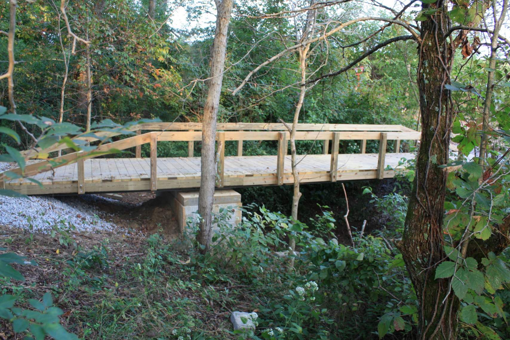

A couple pics of the other side backfilled. I started on the rails, not much done yet. I think i'll go with wooden rails kinda like my first bridge, but tapered down on the ends.

#112
That looks like a cool project. I don't have a clue about the trailers (sorry). I'll be very interested in what you come up with. Keep us posted.

/ Bridge#2 #116
You need a raft.

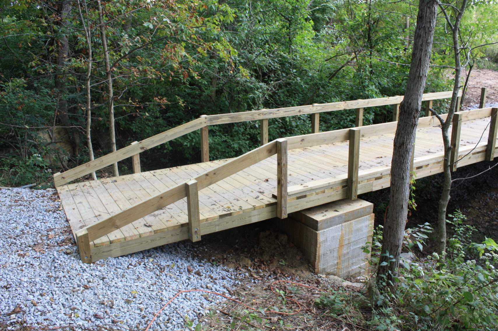

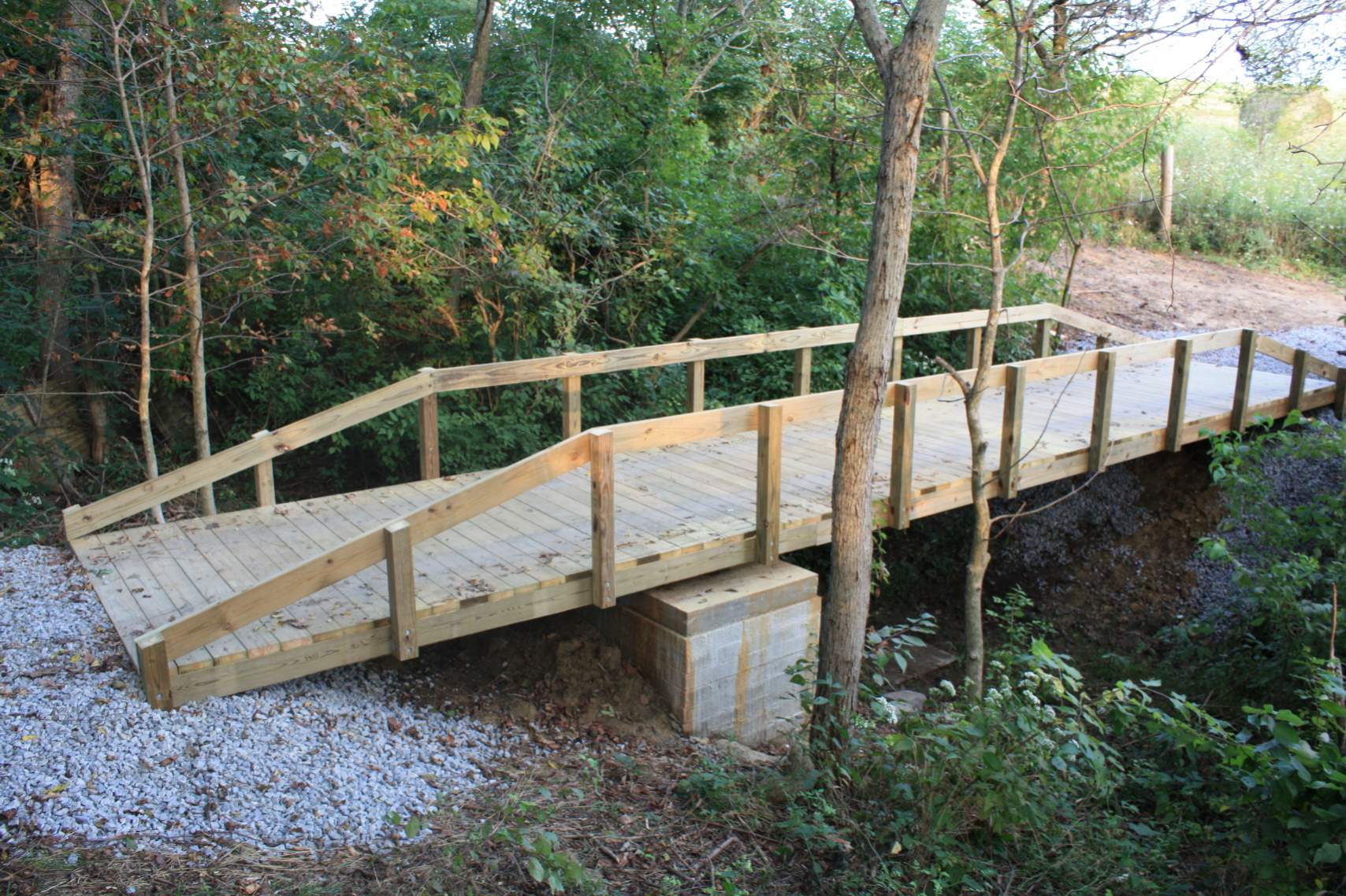

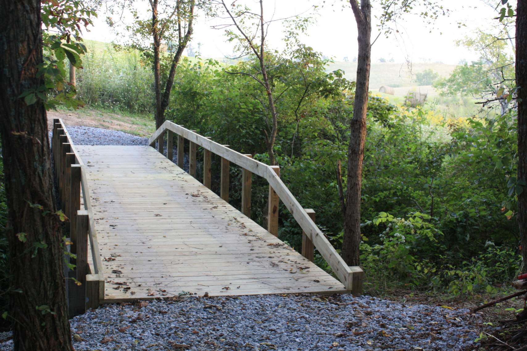

Bridge is done!!! It turned out well, i'm happy with it. I went with 4x4 posts attached to a 4x6, seems pretty strong, and I like the look. I still have some grading to do, and a few other little things, but i'm calling it a wrap.

/ Bridge#2 #118
Beautiful job there Buggy !! Really nice ! OK, . . now what about the kitchen project out there in the bush,...that still on order?
CHEERS!
. . tug
/ Bridge#2 #119
Looks real nice. I'd be interested to know how much deflection there is when you have a fully loaded machine and trailer on the middle of it. Should be easy enough to measure.
/ Bridge#2
#120
CHEERS!
. . tug
Yep, outdoor kitchen is still a go, but first i'm building a fort for my nephew (and me). The kitchen may have to wait till next spring, depends on how long the fort takes me.
