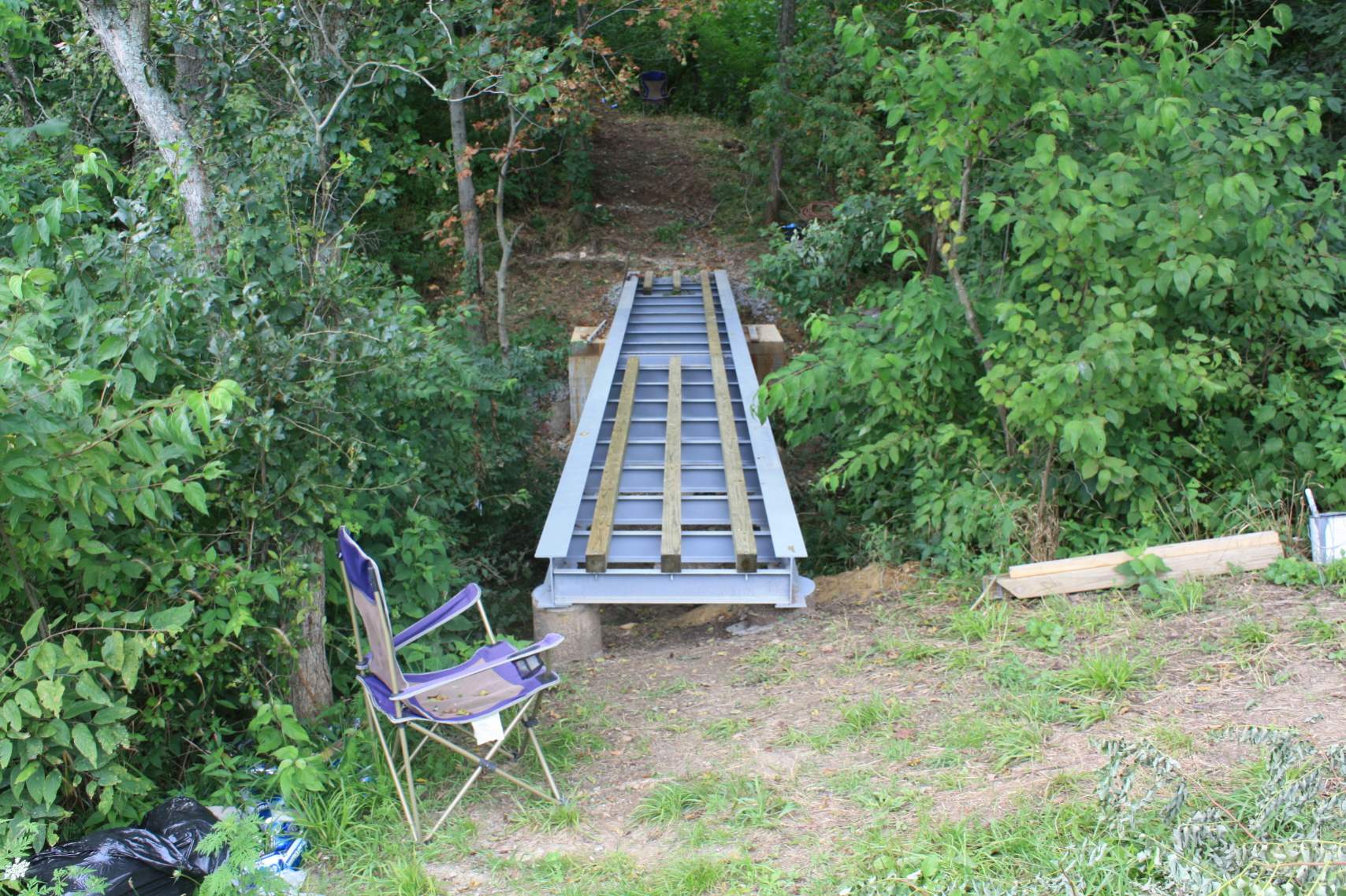

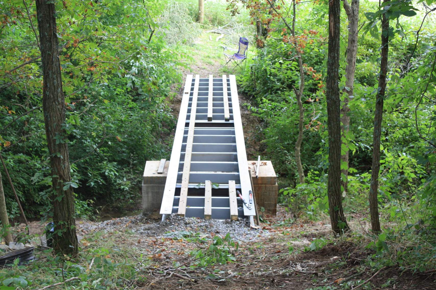

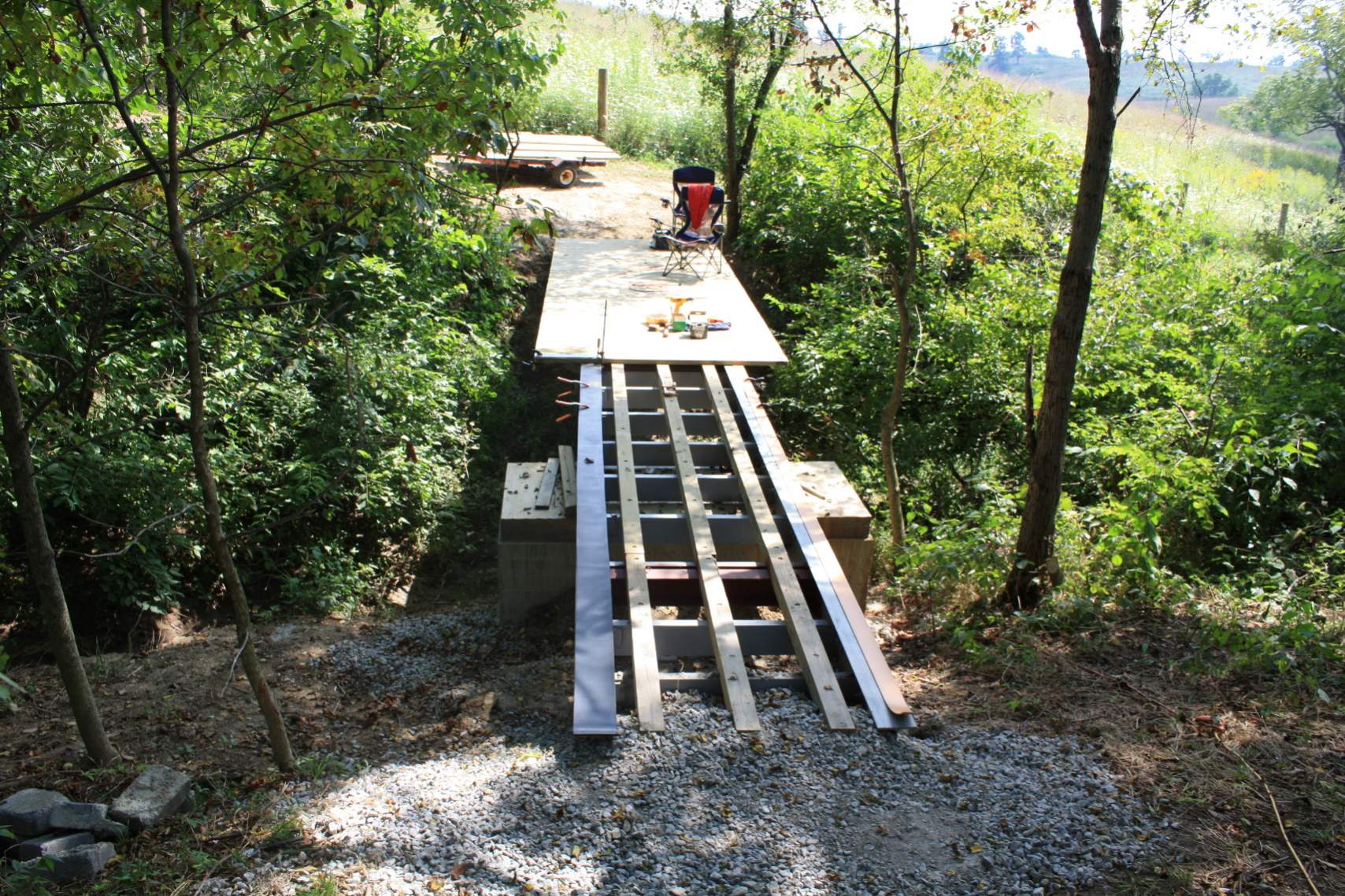

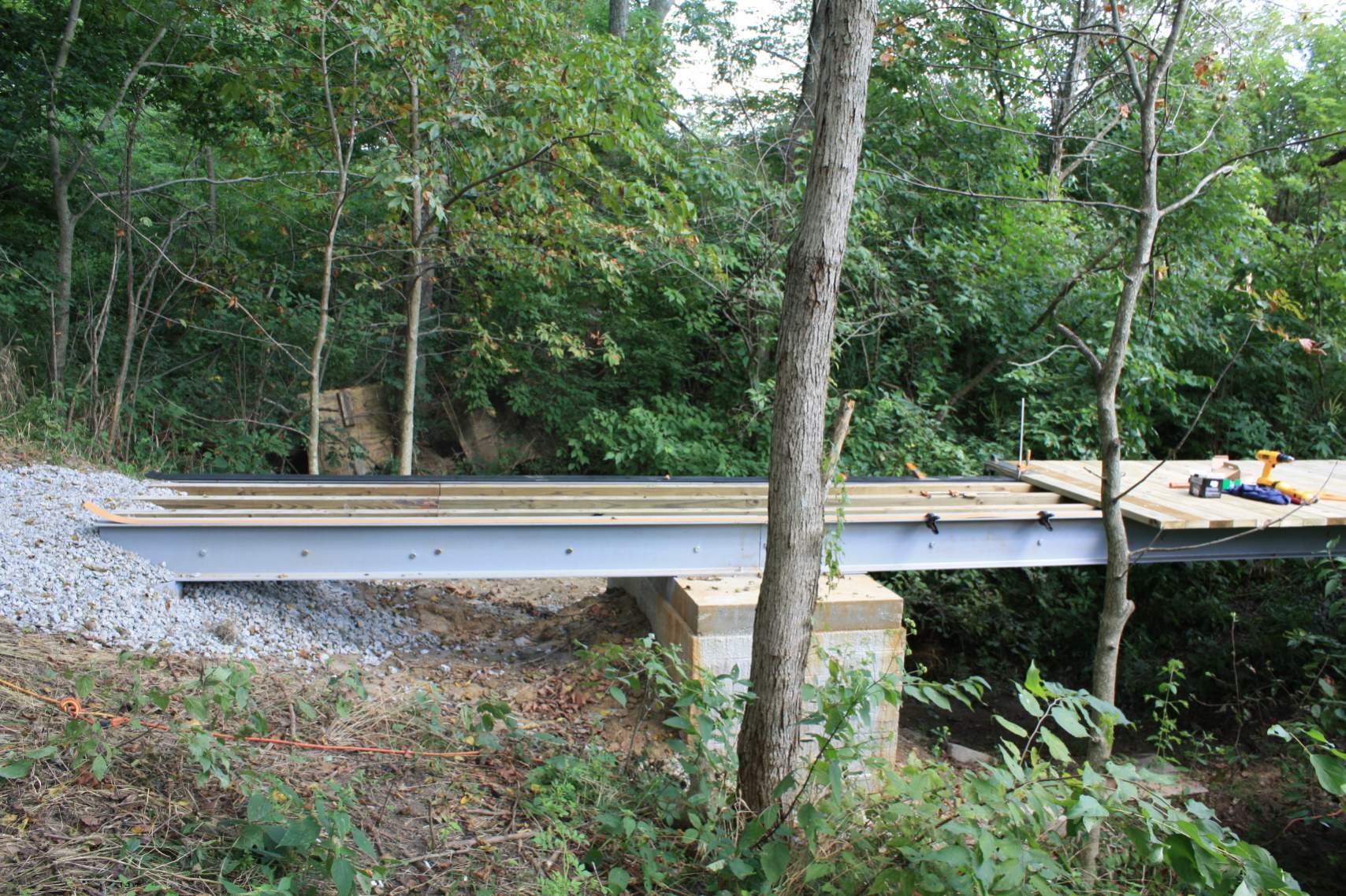

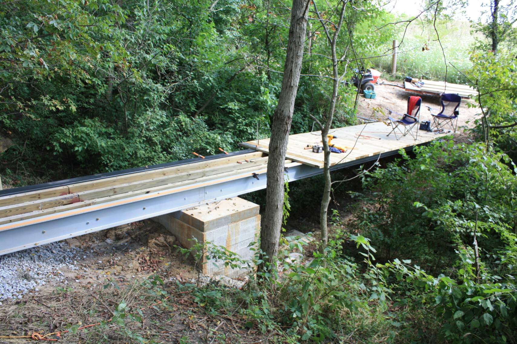

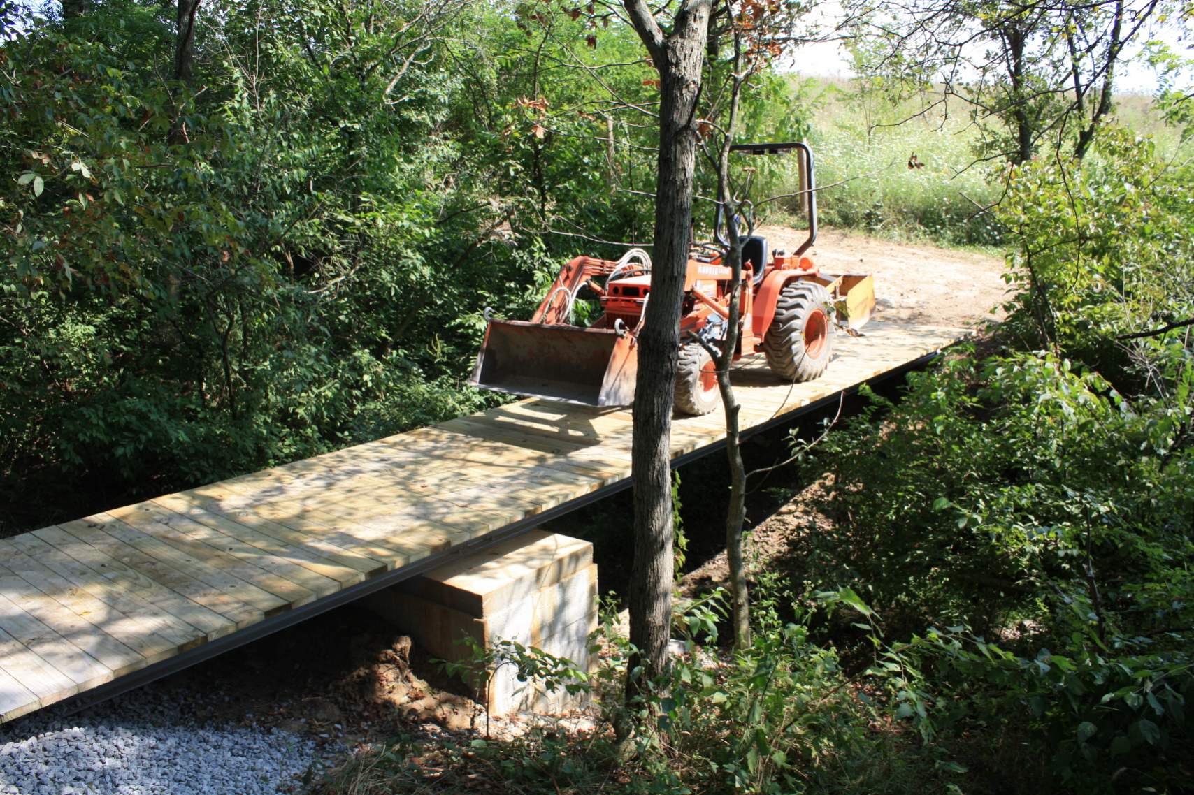

#85
Heres some pics from yesterday. I got all but the last 12 feet or so done today. It feels really strong just walking on it. I should get done with the slats tomorrow, and the dreaded drilling.

   / Bridge#2 #86
Wow! We don't have bridges that stout on our county roads!!:D Nice job, Buggyman! Won't be long before the orange machine is nicely posed in the middle of it!

   / Bridge#2 #87
Three questions. What is your budget on this? I am so very impressed and very jealous. Second, your second photo looks like the top planking is in line with the bridge (Slight going off center - slowly moving one way while the structure goes the other). I am pretty sure this is a lense aberration. Finally, where are the dogs?

#89
The 25 foot i-beams were $300.00 per, add another $150.00 for the ten footers, and around 250.00 for the channel and angle. I already had the grade 8 hardware..prob. around 300.00 for the rest of the hardware (minus one nut), the wood...i'm guessing around $600.00 so far (i still have the rails to go)...the concrete, motar, and blocks...i'm guessing about $700.00...It seems like a lot...it is a lot, but the final project..."priceless". I think the photo you're refering to is just my bad camera angle...i assure you everything is level, and square. The dogs are asleep, as i should be.

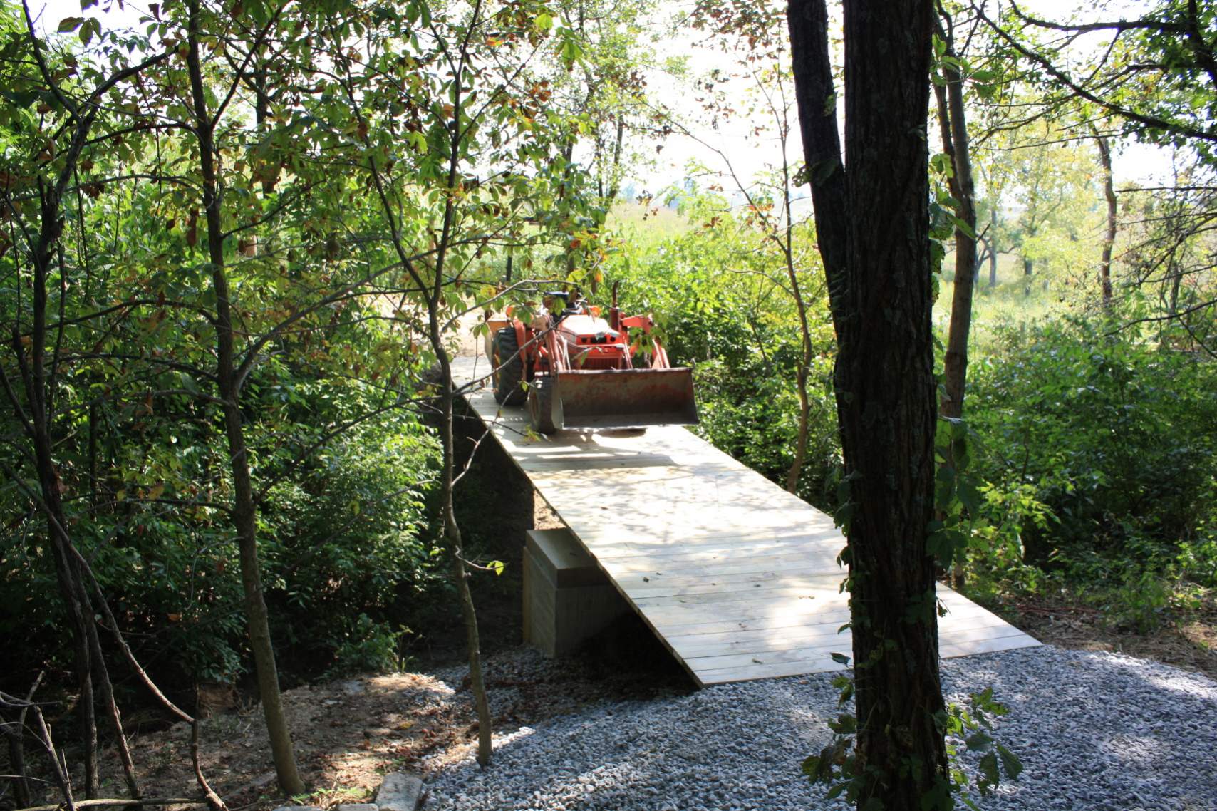

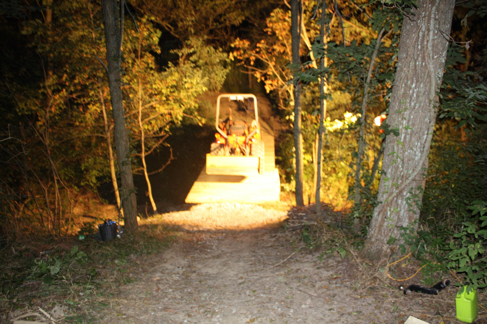

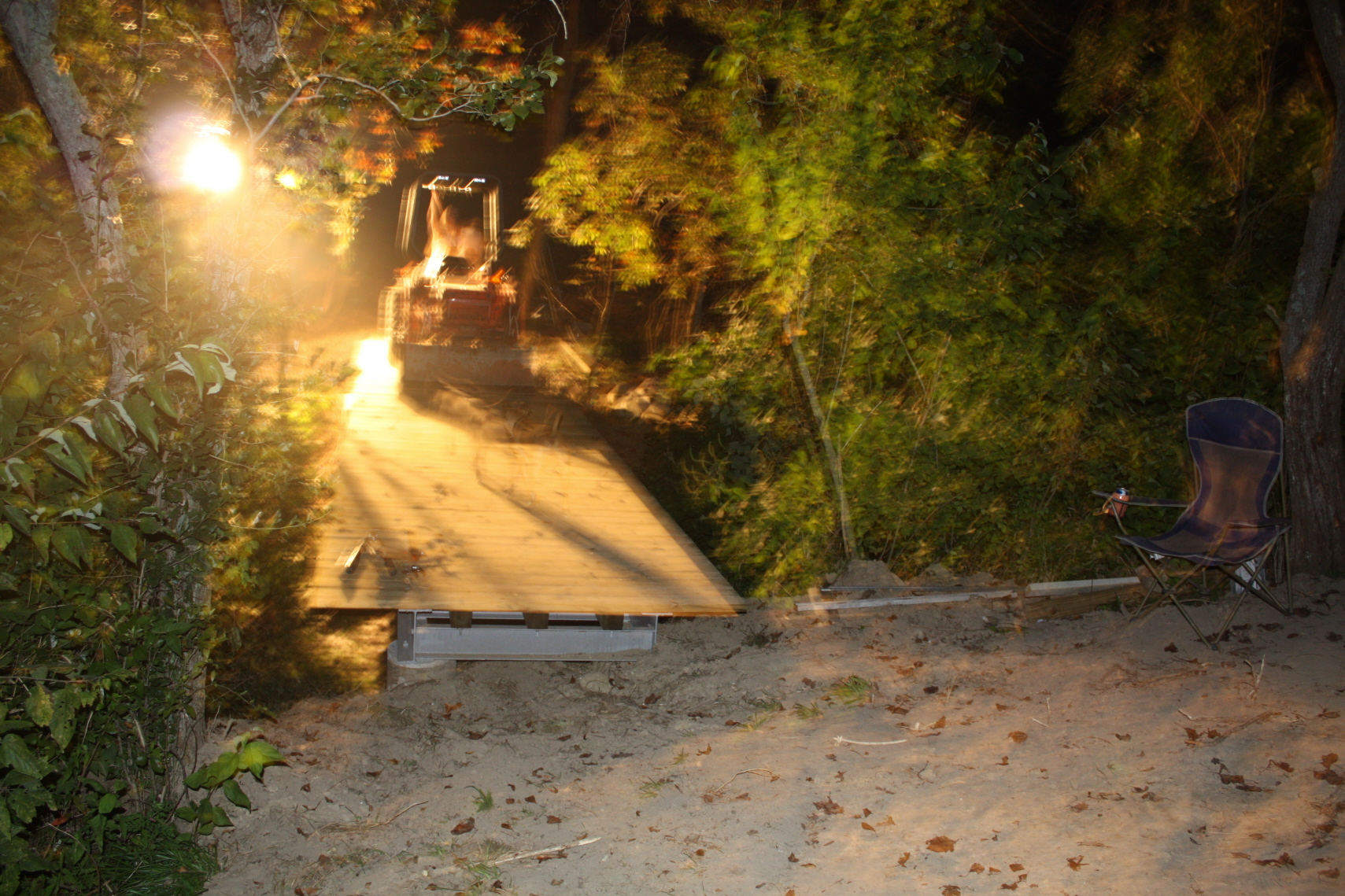

#91

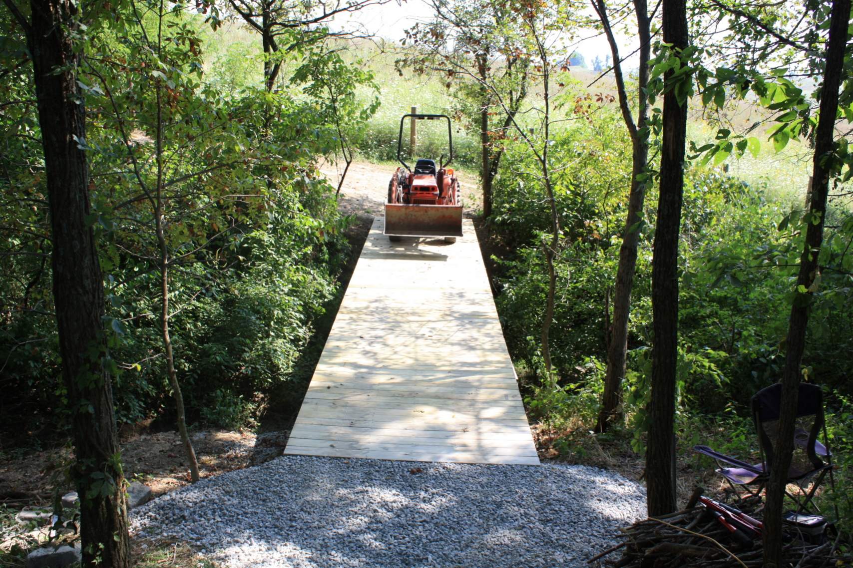

Here's a couple of pics of the first crossing (i told you they were crappy), i'll post more pics tomorrow.

   / Bridge#2 #92
I'm thinking after a couple of beers those photos will be just fine. :D :D
Wedge
   / Bridge#2 #93
Oh yea! Burning the midnight oil!:eek: I can see it now, going back to work to catch up on your sleep!:D
Looks good, Buggyman. I see you actually did pose the tractor in the middle of the bridge. Good job. I see all your "help" petered out on you! Man, that's a lot of holes to drill! How many bits did you go through or have to sharpen?

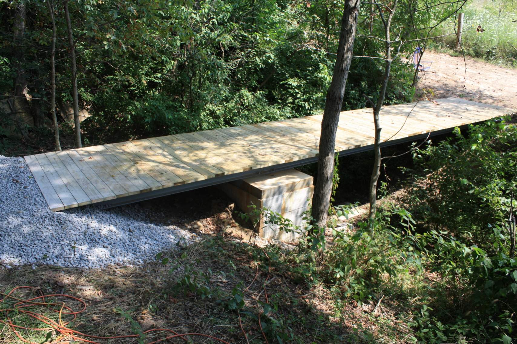

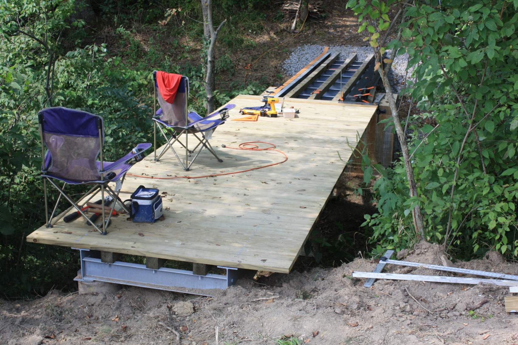

#94

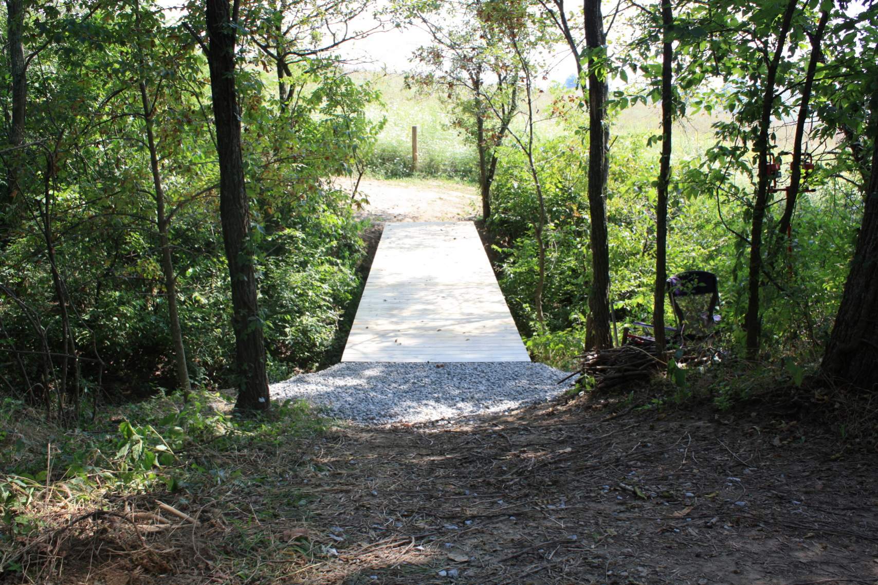

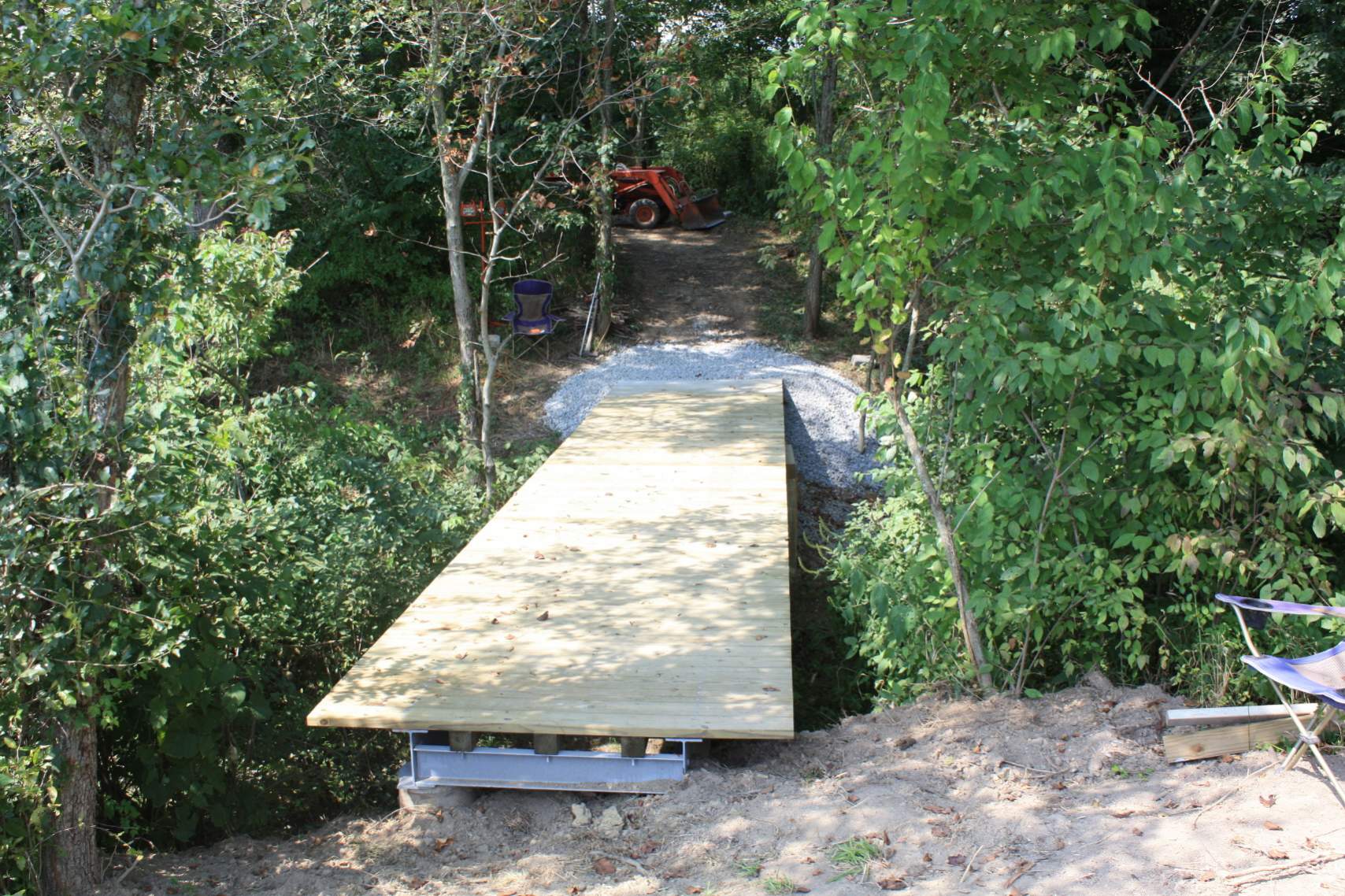

I didn't do much today, hauled a little rock and took a few pics. Here's some (hopefully better) pics of the bridge. It seems real strong, even rocking the tractor, the bridge don't move.

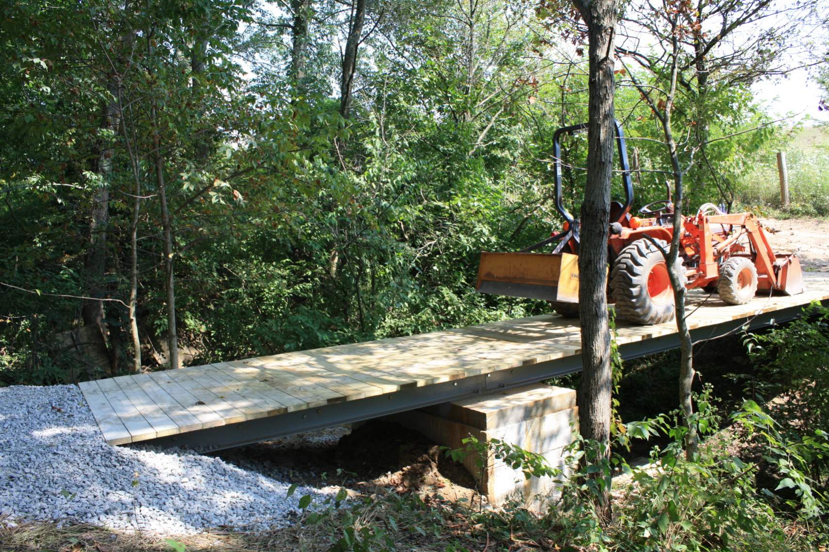

#95
More pics...with the Kubota.
