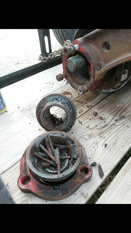

What did the existing bearings look like?
I've only taken one apart so far as it was the only one that was easily identifiable as having a bad bearing.
Here's what it looked like when I opened it up.
   / Brillion Hub and Bearings #34
When they're bad, it's easy to see because they fall out in your hand like that.
