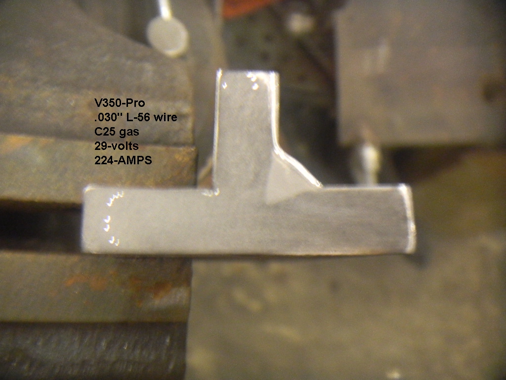

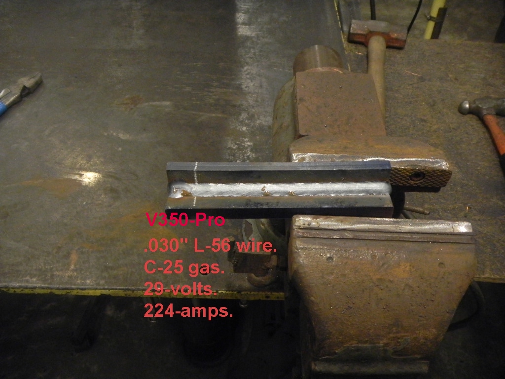

You were doing so good until you got to this paragraph. I used to have a 175 Miller. Traded it for a 250 Miller. No comparison. Much stronger welds.
If all you weld is light metal, the smaller welder is fine. If you weld 1/4" and/or above, the smaller welder will begin to exceed it's capacity and the weld strength will suffer. :)

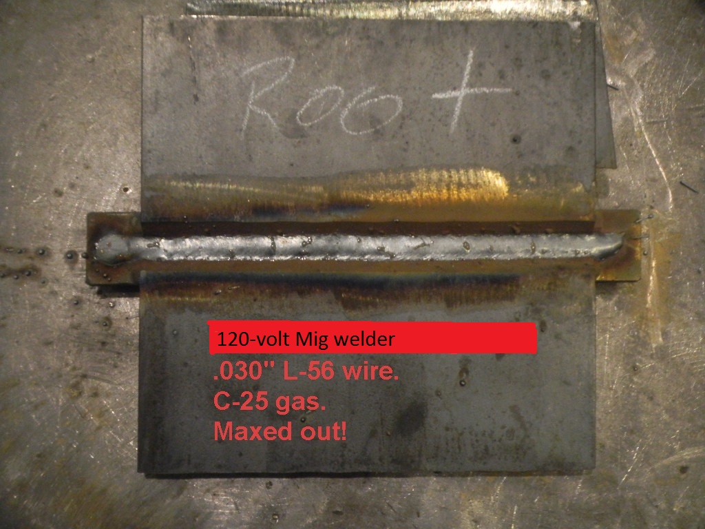

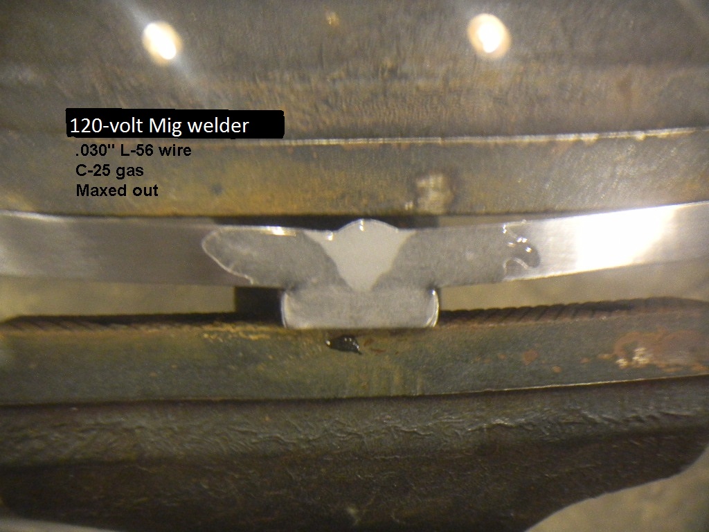

With wire feed welders, all it takes is power!;)

Here's what a 120-volt Mig welder can do.

Let me add,,,,, if you are using a light welder on heavy projects the experience and patience of the operator become paramount. A larger welder will better make up for operator inexperience. :)

As to a small mig and running it above its ability, heating the material with a torch can help the mig get better penetration, as the base metal is that much closer to the melting point.

And that's the trick the novice will know nothing about. :)
