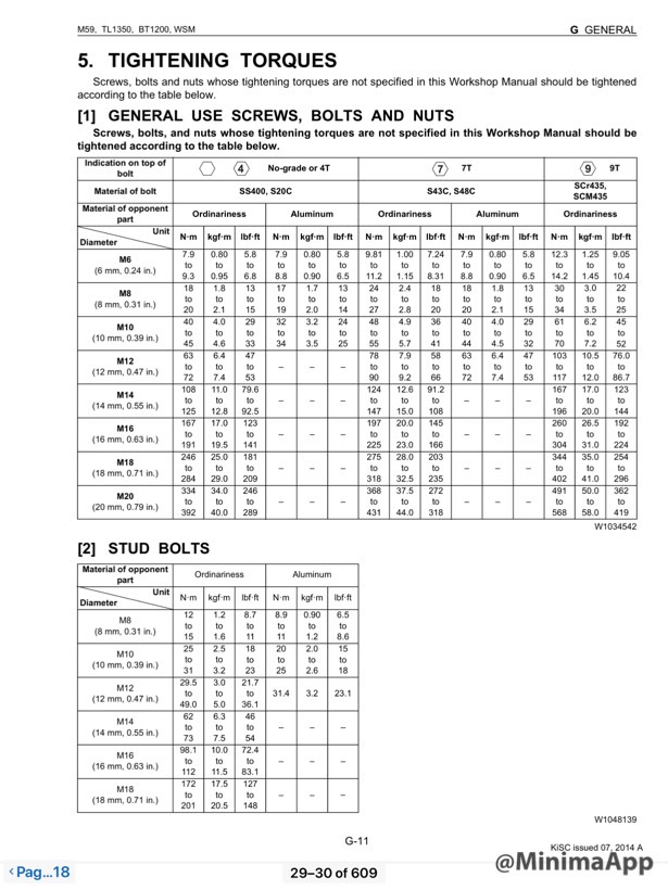

Here is the Branson torque specs chart:
/ Broken frame to engine bolts #22
Thanks for the chart Ptsg.

It appears these bolts are grade 10.9 and the bolt also has an H5 stamped on it if that means anything. They are 1 1/2 inches long and my owners manual has no torque specs.
Online are generic bolt torque specs both SAE and Metric, dry, new, and wet. Just ask the question.
#36
I have looked online for the torque specs. They seem to be all over the board depending on if the bolt is coated or black or dry or wet what ever that means. It appears from what I can make sense of is that the bolts I purchased should be around 85 ft lbs since they are coated. The plain black bolts , which I couldn't find locally, are aroung 93 lbs if I'm correct. I'm still waiting for the left handed drill bits to complete the job.

People treat torquing bolts as an exact science that has been engineered to a tee. But it isn't at all. It is an interesting subject to read up on. It supposedly relates to the holding force of a particular fastener, and it does if everything in the world was equal. However all sorts of factors enter in such as the quality of the threads, how dirty or how lubricated the threads are, if you use thread lock, if you use washers and what kind, the attributes of the fastener material. and on and on. These variables can change the actually stress put on the fastener (a measure of the holding power) and/or the limits of stress it will accept quite significantly. You are better off to use torque guides as a reference and then apply common sense from there on. More importantly is usually that a series of fasteners are tightened equally. On one extreme the fastener will loosen under use, on the other extreme it will break. You just need to be somewhere in between.
/ Broken frame to engine bolts #40
Should be a bolt torque chart in your owners manual. If not, post the diameter and thread pitch as well as the strength of the replacement bolt and I'll look it up for you.
As I recall the chart is at the very front of the manual....it's in mine.
