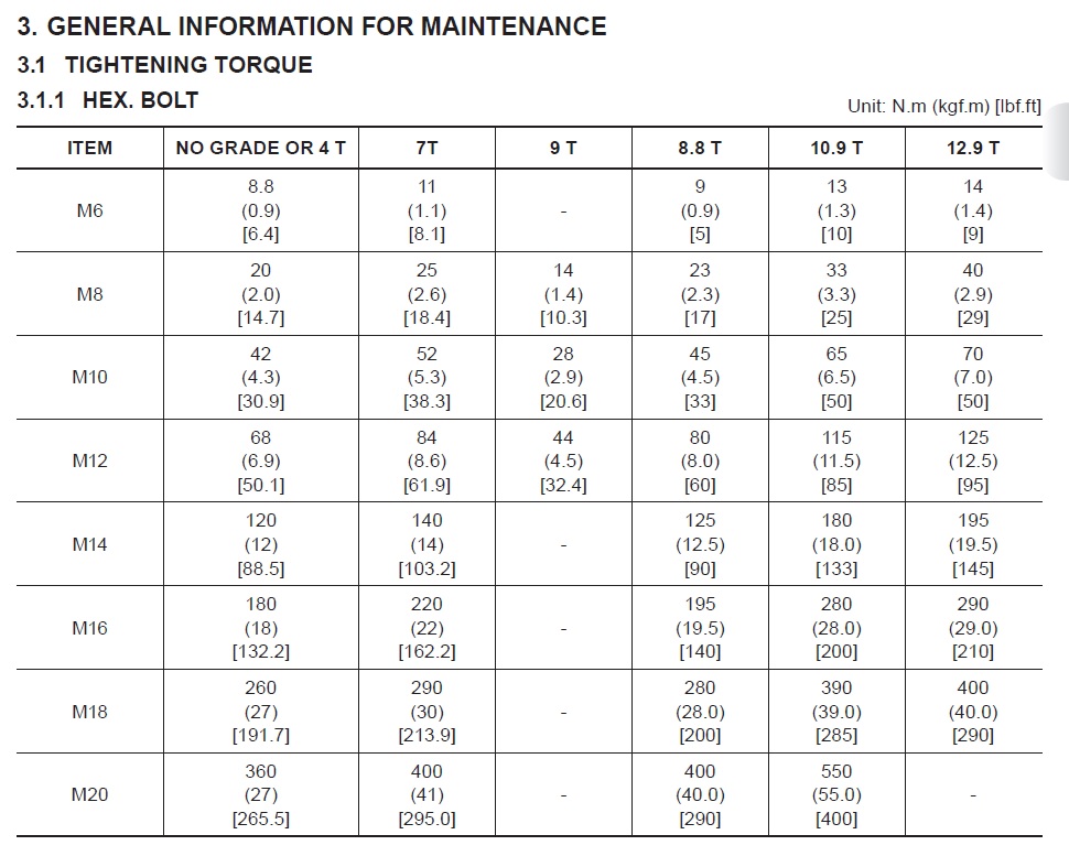

Here is the Branson torque specs chart:
   / Broken frame to engine bolts #22
Thanks for the chart Ptsg.
