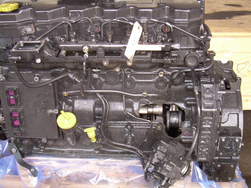

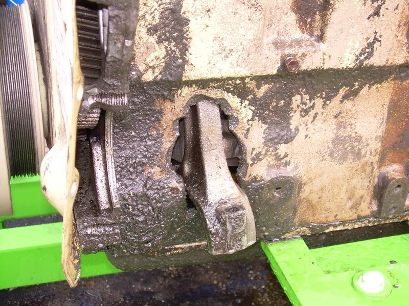

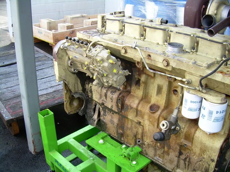

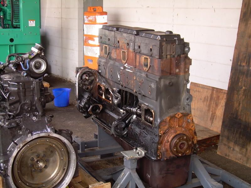

I don't know, but maybe your on to something there, after talking with some big wigs at the local Cummins/Onan dealer and them telling me no additives where needed, I found these engines out on their loading dock, some of them are brand new looking.
You can imagine these pictures caused quite a stir when I posted them on the Cummins forum.

OUCH! :eek::eek::eek::eek::eek::eek:
Is one the new 6.7's? The other looks like a 855 series (or N or what ever they call it now.....)
   / Brother n' law says off road diesel is bad #128
the one on top looks like a ISB with Common rail injection and rear gear train, if it matters.
since this thread is about fuel, how do you propose to compare rod failures with additive use or non use let alone drawing any type of conclusion based on aphotograph of a conrod hanging out the side of any engine. its probably lubrication related but that would be as far as I would go in drawing a conclusion.
somebody could have run those engines out of oil,its been known to happen. that old 855 might have a million miles on it and was being operated with low oil pressure. you just dont know.
I've also seen the EGR cooler leak enuf coolant into the cylinders of an ISB to hydrolock them and do the same thing, rod out the side.
actually pretty common for cummins to self destruct and throw something out the side, they use thinwall casting techniques in their more modern engine blocks.
seen more than one where the block was cut in two, up one side and down the other. like the 855 in the picture, broke the cam in two, pretty impressive when you consider how big the cam is in those engines, it must take who knows? pounds of force to snap the cam.
about the only thing you can assume by looking at those pictures is that cummins are not bulletproof.

I only posted the pictures for entertainment sake and not to imply anything other than jokingly starting/furthering a conspiracy theory. Man I wonder what it must sound like when one of those things blows up, when I posted these on my diesel truck sites it did cause a stir with the die hard Cummins fans of which I am one, there was about 10 blown engines out on their dock and 3 of them looked brand new, most of the guys thought they were run low or with out lube, I can't see how that could happen on a brand new motor. I'll tell you when word got back to the higher ups that I was taking pictures out back, I was asked to leave.
I still think Cummins 5.9L is the greatest motor ever put in a pick up, (not to start a war) I now have the 6.7, jurys still out on this, you should see the flame throwing going on in those truck forums, it could be quite entertaining at times.
A couple more pics just for conversations sake, the first one is the first I saw and even though I'm not a mechanic I was thinking to my self something is very wrong here. The 2nd one is another newer one with the pump still in place but the exact same damage as the other new one.

It generally doesn't sound like anything but a big bang.... sometimes drivers are obtuse and hear some loud knocking but keep on going, then you get the bang.... either way, its usually a big bang... aka..the big bang theory.... but remember, I'm just a mechanic, maybe the oil analysis guys in the white coats can give you a better technical description .
Yeah, cummins don't like it when you take pics of their stuff..
shoulda had you come by our engine shop, we got a bunch of cummins and detroits waiting their turn at the artificial reef program... tkae pics all you want, engnes are out of warranty.
