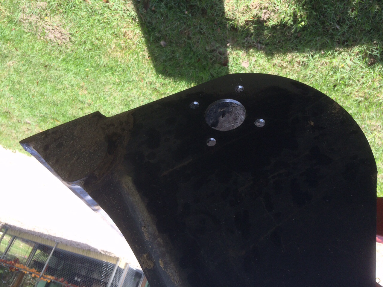

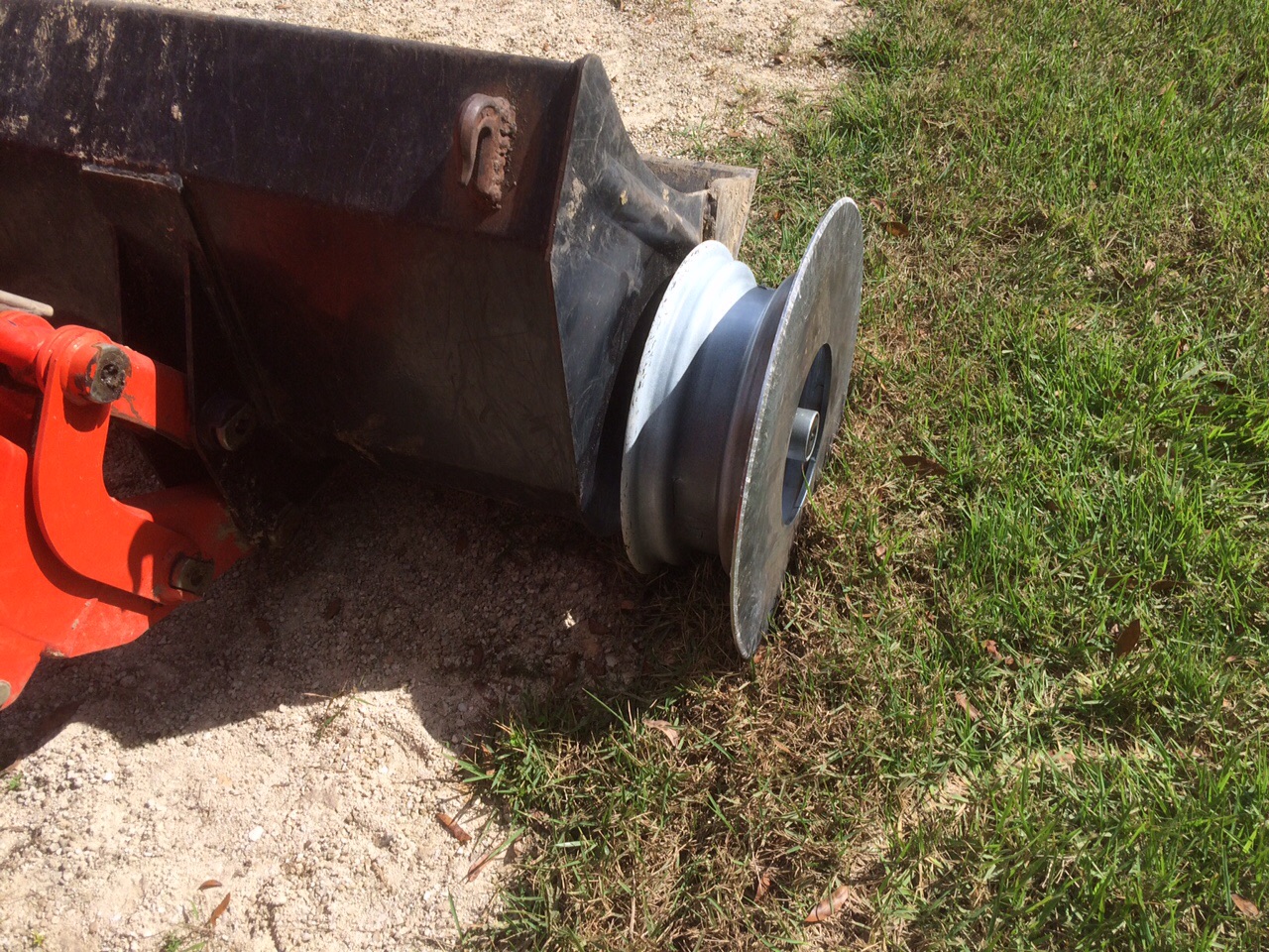

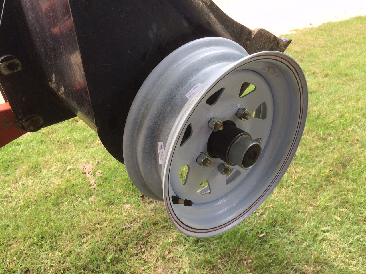

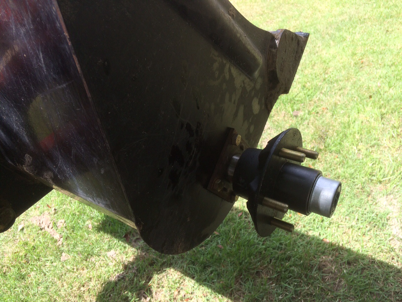

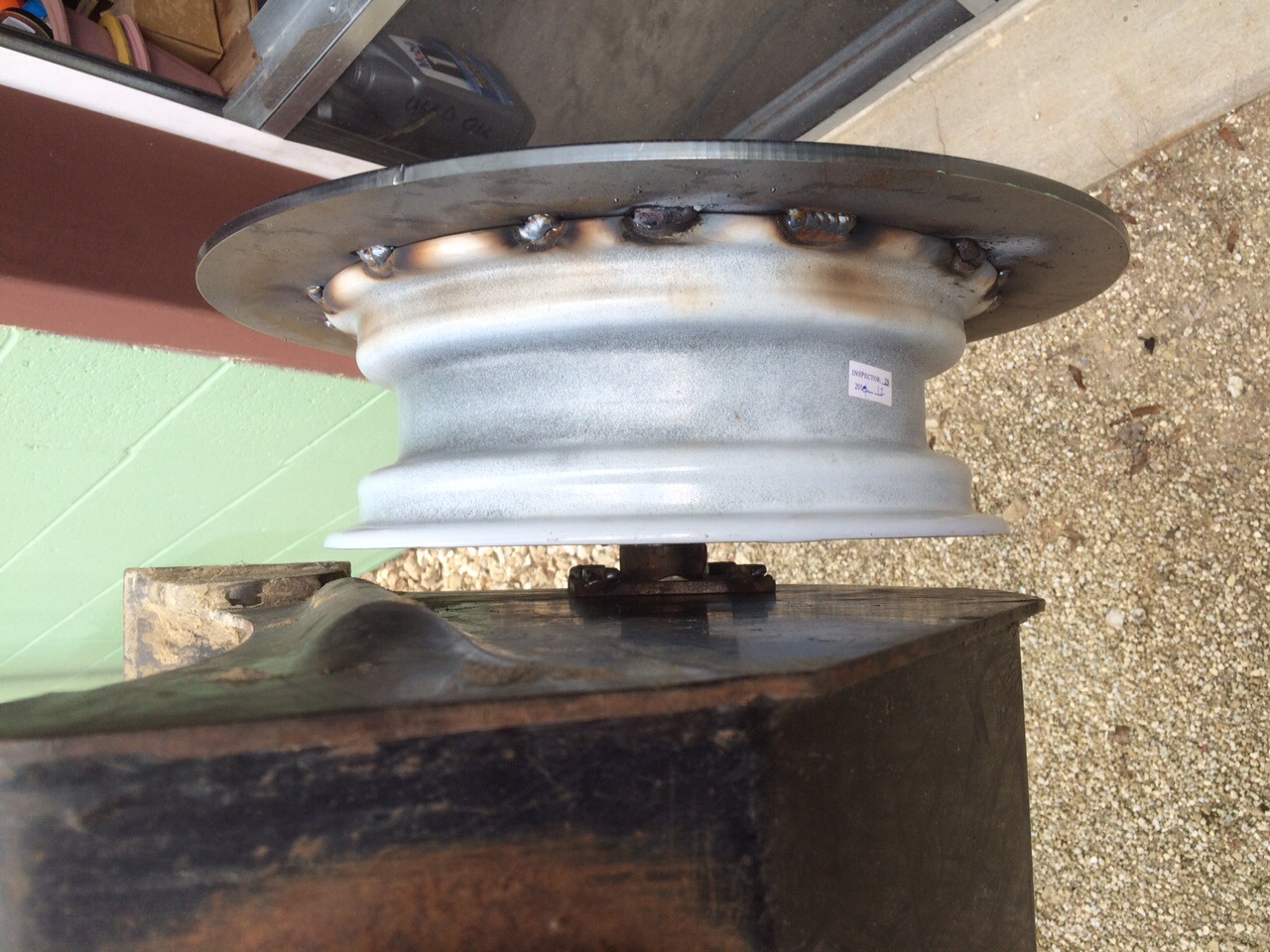

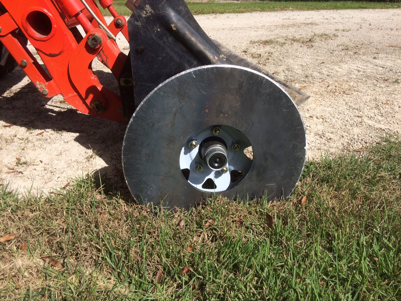

I transplanted a sod border along the edge of my driveway to keep the stones (pea rock) at bay, but after 2 years the sod I transplanted is starting to take over my driveway and growing into the stones. I needed something to trim the (now horizontally growing) grass and a power edger with a spinning blade just wasn't going to work with those stones. So I conceived and fabricated this edger using parts from a local trailer supply, and a peice of 1/4" steel plate cut by my local steel supplier. It works great and I just wanted to share it.

Looks like it should do the trick. Do you use down force from the loader or just let it float?

That is pretty creative. How hard is it to maneuver the bucket on a curve and is it working and keeping the grass in check?
/ Bucket Driveway Edger Attachment #4
I think that is pretty good too. How do you peel up the thin strip of sod ??

Did you consider other attachments methods that would not require making holes in bucket? Perhaps using a loader width pipe with welded on clamps to both sides of bucket (or using a "ratchet rake" sort of attachment)? The ratchet rate attachment might work particularly well with the bucked edge facing down so minimal stress on attachment (e.g. bracket to fit over and under bucket edge on each side of bucket with axle pipe all the way across).
What was the reason for using the wheel? To space the cutter plate further away from the bucket edge/wheel hub, rather than mounting the cutter directly to the wheel hub?
With apology, my questions aren't intended to be picky, I do like your idea!

What about using a disc from a garden or field disc? Just use one of them?
A plow coulter would be an ideal starting point. The are made to cut sod and swivel also so curves would be easy to make. This plow is for a garden tractor and is lightly built of course but clearly illustrates the coulter setup. The coulters on full sized plows are considerably heavier and would make a good starting point if one were inclined to make such an edger.

Looks cool , but I was wondering why a new rim ? Old ones are everywhere

Downforce is needed to get the blade down through the rock base.
