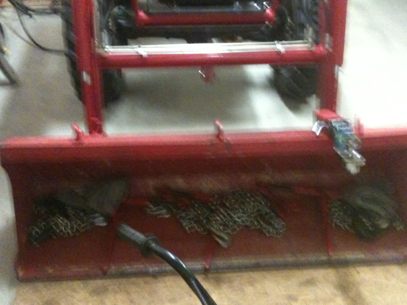

This is how mounted mine. I have a direct line of sight for hook ups.

I remember seeing a photo on TBN like that in the past. The problem would be seeing the ball for hookup. With my setup I can see the ball. Simply drive up to the the trailer lift and drive away. Works perfect and the receiver can be removed in a few seconds when needed.
/ Bucket Hitch #12
I welded a receiver to the rear of my boxblade and use a 2" and 2 5/8" hitch. works great, easy to see, lifts all my trailers without flexing and provides hook point for chains.
