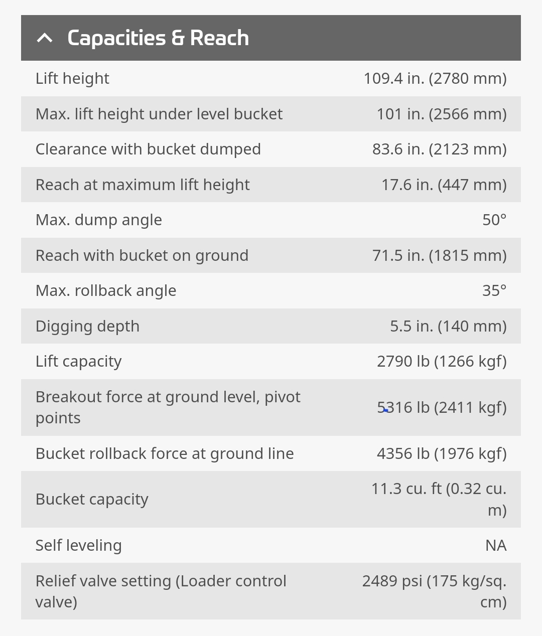

My 55 HP (turbo 48) has 2700 lb to 9ft. I made a spreadsheet with 14 makes and about 4 models per make. Few approached 3000, but almost all were at ir above 2000. Breakout
I'm traveling now, but I'd be happy to post them all when I get home.
Here are the spec on my loader.

That's good, but really no more relevant than looking at the lift capacity of Hay Dude's monsters. The comparison was a 33 hp Deere 3033R, not a machine with literally 35% more horsepower and weight.
   / Bucket hooks #80
Exactly. To get near 3k lift capacity, you're going to be looking at 50 hp machines, not 30 hp machines. No matter what the brand.
