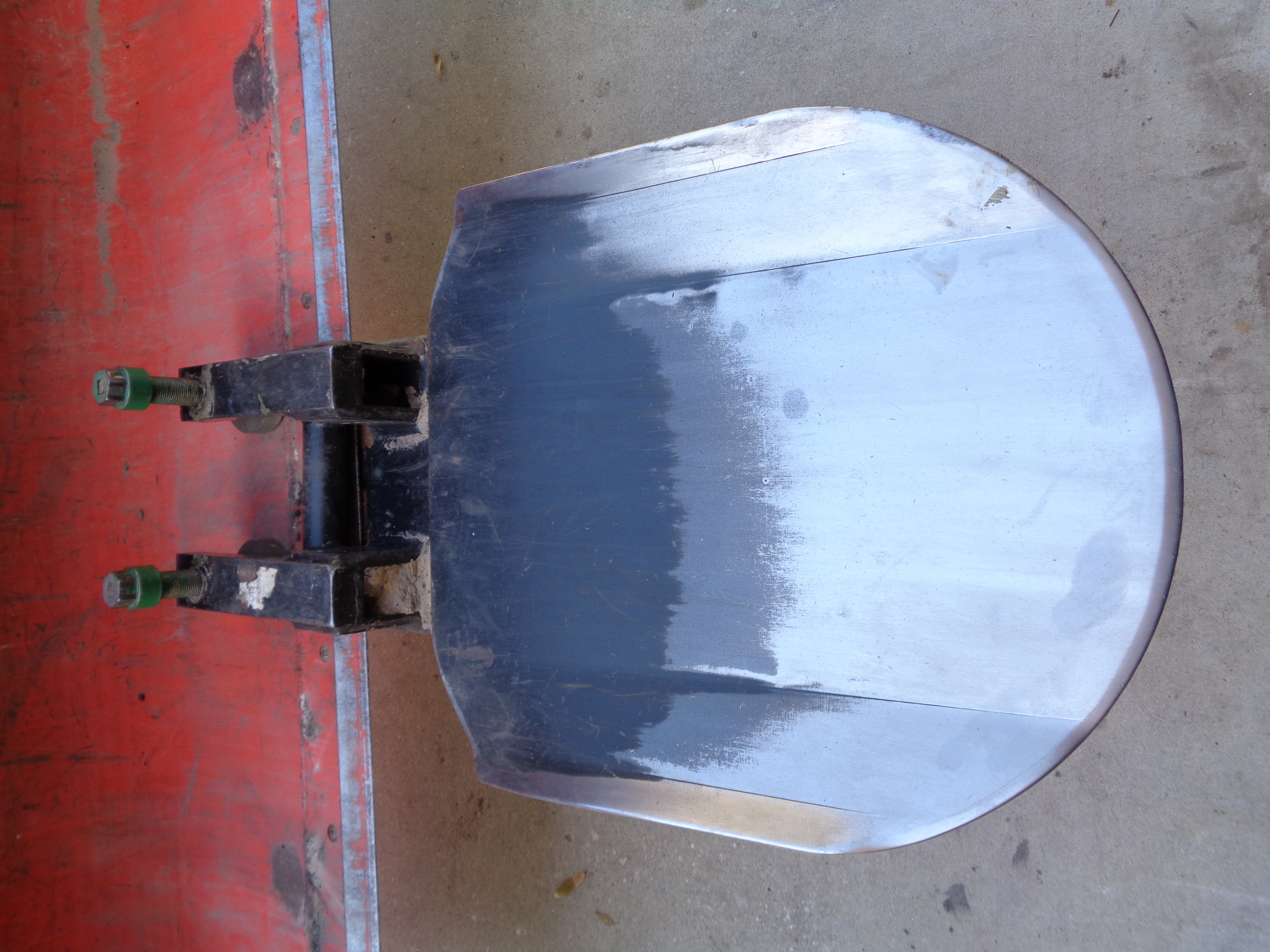

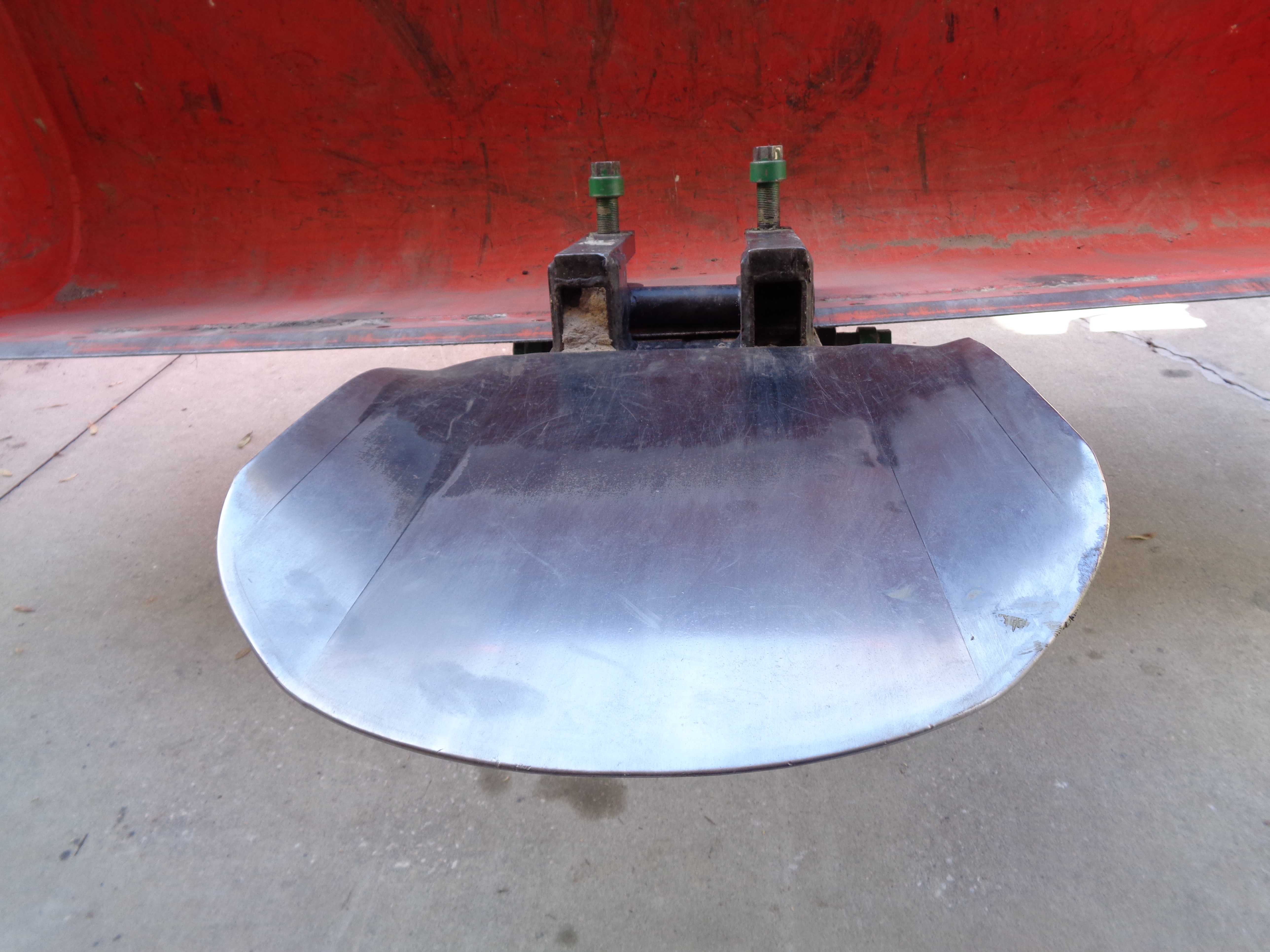

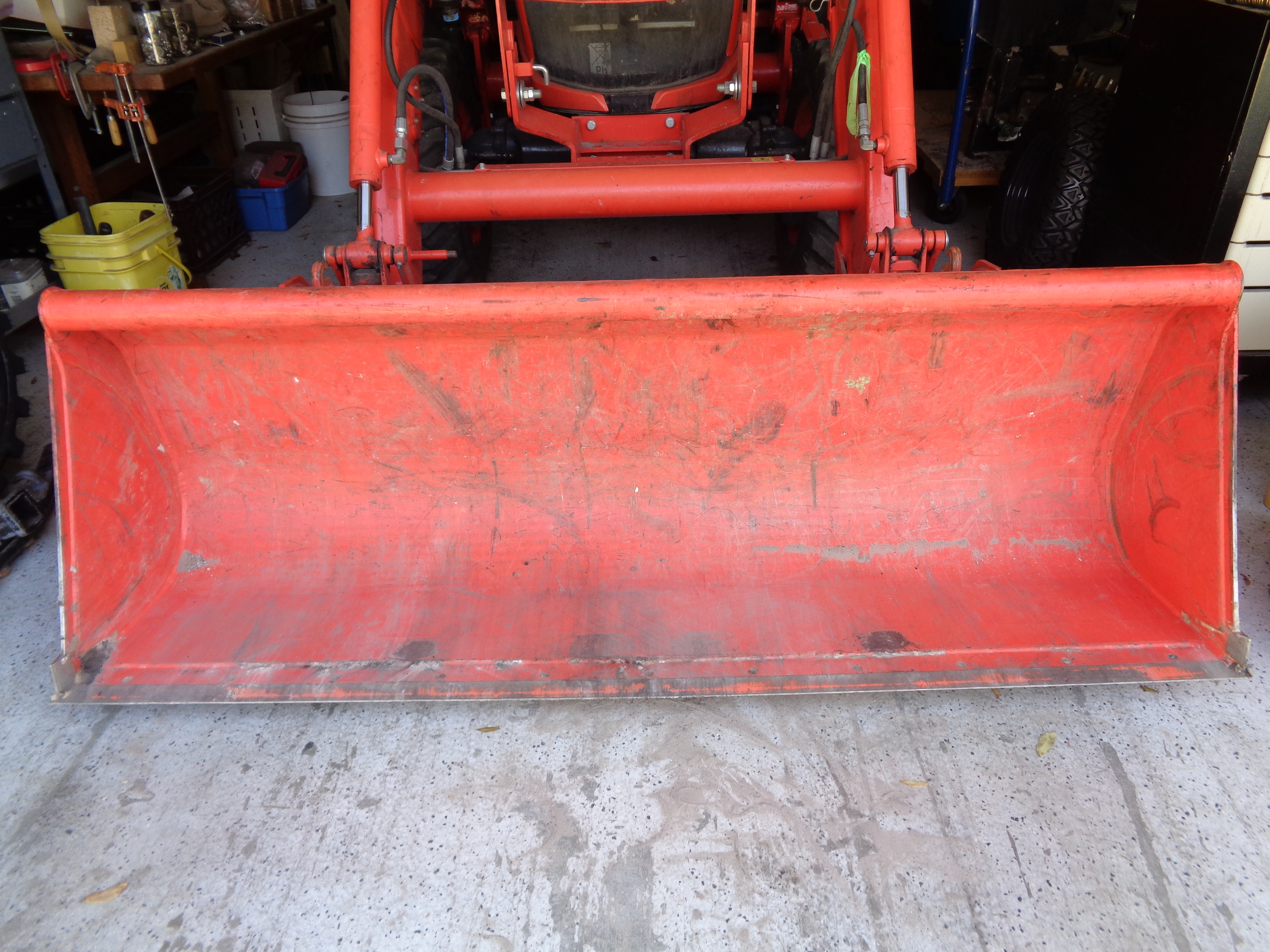

Photo #1, snapped moments ago, of my Kubota L2296 heavy-duty, round-back bucket after 7-1/2 years of regular use. Photos #2, #3 Bucket Solution's bucket spade after nine years of regular, though intermittent, use; 7-1/2 years mounted on L2296 bucket.
Photo #4, a late thought, shows bucket spade bottom mount on my former Kubota B3300SU.
Note bucket lip on relatively light weight standard Kubota 'B' series bucket -- STRAIGHT. Operating bucket spade on light B3300SU did require operator prudence.

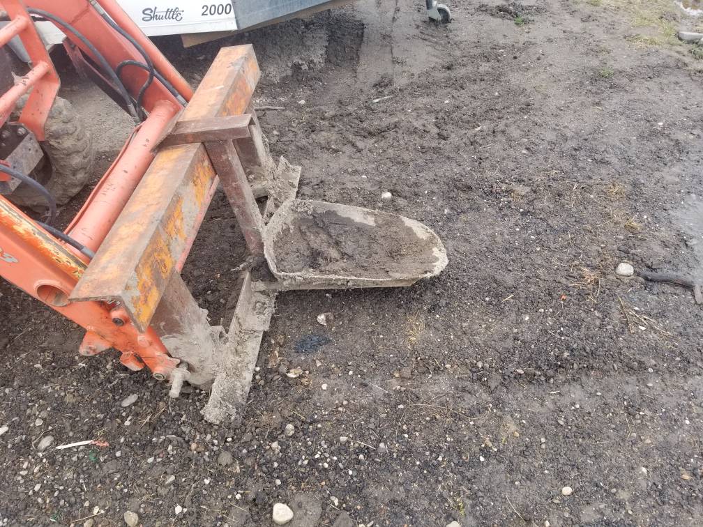

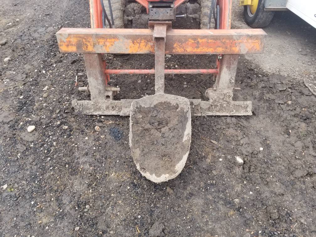

I thought of doing it that way but was concerned about not enough lift and damaging the bucket. Here is my solution. 20200513_164106.jpeg20200510_115908.jpeg20200510_115859.jpeg
   / BUCKET SPADE TODAY // FEL BUCKET ATTACHMENT #50
By pulling 2 pins on the right and left of the spade I can lift the spade off and use the base for another purpose. Takes about 10 seconds to lift out a small tree and about the same to plant it.
