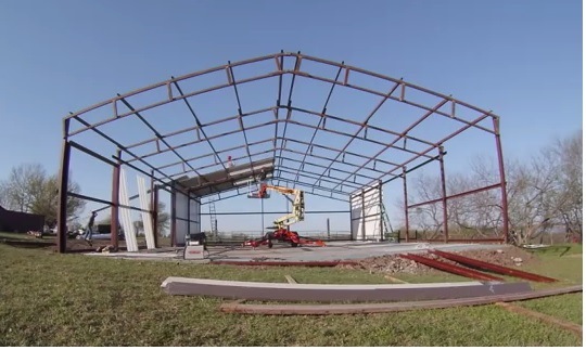

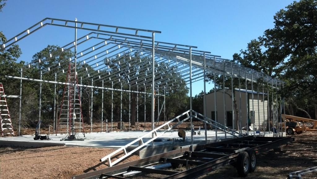

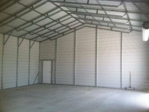

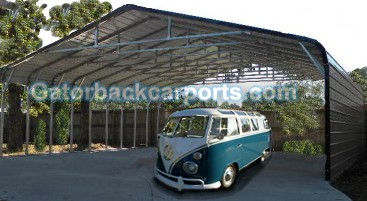

I've been looking at some steel structures with steel trusses online. A lot of it on really long spans, like aircraft hangers, has webbed beams with horizontal cross supports part way down, sort of like my original plan except that the top becomes a webbed beam. They look to be constructed mostly of angle iron. Then I see some that are webbed square tube but, I also find a lot like the ones I've attached here that are basically just bent square tube with some gussets. I get that these aren't quite as long of a span, although one of these looks to be a little more than 30'. Even given that my span is longer, the fact that pipe is stronger than square tube, and definitely stronger than angle iron, and then add that drill stem is hardened steel (although it will have some internal wear from use) and it doesn't seem like this is really too much to ask of it.
The last picture here is a 40' span. I don't know what the material is but the truss design sure is basic on it and they're spaced much further than 4'.
And here are plans for a 40' span using webbed angle iron trusses.steel-truss-barn-plans-front.png

Our 40' span is like the one in the first pic, but improved upon. 2-1/2" square tubing. If you follow this design, it will be plenty strong. Our building got hit with 50 mph winds last Spring and even with 14' walls it held just fine.
