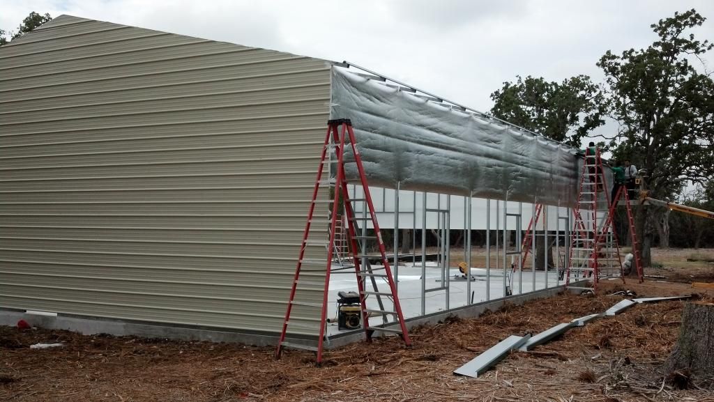

So the pictures you posted were in construction progress and they added the extras after putting up the posts? Do you have any finished photos of the framing?
Never mind, I looked at the photos again and see that towards the back the spacing gets closer together. How did they cover the wider spacing in the front of the photo?

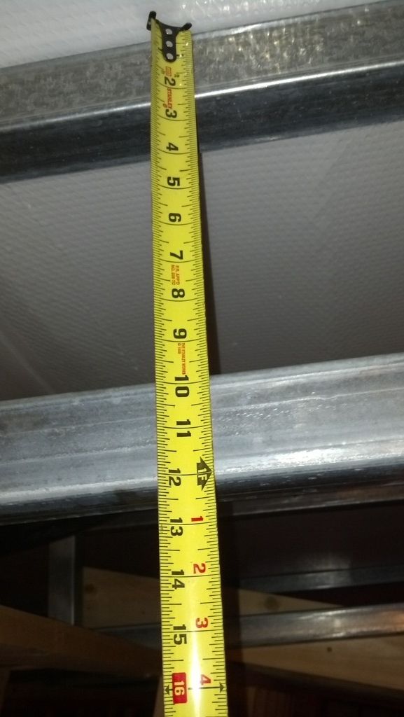

One last question, what's the measurement between the 2 pieces of square tube?
I have no idea what the gauge is.

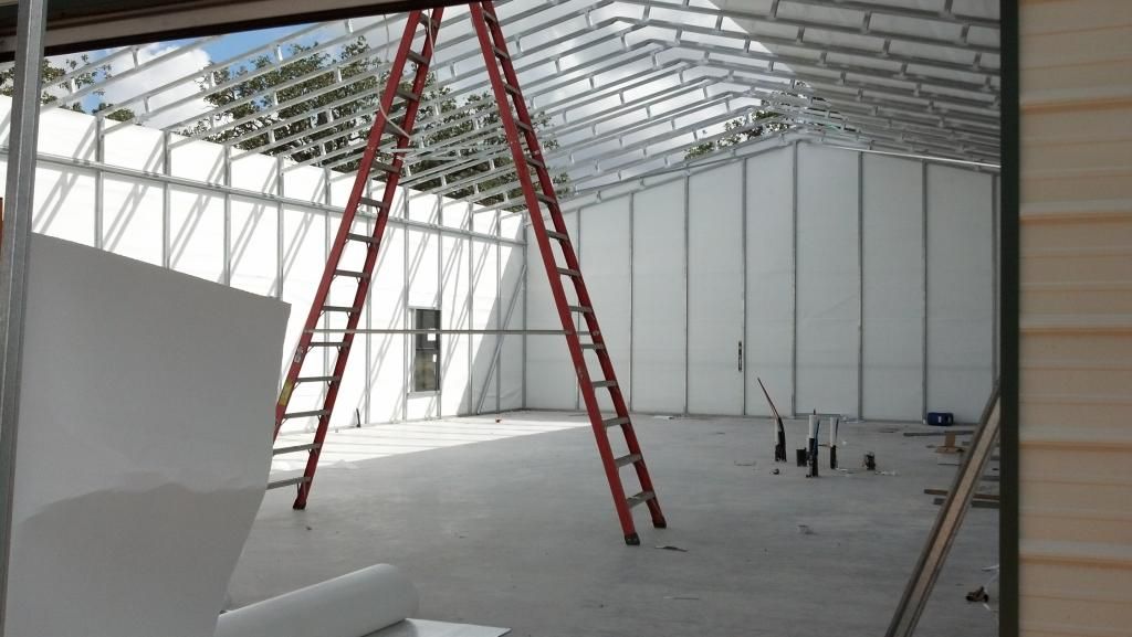

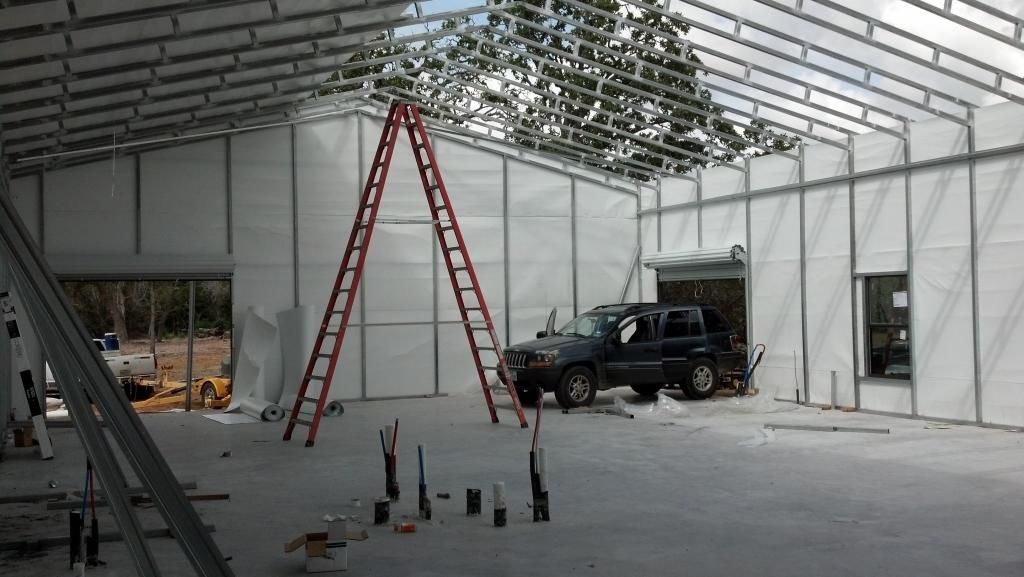

Maybe these pics will help with your questions. Let me go measure the actual height of the truss/beam, I think it is 12" total.
The building is our Barndo that I am framing out, 40x70 with an 18' shop on the end where the roll up doors are. Our initial concern was the metal structure before the interior got framed in, as the interior framing will help support the metal building. Last Spring we had a few tornadoes in the immediate area and with the crazy wind it held perfectly fine. The roof structure is very solid, surprisingly so. I have stepped on the roofs of some metal buildings that left me with an uneasy feeling, this one does not.

That is a great looking building, lots of open space overhead. It's interesting to see that they didn't use any purlins for the roof and yet you still have a very strong building that's already been wind tested.
   / Building a covered work area with a 40' span, will this work? #37
They actually did use purlins to tie it together and to give a surface to attach the metal roof to, it doesn't show in those pics because the purlins are on top of the bubble wrap insulation. You can see it here on the right side, they ran these every 3'.
The height of the beams/truss is 12" and the uprights between the cords are spaced at 40".
It is getting hard to take pics now, the interior framing is at about 99%. It fills up fast once interior walls are up. :D
