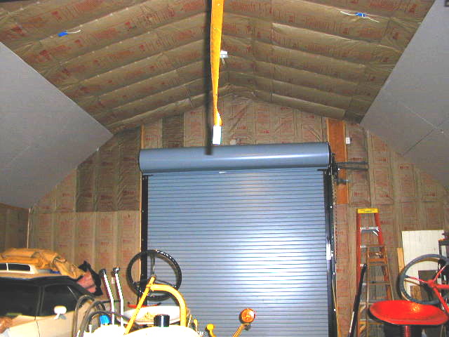

   / building a "Pretty" Barn #26
Re: building a
Yes, the loft is at the opposite end. Yes, two different trusses. 11 Scissor(22ft) and 9 attic(18ft). This was designed by my builder from my concept. The idea was 1) clear span(no posts) 2)High bay area(15ft to peak of bottom chord on scissor truss) for the addition of a 4 post lift. The whole design had to fall within height requirements of the city. The gambrel roof line(pitch) turned out pretty good. We've all seen gambrel roofs with disappointing pitches. They don't look so good/w3tcompact/icons/hmm.gif. I'd be happy to share some more design info if you're so inclined. Pic is high bay area. C

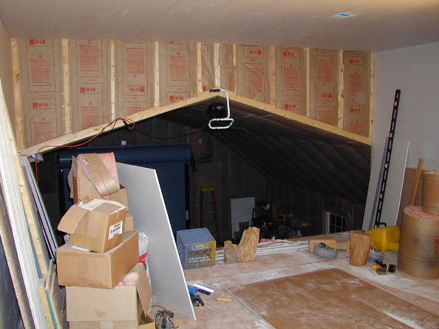

From loft looking out.

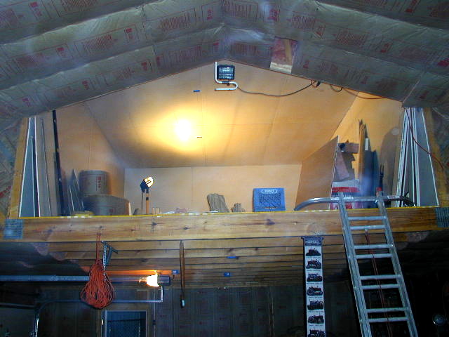

Looking up at loft from high bay area.
