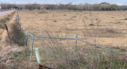

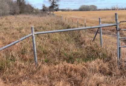

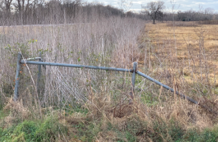

Thought I would do a show-and-tell on my neighbor's "professionally built" fence. After approximately 7 years, here are 3 example corners that I photographed today:
Simple observation should be sufficient to say that something is wrong with the design. The builder installed 3 posts: Two stand about 4 feet above ground level (6 feet below ground level), one is about 1 foot high. Distance between each is approximately 6 feet, all connections are welded.
My thoughts are as follows:
1) The corner post has little vertical resistance. It's just a pipe stuck in the ground.
2) The middle post has little vertical resistance.
3) The "short" post is installed vertically, thus resistance to pushing from the angled pipe is poor.
4) There is no way to correct the situation, short of removing and rebuilding the corners.
As a result of the movement, all of the fence wires down the line are loose and all of the intermediate posts show that they have been pulled with the wire, meaning they too are leaning.

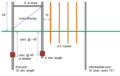

Thank you for the pictures of your neighbors fence. I've seen similar results too.
In your drawing, I believe that you have taken the traditional design and improved upon it. Is the diagonal bracing wire or is it something solid?
With your design, which was originally created 200 years ago, the engineering was based on only having wood and wire to work with. The wire pulls the second post towards the corner post and locks it together with the cross post. By going deeper and adding the anchors to your posts, you've also increased the structural strength of it.
A triangle is the strongest shape in construction. The triangle is upside down in your design, and relies on 6 points of contact to create a solid structure. The only function of the second post is to support the cross beam. It offers no strength to the corner post.
In my opinion, I've simplified the design by using a much stronger diagonal bracing. The metal pipe set in concrete. I have 3 points of contact, which means if just one fails, I'll have total failure. But it also means that there are less places for failure when compared to a H designed corner.
In my soil, I believe that your design will work flawlessly if the diagonal wire doesn't stretch over time. I also believe that in my soil, my design will work, but cost less money and time to create.
Diagonal is wire. I use twisted 12 gauge double wire (like barbed wire) but with no barbs. Any strong wire will do. I use 2 loops before twisting it tight, therefore there are a total of 8 wires.
There are actually two triangles. The second post (inner) must support the horizontal piece.
If the diagonal wire should stretch, which is unlikely, all that is necessary is to add an extra turn or two on the crosswire.

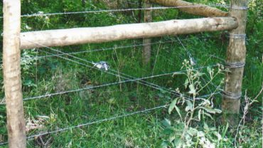

Why don't you like H-bracing for corners? We do it like that up here in Kentucky with horses, cattle, goats, and the worst weather conditions you can imagine from blazing summer sun to deep snow to torrential rain...and they last for 20-30 years on average.
I have never been to Kentucky, so I can't comment on how well fencing holds up there. Here in East Texas, where we have red clay soil, I have noticed that every single corner that I've seen done this way has become loose over the years. The last one I looked at was between 5 to ten years old, and the wire was loose and the cross beam was bowed. The posts where leaning over slightly, but not significantly. They where working on fixing it by pulling it back with a tractor, and filling around the posts with concrete. Then they said that they will tighten the wire the next day or two. I don't know if they did or didn't, it was at a house I was looking at for a client, and I haven't been back. It was built with new PT round posts.
I will admit that I've also noticed a lot of H corners built with railroad ties, and they where all in very bad shape. In my opinion, railroad ties should never be used for fencing. They rot very quickly when they are in the ground, and nothing can save them.
