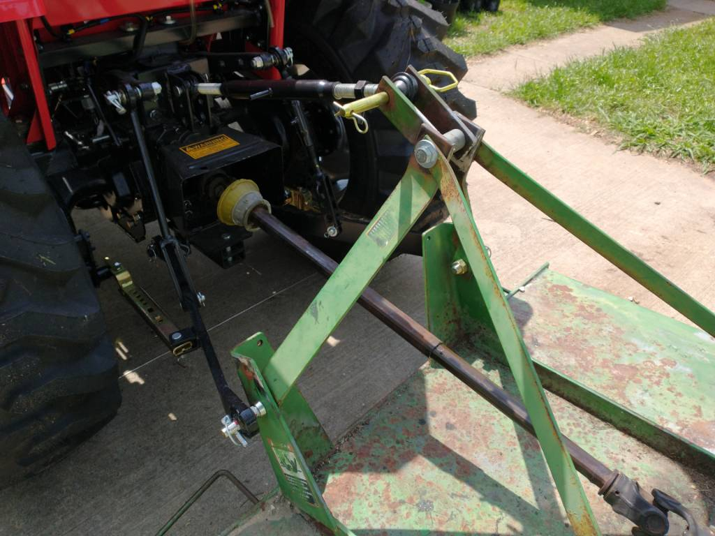

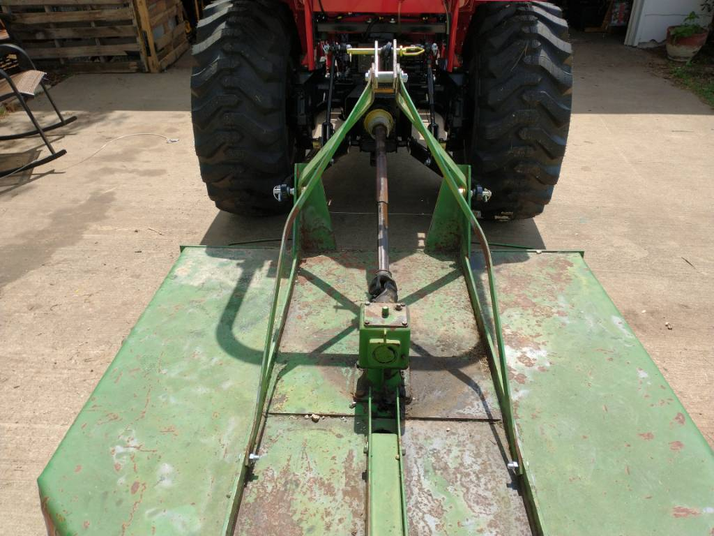

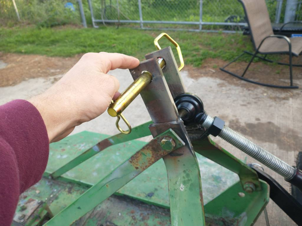

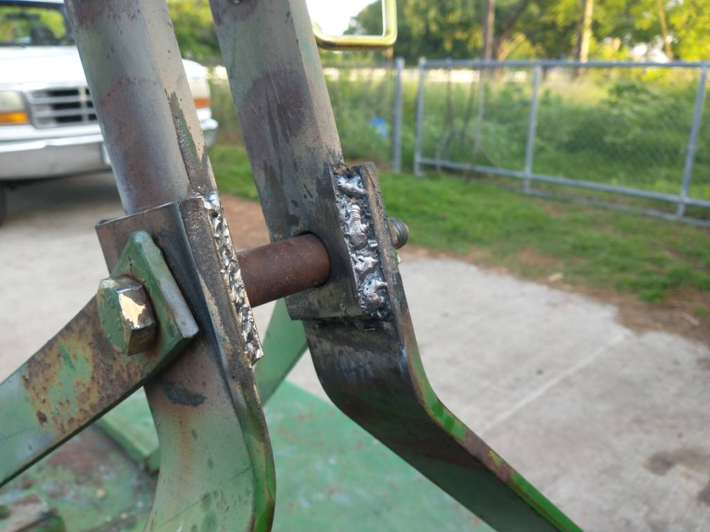

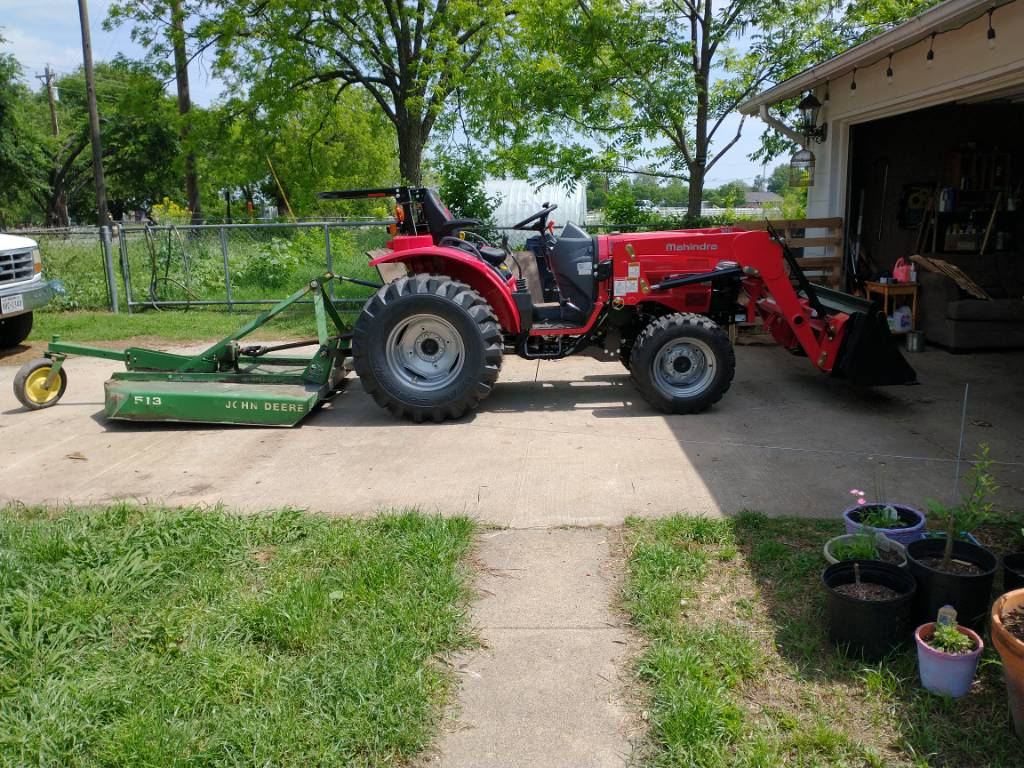

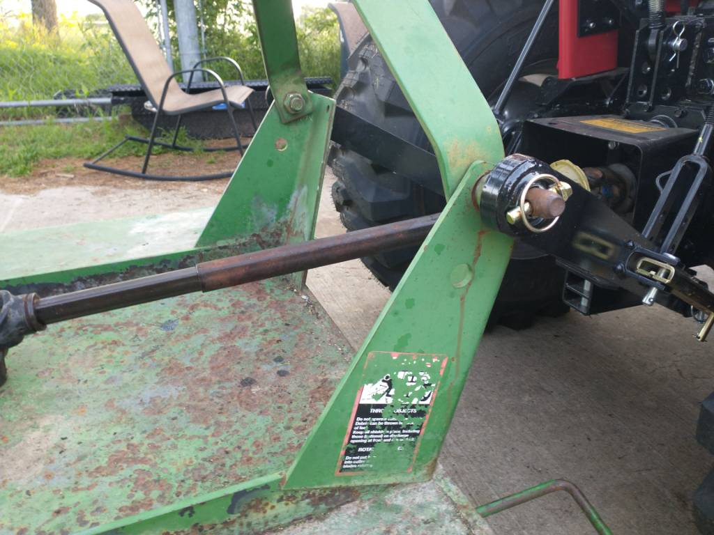

Hey y'all, I'm running into an issue setting up my new to me John Deere 513 bush hog. Paid 675$ for it, get it home to fin banged up dull blades, gearbox dry, and the top link bars not fixed to the supports. Added some 00 grease, ground and sharpened blades, but the problem I'm having is figuring out the top link setup. I used my flux core welder to weld the links to the front supports, fairly straight up, but now I'm finding that with my top link adjusted almost all the way out the back of the tractor is way too high when I get the front set at the cutting height I want. I'm contemplating trying to find a longer top link bar, grinding the welds and redoing them with the plates facing forwards, or going ahead and moving lift arm points on the mower to the lower position and the rear support to the farthest back positions. What would y'all recommend?
/ Bush hog setup #2
The strap you welded (top link bars) are supposed to be free and able to pivot with the top link attached so the mower can follow the contour of the ground.
You need to cut your welds back off.

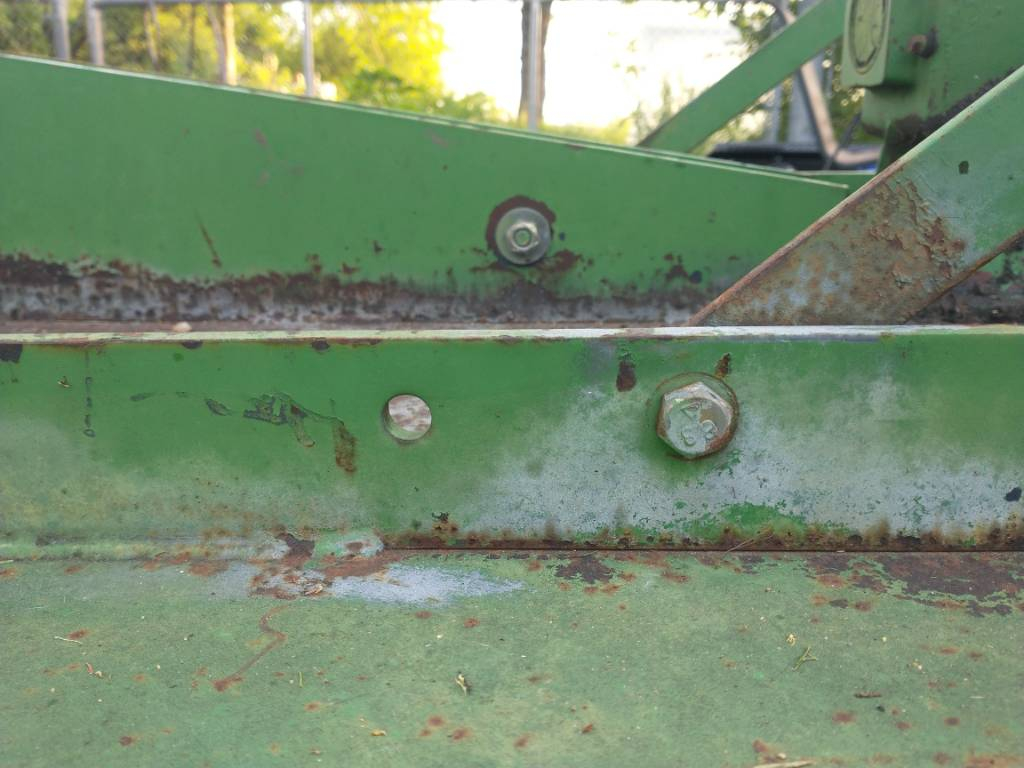

When I installed it that way I was having a hard time keeping the back wheel off the ground for transport, that's why I assumed it needed to be fixed. Should I go ahead and put the lift points lower and the reas supports further back you think? There are factory holes that I assume that's what it's for.

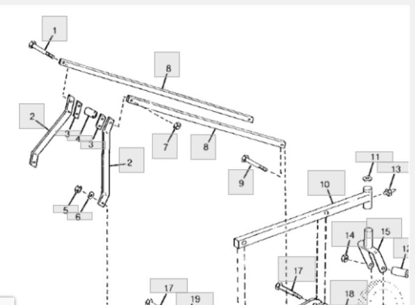

Here's a drawing from parts. Note, there is a spacer too. Top link connects to key 3 and they should be free to pivot as stated in post#2View attachment 698597
/ Bush hog setup #6
Vince above is correct. This link is to allow the back to rise up on uneven ground without trying to lift the back of the tractor off the ground as your setup would attempt to do. The two hogs that I have have a solid piece of pipe (with a grease fitting) welded between the two straps.
Bolt #1 in Zebra's picture is not torqued down tight allowing the connection to swivel. I suggest a locking nut or a double nut be used to not allow the nut to back off. I do not understand why in the illustration the parts 3 and 4 are not welded together to force the pivot action to occur at part 4.

You may want to get a shorter pin for the top link so it won't hit the uprights when it moves below them (when the rear of the cutter gets lifted).
/ Bush hog setup #12
That’s one of the uses of a hydraulic top link for a bushog - extend when cutting to let it ride contours, pull in short when traveling and your tail wheel will jump right on up. (I have a Mohawk brave with the swinging clevis )

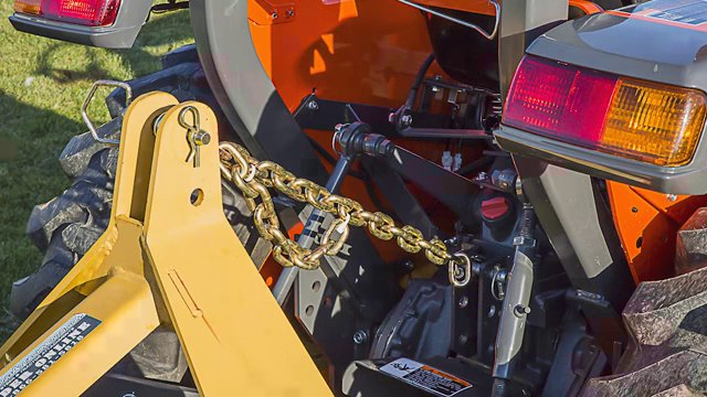

Been mowing for more than fifty years and only started using a chain for the toplink in the last five. It enables me to mow and trim in a lot of places I could not before. Back up to a ditch or dropoff and the back end of the mower will drop down until the chain stops it. Back up to a steep pond levee and the mower will track up the bank. I have clamps at specific places on the chain marking the fartherest the back can drop without the pto shaft rubbing the mower and for transport to keep the back end off the ground.
RSKY
/ Bush hog setup #18
That's why pretty much all the brush mowers over here come setup with chains from the A frame to the back of the mower instead of the metal straps that usually get bent. One simply extends the top link and let it float on uneven ground.
Hydraulic top link is really good because you can simply retract the top link all the way, to lift the back of the mower up and mow against an embankment or tall brush in reverse. Then extend all the way and move forward.
