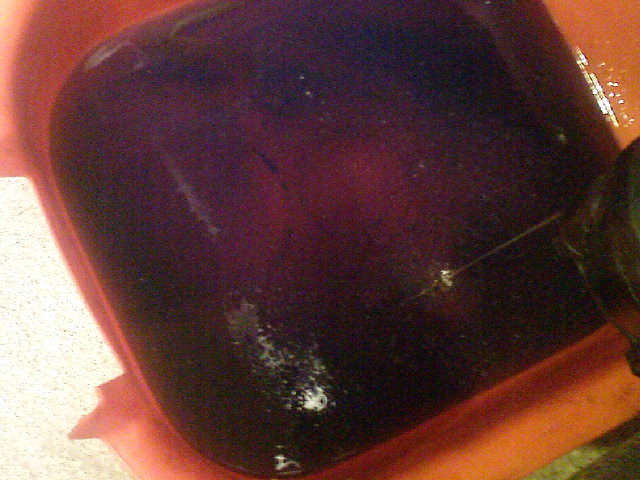

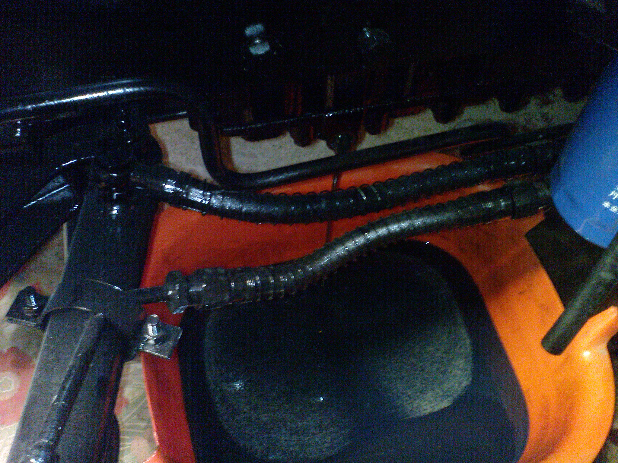

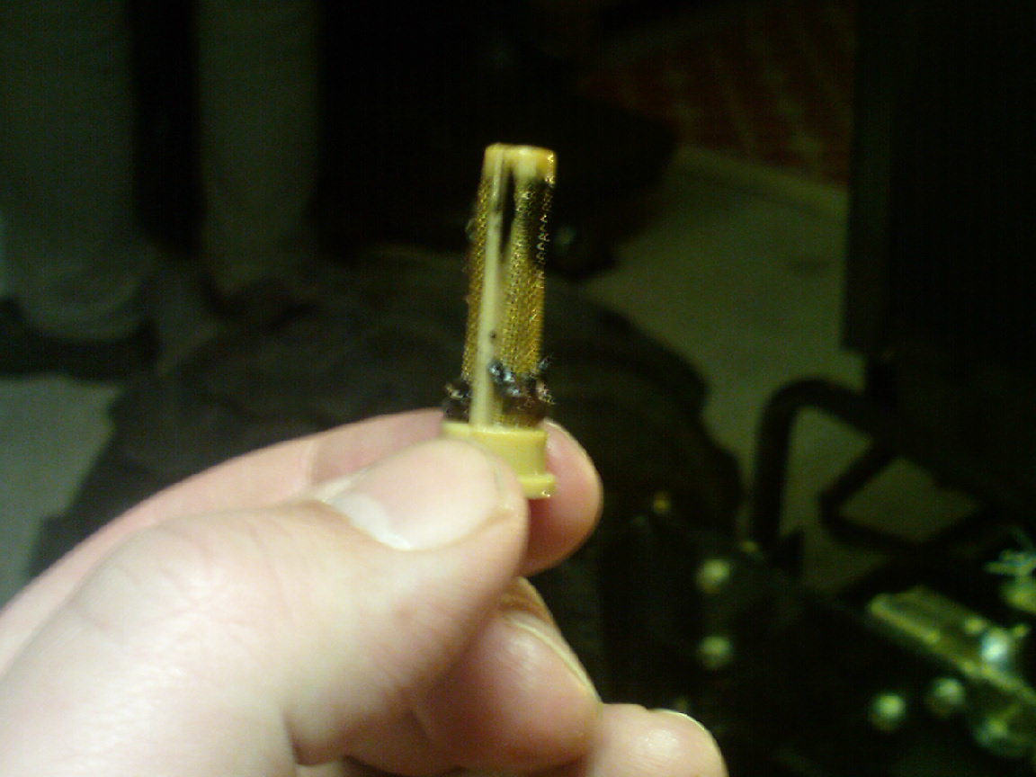

Hej :)
Congrats on you new purchase, exited time for you I bet. I was a walking ulcer while waiting for my order. I ordered directly from China, a Dong Feng 254G2, I received it in December. I have put 30 hours on the clock so far, all of them pushing / removing snow with the loader.
I concur with the others about the fluids. Make the dealer flush and change all fluids. My tractor arrived crated and i did all the prep myself. I changed the fluids, checked all bolts and nuts - Adjusted and checked the clutch and so on. My fluids was full of shavings from machining. In the first picture you see the front axle oil, the shining in the left corner is not a light phenomenon from the cell phone camera, its burrs and shavings. Second picture is the engine oil. Third picture is how the inline filter screen in the fuel line looked like.

Sadly guys It's not negotiable... the tractor is already insanely cheap, and if it's going to be done, part of me is happy that it'll be me doing it: at least I know it'll be done properly.
If the oil is skit* I'll filter the bits out and send them to the dealer. He's a resonable bloke and will probably give me a good price on my next toys :)
I'll put a magnetic drain plug in it to start with.
As said... Engine oil, Diesel system and hydraulic systems already have the fluids changed by the dealer. Geabox and axles are the only ones they don't do.
