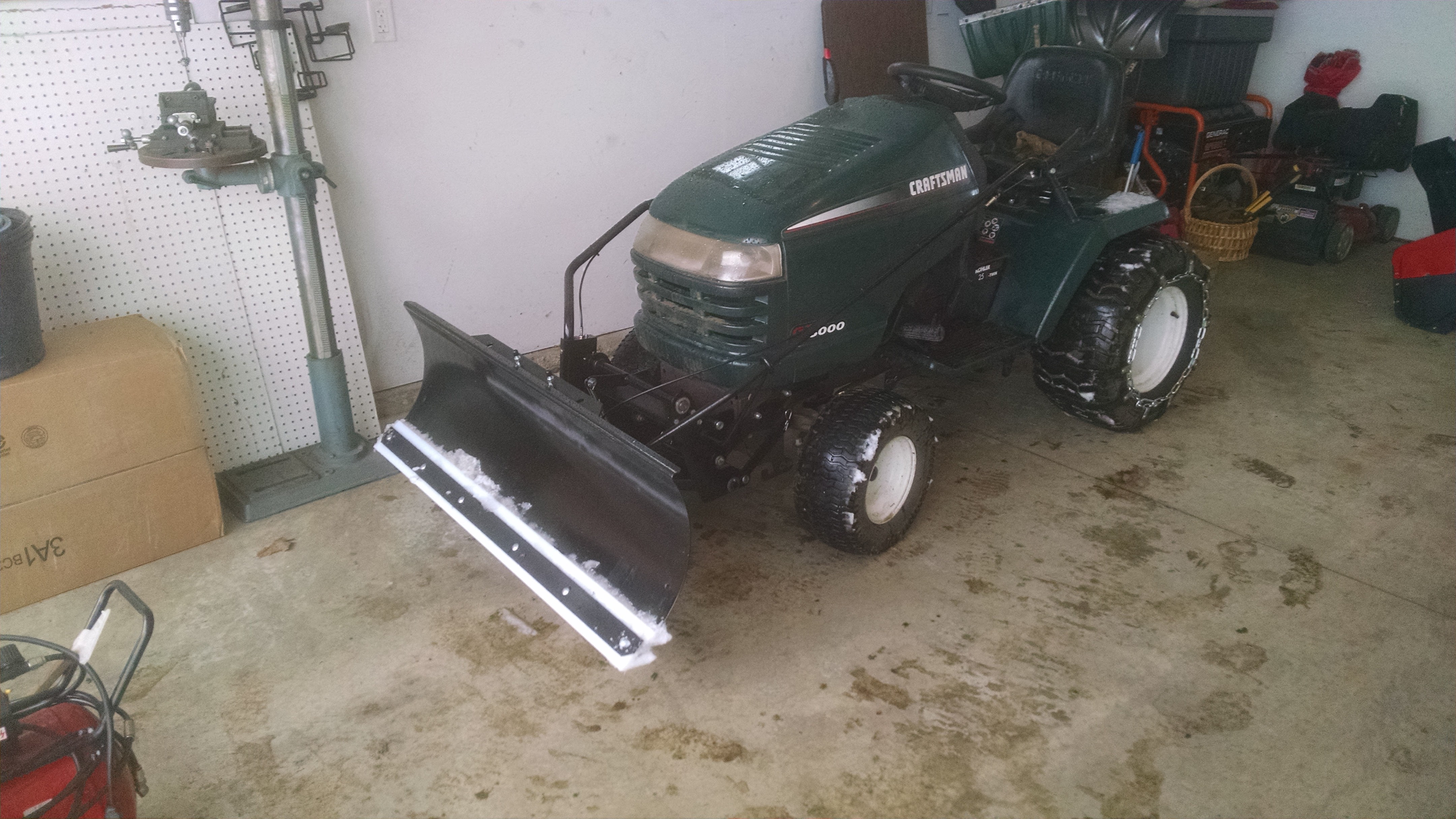

Howdy, I got a massey scut with a ssqa loader for the bucket. I'm looking to buy ssqa plate to weld a plow onto it. Are they all the same size, and if not, what dimensions should I be concerned about?
Also, need recommendations on material thickness. Would you say 3/16 is adequate for welding a "light duty" plow onto it? It's just gonna be the plow I used to have on my garden tractor.

SSQA plates and their connecting point dimensions are a standard measurement. I say connecting points because on the whole some plates are square, some have taper sidewalls, etc. For a SCUT, a 3/16" plate should be plenty as realistically your driving square from behind the loader arms and not wrenching/twisting in the plate itself.
The only SSQA thing you need to be weary of is a mini-SSQA plate which, it memory serves, is narrower than a regular SSQA setup.

Yeh snow plow, sorry for the confusion. This:
Cglaser, thanks for the info!
Ruffdog, I'm thinking to hack off the mounting bracket on the plow's push beam, weld angle iron to both sides of it, and then weld that to the plate. Maybe also weld a 45 deg angle vertical support beam between the push beam and the plate.
This just for doing my own driveway, nothing crazy.
If you angle the blade will it cover the width of you tire tracks? May have to add extensions.

1/4 minimum

1/4 minimum
Hmm, this raises a question for me about welding, which I'm totally green at. I got a 120v fcaw, rated for max 1/4". But what does that mean exactly? Let say I got 3/16" angle iron to weld onto a 5/16" thickness plate. Somebody give me the quick & dirty on why not with this welder.

Plug it into a tree and pray for lightning. The small wire feed welders are shy on power to get good penetration on heavy steel. Good time to add to the tool selection with a 220 volt buzz box, provided you have the power available. Can always utilize the dryer plug if necessary.

That welder is for small thin jobs.
Wont hold in a strain.
/ Buying a ssqa plate #16
3/16 is gonna wear faster. Your at the limits with a 110 machine but it's possible.
