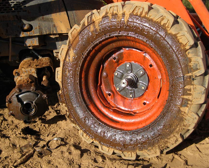

This is what happens when the outer cover on the 4WD front hub fails due to side loads. It's a cast iron or steel part held in place by a ring of bolts, and it carries a large roller bearing to support the outer end of the stub axle. Kubota must have used the same side load calculations for the failed loader mounts that they used to design the outer cover. Unfortunately the replacement cover design hasn't been upgraded and the resulting flex is still breaking mounting bolts and causing them to loosen. It's only a matter of time before the new cover fails in the same manner as the old one.
What I bought is an over sized garden tractor that would have been fine if all I needed to do was cut the grass, push some snow, and maybe once in a while move some gravel or firewood. Knowing what I know now, I'd have been much better off with a Cat, Deere, or Ford backhoe/loader for the landscaping work I needed to do. The OP of this thread mentioned clearing woods, and even suggesting that a Kubota CUT would be suitable for such a job is irresponsible at best.

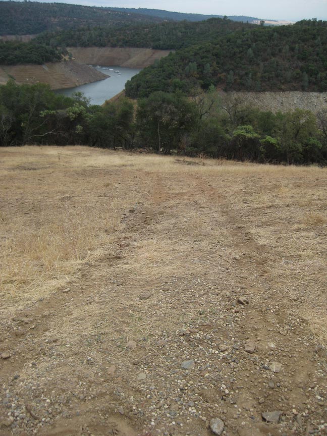

Just one last point. This isn't just about a little slop in a bucket or having to split a tractor to replace a six dollar seal. It's about serious injury or death, all because Kubota chose to save a few dollars of material cost. The photo above shows a pair propeller shaft couplers on either side of the propeller shaft itself. For scale, the OD of the shaft is about 3/4" The coupler on the left is brand new, and the splines on the inside engage those on the outside of the propeller shaft. When the tractor is in 4WD, the shaft transmits power from the transmission to the front wheels through the splines on the inside of the coupler. Off the throttle and down hill, it also allows engine compression to exert a braking influence when the tractor is in 4WD. The coupler on the right has about 1000 hours on it, and I found out the hard way that the splines were no longer tall enough to lock onto those on the propeller shaft.
Now look at the photo above. Those two brown streaks are skid marks from the back wheels of my tractor. They started just after the splines in the coupler stripped and the tractor started accelerating down the hill. In this case, down the hill consisted of a lake filled canyon preceded by a boulder field studded with oak trees manzanita bushes, and a fifty foot cliff. If the bucket's full of rock it tends to unweight the back wheels. In situations like this, when the operator stands on the brake nothing much happens but a little dust because Kubota doesn't put brakes on the front axle. But thanks to those rocks in the bucket, enough friction is created when the operator drops the bucket that the tractor will eventually stop. Those that like to mow or plow or scrape or disc on steep hillsides (about 15% here) without the FEL in place might want to reconsider.

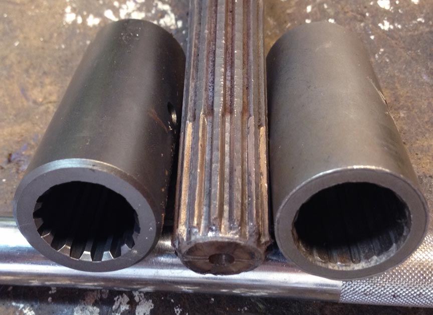

Now scan back a bit to my last post, and look again at the picture of the wheel leaning against the tractor. Sticking out from the center is a splined stub shaft that takes power from the front differential. The stub shaft is about 1 1/2" in diameter. Recall that the propeller shaft is about half that diameter, and realize that it drives two of those stub shafts, one for each front wheel. The result is that we have about at least a 4 to 1 ratio in spline cross section between the stub shafts and the propeller shaft/couplings. It's probably much higher than that because the stub shaft splines are deeper and engage over a longer axial length. Is it any wonder that the coupling stripped, especially seeing that Kubota neither recommends nor applies any lubricant to it, despite the fact that the stub shafts run in an oil bath?
So next time you're out logging seat time, give some thought to what dragon eggs may be waiting to hatch beneath your butt. Then understand that some of them were put there by accident, some by abuse, and some were designed in. Granted, my experience so far has only been with one tractor, but I'd say Kubota is pretty good at the latter.
So next time your out logging seat time, give some thought to what dragon eggs may be waiting to hatch beneath your butt. Then understand that some of them were put there by accident, some by abuse, and some were designed in. Granted, my experience so far has only been with one tractor, but I'd say Kubota is pretty good at the latter.

I have to agree on the Kubota 3/4 inch main drive shaft to coupler being under sized... that is smaller than just the hydraulic FEL pump drive on my ford 3000. I hate to say it but that is about the crankshaft to pulley drive size on my 2 riding lawn mowers...
It also appears that the coupler was made of a much softer material than the shaft itself.
