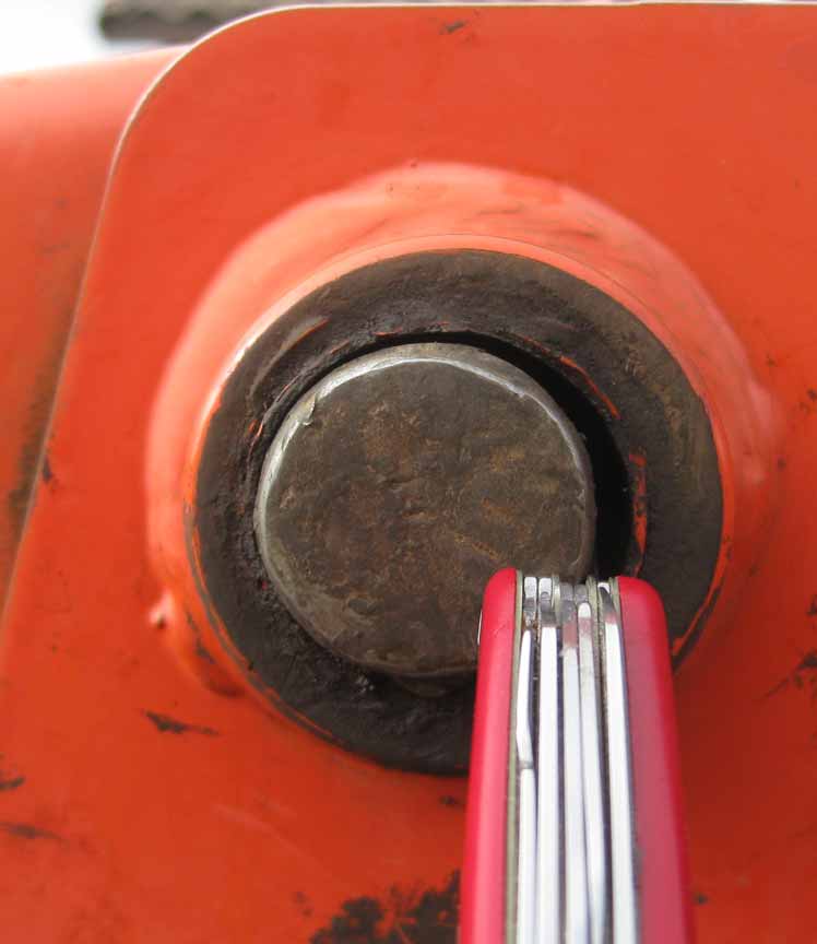

This is the outer boss that's supposed to hold the non-rotating pivot pin for the main loader arm pivot. Kubota drilled the holes for the keeper bolts so oversized that the pin ends up rotating, and with no grease fitting on the boss, accelerated wear is the result. Since Kubota neglected to bush the pivots, the repair involves line boring the assembly and fabricating bushings and new pins. This failure had nothing to do with abuse, and was a direct result of bad design and engineering choices made by Kubota.

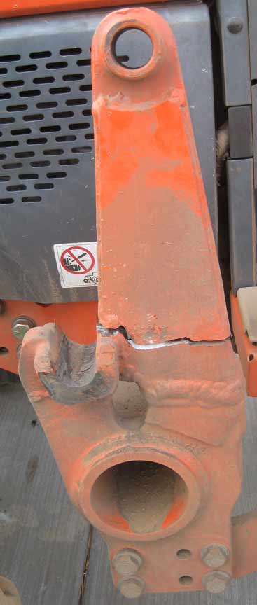

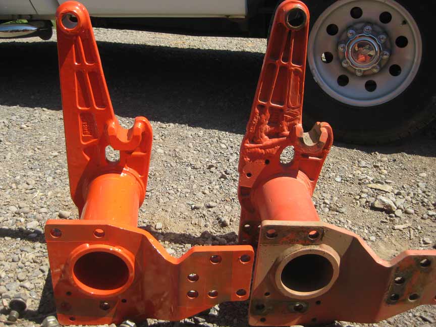

This is a picture of the FEL mounts off the same tractor. Side by side are shown the original broken mount and updated replacement. Kubota realized that the original design wasn't strong enough to survive lateral loads and thickened the web as a result. Again, that has nothing to do with abuse and everything to do with bad design and engineering.

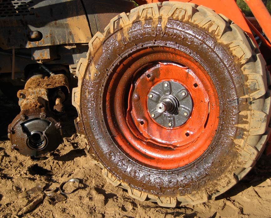

This is what happens when the outer cover on the 4WD front hub fails due to side loads. It's a cast iron or steel part held in place by a ring of bolts, and it carries a large roller bearing to support the outer end of the stub axle. Kubota must have used the same side load calculations for the failed loader mounts that they used to design the outer cover. Unfortunately the replacement cover design hasn't been upgraded and the resulting flex is still breaking mounting bolts and causing them to loosen. It's only a matter of time before the new cover fails in the same manner as the old one.

Most any piece of equipment can be used past it's design capabilities, and the result will be something like you have shown. Sure, the loader's supports could have been made stronger, and they did redesign them accordingly, as you have shown. The wheel hub/axle issue thing, I don't know, but I'd bet it was partially a function of an overloaded loader over time. The loader arm pin/bushing no zerk thing, again, not from light use of the loader. Things break. They break more when used beyond intended use specs.

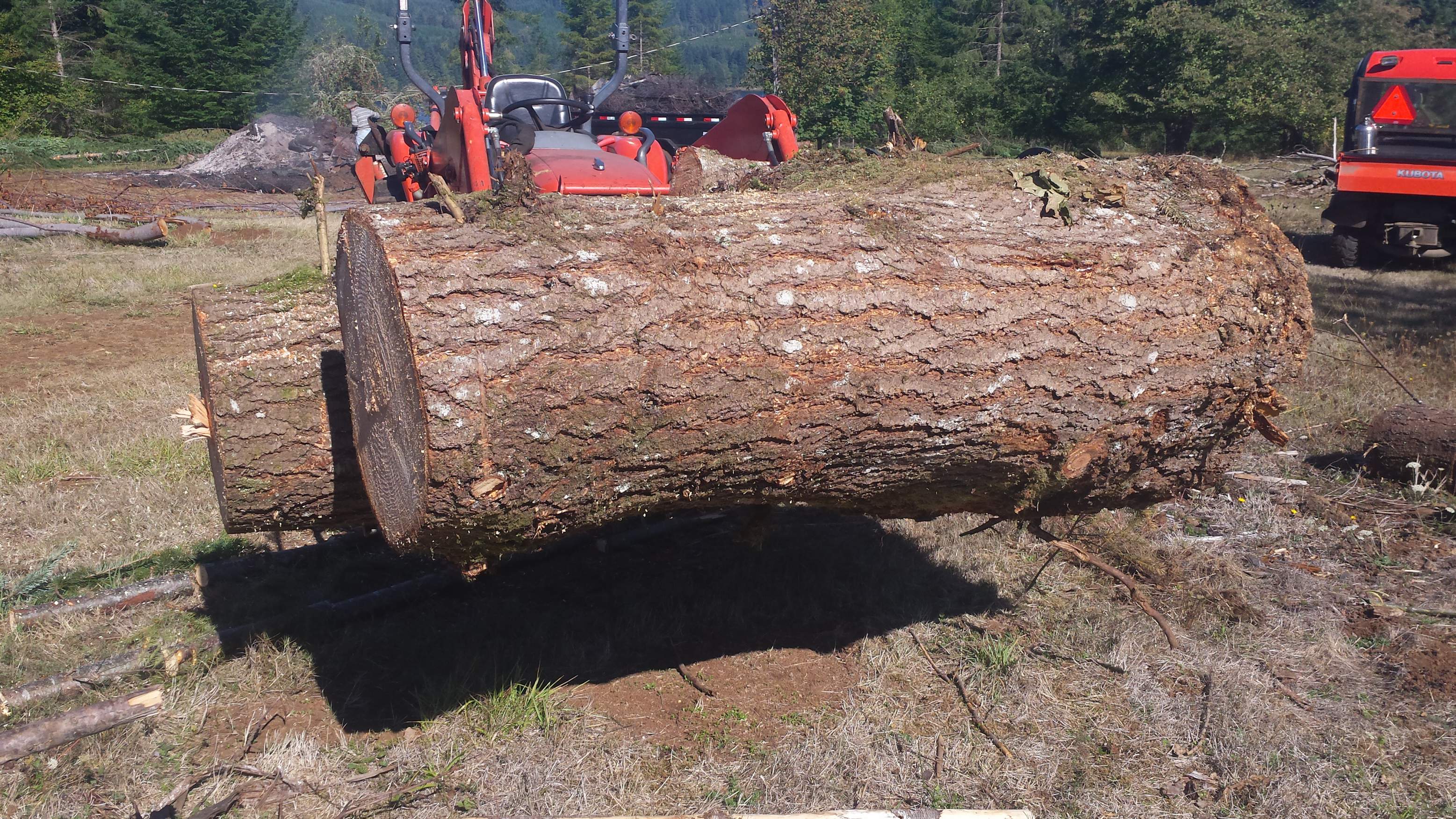

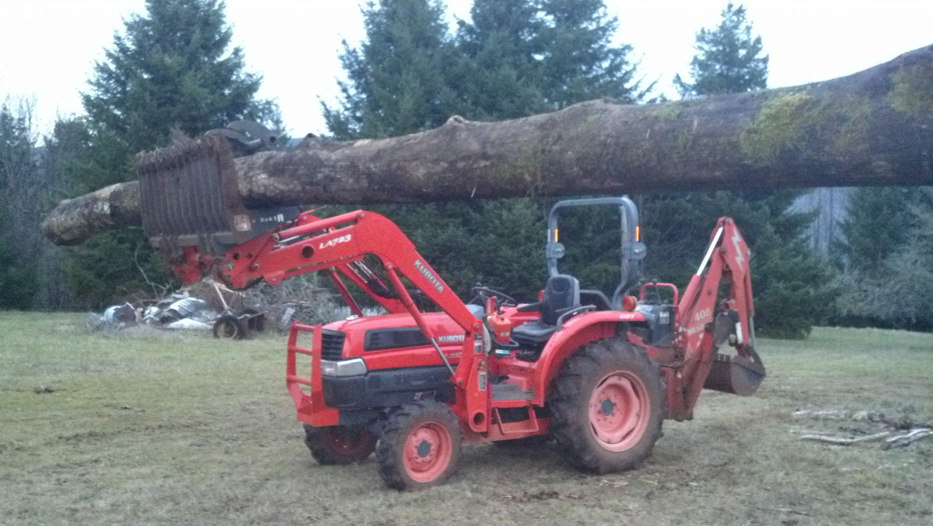

The condition and hours of your tractor are not matching up very good have a 10 year old L3130 GST and not even close on the pin wear and condition and I lift huge logs, rocks and use the tractor to its limits. My BX is the oversized garden tractor, a Grand L series is not.

I'd have to agree with David about this. Looks to me that the problem isn't an oversized hole, it's the undersized, non-OEM pin. That pin - which looks tapered at the end and seems made of plain, unplated iron - looks nothing like the standard Kubota mounting pins, which can be seen in David's photo or this one of my tractor. Also, if you magnify the accompanying image, you'll see grease normally does carry from the central zerk through to the ends of both the upper and lower pins. Somebody's down home fixit work has more to do with this than any engineering blunders.
That tractor was unfortunately abused by someone and RNG ended up with the short end of the deal.
