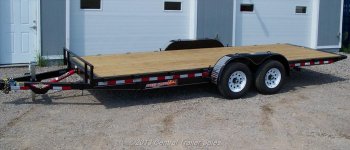

Hi everyone, I am about to purchase a 20' H&H Speedloader EX for my business Titanic Trailer Services. For those of you who own tilt bed trailers, do you find it difficult or slippery when driving a tractor or vehicle up on the deck during the winter?
Also, H&H Speedloader owners, how do you like your trailer?
Thanks,
Ken

If too slippery, you can glue aluminium diamond plates on the wood with bonding sealant. Its pricey but your wooden floor will never rot (if all seams are properly sealed on the top) and aluminium wont puncture as easily as wood.
For the cheap way, span a fishnet over it, as snowchains-the-other-way-around
Oh and i forgot: you can paint epoxy floorpaint on it and spread fine gravel or coarse sand on it.

I have an H & H tilt wood deck equipment trailer. I would do the same as my enclosed trailer, paint it with pickup truck bedliner material. Seems to hold up good.

I have a 20' H&H speedloader. It was the manual tilt MX model which I converted to electric hyd. EX and added a winch. Bought it new in 2006 and use it quite often. In winter I don't have too much problem loading the tractor even with snow on the deck. I put the tractor in 4WD low range and it walks right up. A few times I had ice on the deck and the tractor tires would spin. What I do is drive up in mid range, lower the bucket and back drag the snow / ice off the trailer.
I'd say the best solution would be to keep a couple 5 gallon pails of salt or sand in the pickup bed and use some of that on the trailer deck. I get 5 gallon pails of road sand / salt mix from the DPW. They tell me to go ahead, they won't miss a pail or two from their pile. Plus it's extra weight in the truck for traction.
