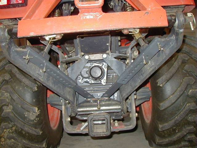

Ordered my parts online, tractorsmart, total inc. shipping $59.60. parts were here when i got home friday. will try to install this weekend and post pics.
   / BX 2200 LIFT ARM ADJUSTERS #43
got them on today, i think i'll like them

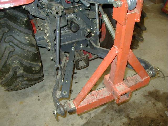

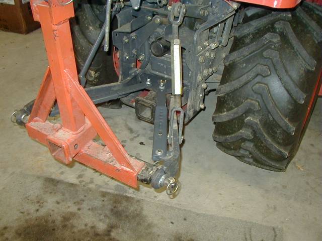

   / BX 2200 LIFT ARM ADJUSTERS #46
last shot, in this pic you can see that i placed a bushing in the end where the bolt goes through, the bolt is tight, yet the arm will pivot on the bolt

   / BX 2200 LIFT ARM ADJUSTERS #47
What size bolts, length and size did you use? I used the same pins that were on the tractor, on both ends of the bar and have a lot of side to side movement.
Thanks
Tom
   / BX 2200 LIFT ARM ADJUSTERS #48
Beautiful job, Milkman! I should have my parts this weekend when I return home from my business travel. I like the idea about the bushings and lock nuts.
   / BX 2200 LIFT ARM ADJUSTERS #49
OK I need some help here. I like the set up that Milkman used with the locking nuts. The size of the holes are different on the tractor plate vs. the bar. I was thinking of drilling out the tractor plate the same size as the bar, what ever that is?? and/ or drilling them both to a common size bolt?? And using a grade 5 or 8 ( higher the number the stronger??) bolt & washer and locking nut. Do you think this will work? Will drilling the hole bigger on the tractor plate weaken that part? Just need a little help here, just a little mechanically challenged (well maybe more then a little) when it comes to this tractor stuff!
Thanks
Tom
   / BX 2200 LIFT ARM ADJUSTERS #50
The difference in the size of the holes in the plate vs the bar is a good reason to use the bushing, I used a 1/2 inch bit to just clean up the hole in the bar, so the bushing would fit in, the bolts are 3/8 grade 5 fine thread bolts. I think they will be sufficient, if there is a problem, i can redo them to something heavier. Thanks for the feedback, keep up the suggestions, I love this site, it has a lot of good ideas.
