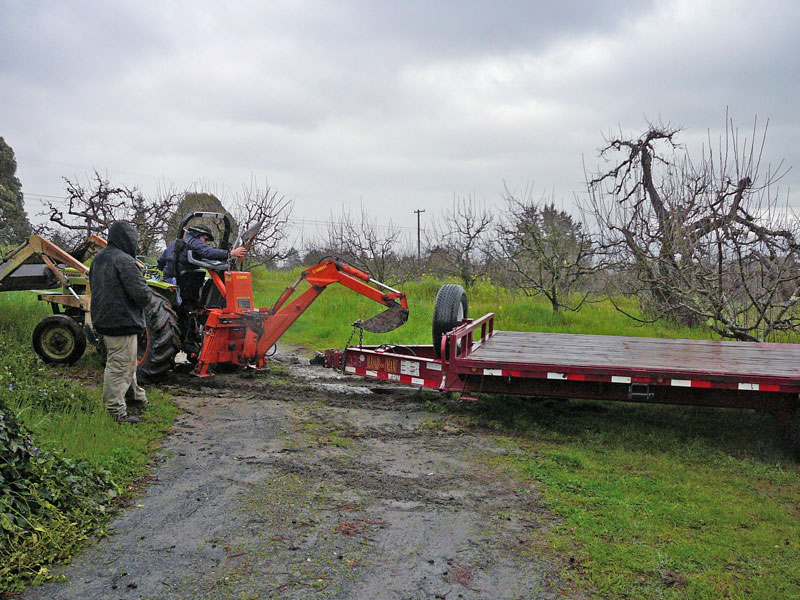

Ok, BTDT with a similar load. Bozo delivered a 300 lb water tank using a 14k equipment trailer. The trailer was so long he couldn't turn it around without sinking his truck in the mud, so I lifted it with the ball on my loader bucket and backed it down into the orchard. Then I discovered that trailer was so heavy I couldn't pull it uphill. Not so much traction as sheer weight. Even after turning the tractor around and getting ALL the weight on the drive wheels I couldn't move the stupid thing. Note the tractor's front tires off the ground.
After a little rasseling with it I figured out the solution, and it is applicable here:
The strongest pull you have available is the backhoe bucket's curl. Push the boat back a little to get its tires out of the pockets they have settled into. Turn the tractor around. (That bend in the bucket shows that your present methods are beyond the tractor's capacity). Put planks in front of all three trailer wheels so the first foot of movement doesn't put it back in its own sinkholes.
Then anchor the tractor to the ground. Roll the loader bucket full forward and dig it in. Set the backhoe feet. Use the backhoe's curl to move the boat one foot. Move the tractor forward, repeat. Keep planks under the trailer wheels, including the nosewheel, so they roll instead of plow.
It may not look elegant to pull it a foot at a time, but this is the proper application of the force you have available, without abusing your tractor.
