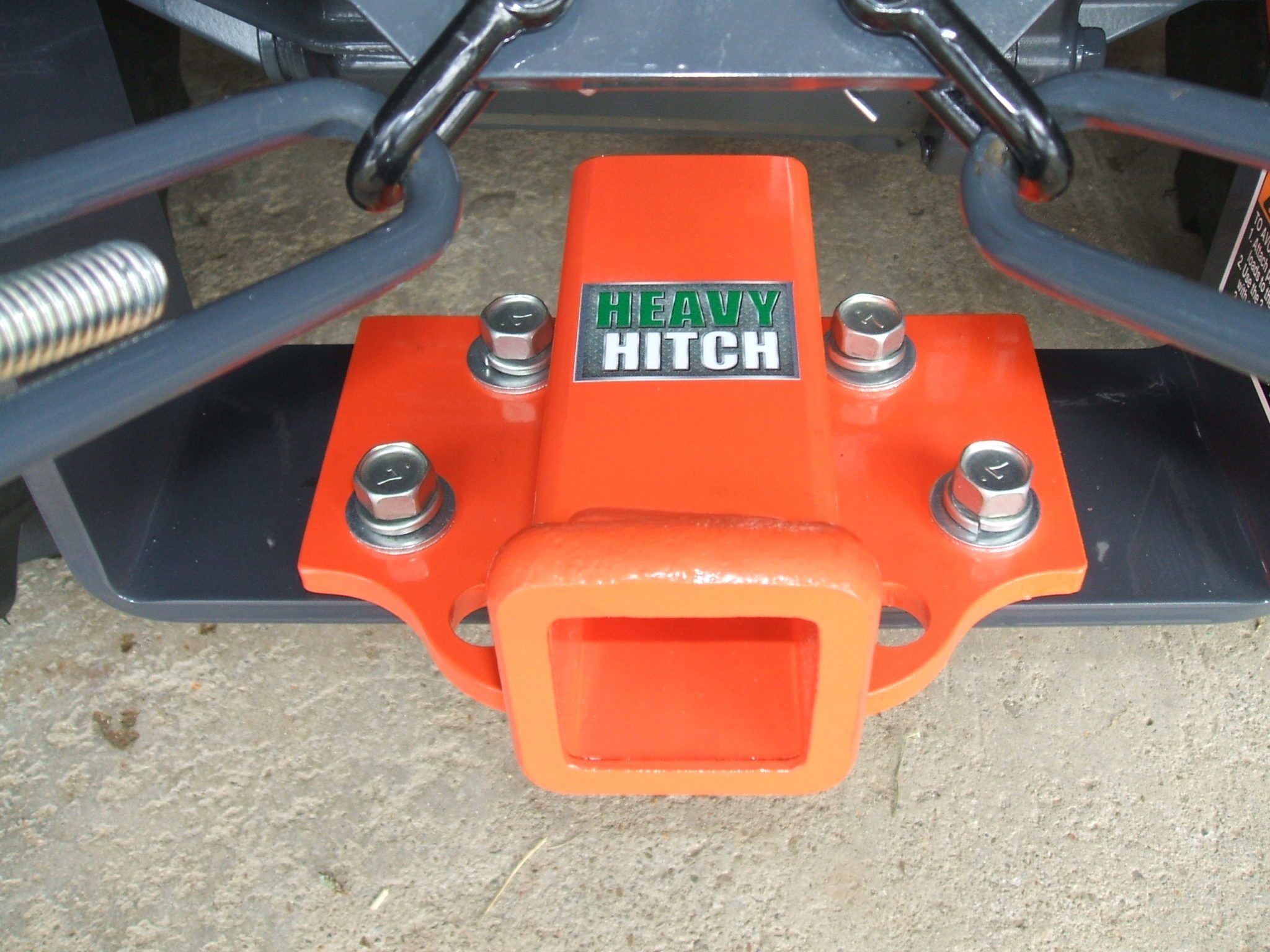

Hey Sparky see that hitch below the 3 point on mine with the 4 bolts holding it on, they call it a "drawbar" which is kind of a joke its not a draw bar just a hole for attaching tow behind implements. Yesterday I ordered a 2 inch receiver hitch adapter from Heavy Hitch for mine so I could extend the hitch out a foot or so, the factory hitch is tucked way up inside the rear wheels so I needed to extend it for my tow behind spreader, for tighter turns. Just saying that's something to think about potentially. My old B2920 had a real draw bar that could be adjusted in/out.

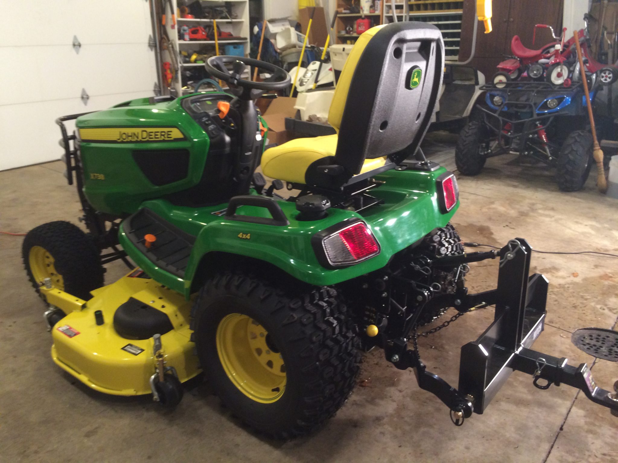

I also considered a 3 point hitch, available priced from about $85 to $300. This one has a blade for attaching suitcase weights. The problem I had with these is it actually positioned the spreader too far to the rear so that I wouldn't reach the on/off lever so I went for the cheaper one above.
