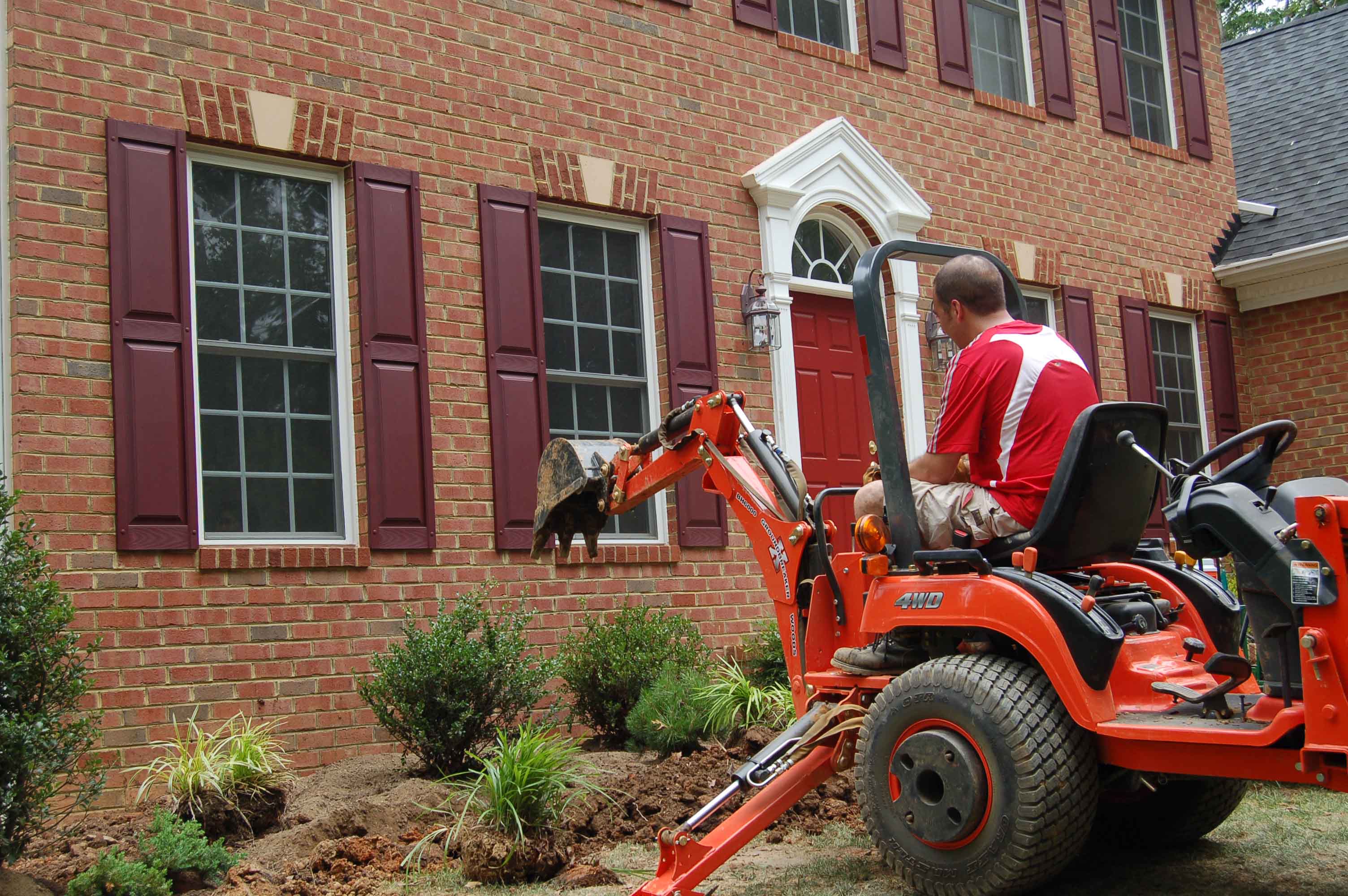

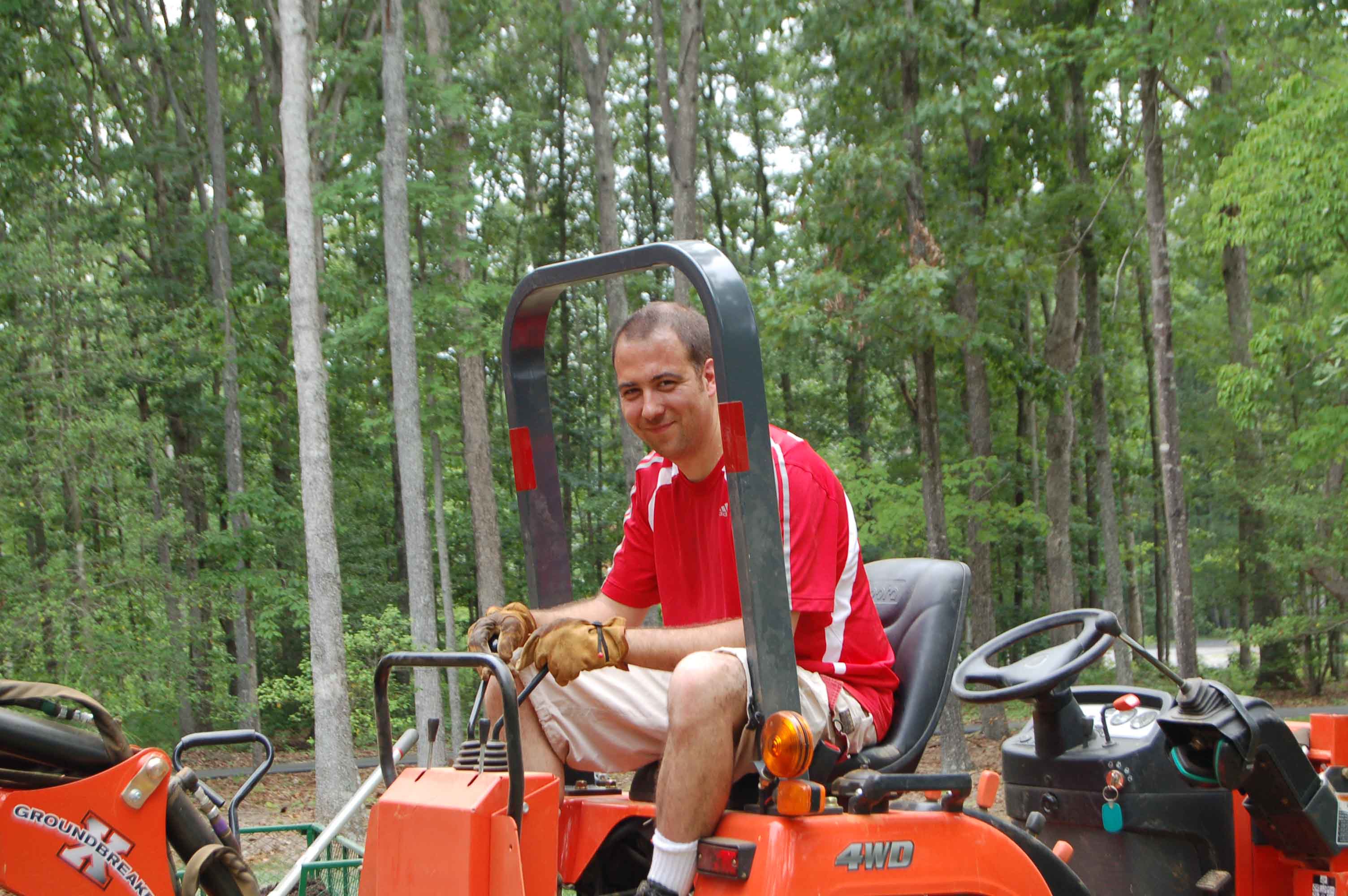

LBrown59 said:
Doesn't it strike you as a little odd to put 2 different ROPS on the 2 tractors if there is no purpose for it?
Never once said there was no purpose for it. The smaller ROPS isn't exactly roomy. Thing is, it is a little in front of you when sitting in the rotated seat, so it really isn't in your way. When you straighten your back, you naturally lean back, so you end up staring at the ROPS instead of hitting your head on it.
The statement was that I never found it to be a constraint and I never clunked my head on it...a statement I stand by. That isn't to say it wouldn't be nice to have a few more inches. And it certainly hasn't bothered me enough to shell out $$$ to fix.
Pics are from the beginning of my marathon landscaping project last June. Note the ear protection hanging on the FEL stick...I use it almost 100% of the time, but my wife was taking pictures and I wanted to look cool (er).
